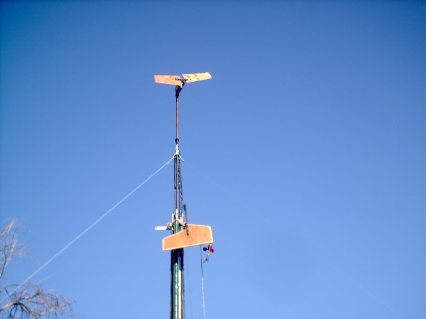

 here is the mount I use for the ametek motors,fits on 1" pipe with smaller hole in the top for wires to run down through. go to randysworkshop to get a better look at them.
« Last Edit: February 08, 2007, 05:09:45 PM by kenputer »
luckeydog
  • Posts: 198
    • Colorado Wind Power
Re: Assembling my Ametek DC Motor Mill
« Reply #4 on: February 08, 2007, 06:34:29 PM »
randy pivot is nice with one exception.
the tail boom has a 1/2" pipe thread.
threads have a tendency to break.
if you use this type of pivot keep the tail light
or this will happen to you as it did me.
the tail boom broke off and came around and hit the spinning blades
and took them out also.

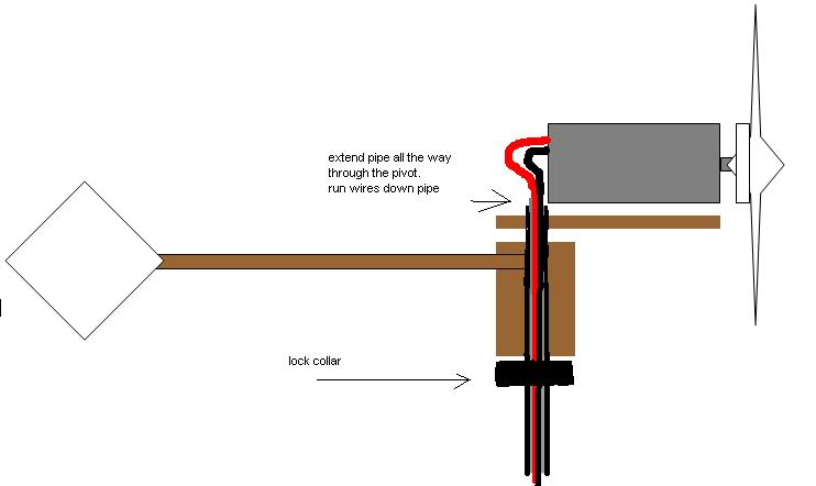

I think i would extend the pipe all the way through and install a lock collar or some type of berring
here is your drawing  modified

Luckeydog (or anyone),  I have a stupid question.  How do bearings work there?  I'm guessing that I would find a bearing set who's inner-diamter is the same as my mounting pipe.  Then I would have to bore the hole in the wood to be the same size as the Outer-diameter of the bearing ring?  Is that right?
I can see how that would help with horizontal-rotational movement.  But, wouldn't most of the weight still be on the lock collar on the bottom, which would be the source of the most friction?
I'm totally confused about this part.  Perhaps unnecessarily.  I understand how bearings work.  I just don't know how to apply them practically into a project.  I don't know how many times I've stared at the Dans' mill pictures and tried to figure out what the heck I was looking at bearings-wise.  For example, I can find bearings all over Dexter Hubs' website - but cannot find any place to buy a "spindle."   Anywho - that's another post.
 A nice smooth surface and some grease and the
friction is neglible...the leverage of the tail
in a 5mph wind should easily overcome that small
amount of friction...if the tail is big enough
and a long enough tail boom...that is....
