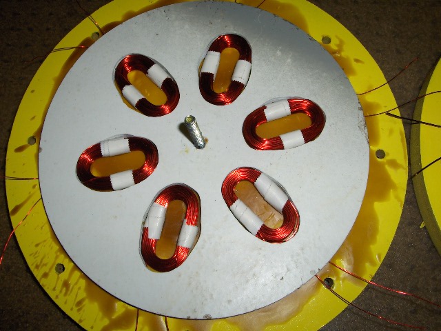

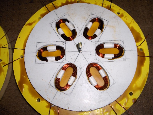

This may be the first dual rotor disc alt out of 4 diferant sizes ready for the star VS "Jerry Phase" alts test?
This one is 5.125" od. It uses 8 each 1"X1/2"X .25" NEOs. 8 per disc. ^ coils 3 phase.
I'm getting ready to cast 2 stators. One has coils wound with 18 gage at 40 turns each and the other stator has coils wound with 24 gage with 150 turns each coil.
The 24 ga. is the "Jerry Phased" stator.
Here are a few picture prier to puring the reson. The stator are made from fiberglass sheet. They should be about 5/6" thick after compressing.

I was able to give star a few turns extra. The idea here is the star with wire 4 time the circlar mils would have 1/4th the turns as :Jerry phase". Because this alt is an 8-6 combo. Wich means in star there are 4 coils in sires. One coil of "Jerry Phase" equals all 4 of the star coils in turns count.
However it has been sugjested the star needs a handicap to make up for its loses, so I was able to do 40 turns rather then the 37.5 or 1/4th the 150 turns of "Jerry Phased".
The yellow discs are left over rounds of 3/4" MDF from speaker cabnets we make.
MDF is much smoother then plywood. I primered then painted it with glose enamel. Then I melted toilet bowl wax on it as a relief agent. There is a top piece that bolts on.

Thats Sweet man. I am wondering how fast would you have to spin the 40 turn coils one. Is the airgap going to be small enough for the thinkness of those magnets.
If I do my math right, 0.25 + 0.25 (dual rotor) = 0.5" so the airgap should not be much bigger than that. Maybe its a picture magnifying thing, I see the coils very thick.
Correct me if I am Wrong please

With those magnet spacings and coil sizes you should have a waveform that is well removed from a sine wave. I suspect it will favour your Jerry connection.
Keep up the good work Jerry, I am particularly interested in looking at the versions of Hugh's baby alternator where I have a good idea what it will do in its present form.

  Jerry.. something I've been thinking about for
a couple of years.....
 That white material that you have placed the
coils in are marked pie-shaped ....a person could
possibly mark into pie-shaped divisions....each
coil could be a replacable unit....
  ....Maybe just a dumb idea that others have
thought of an rejected as a bad idea ?
        (  :>) Norm.

I've rechecked the stator/coil thickness. Its 1/4" thick. I'm thinking maybe the gap between the magnets to be 3/8".
One nice thing about the 150 turn coils, when useing a fullwave bridge rectifier per coil, there is no importance on conection to coils in regards to start or end coil conection. It don't matter.
I got to thinking about the turns ratio between these 2 systems. Jerry Phased 150 turns VS star at 37.5 turns.
Since I've used 40 turns per star coil, star ended up with 10 more turns total.
« Last Edit: February 10, 2007, 11:41:06 AM by Jerry »

not a dumb idea, I'm getting close to getting my coils mounted for my first windmill, and I've been thinking the same thing.
I would even go so far as to have the slices be made so that on the outside and inside diameter edges would overlap the pie slice next to it so they would get screwed / bolted together.
The section of the pie where the coils are almost touching would have to be straight though.
