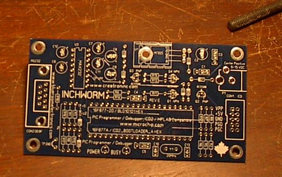

I am going to build this
Its called inchworm
i got it from
http://www.blueroomelectronics.com/inchworm.htm
It is a PIC programmer , In Circuit Debugger (ICD)
it is a complete circuit board all ready to be populated with parts so a little soldering is needed, although one could buy the whole board complete for very little cash.
some of the terms used need some explaining so dont be shy.i will try to answer all questions to the best of my ability.

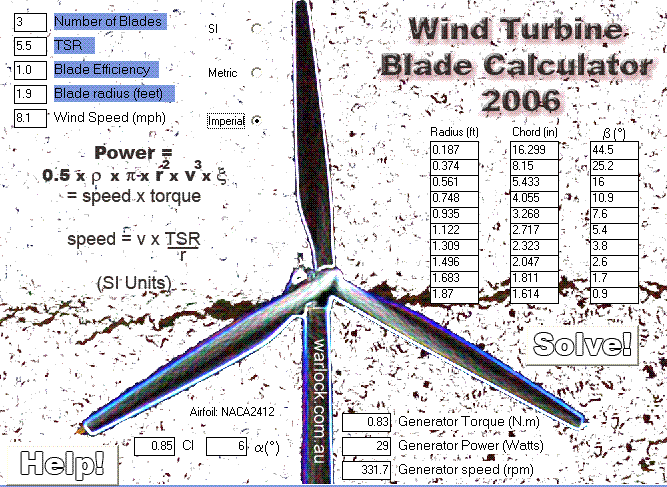

« Reply #6 on: February 12, 2007, 10:24:21 PM »
the last time i took the mini genII out i briefly got slightly above the power output in the photo.
i calculated that i got 31 watts in a gust of wind that was reading seven MPH and just touched eight, for a second.
the blades are 1.875 feet radius so 1.9 is close as i can get the program to display.
wind speed also as close as i can get it .
anyway i have to prove it to myself that the blade efficiency is as good as i think it is..
thats where the data logger comes in.

i ordered a kit last night , even though i have a bare board , because it would have taken a long time to order all the parts , from somewhere else.
