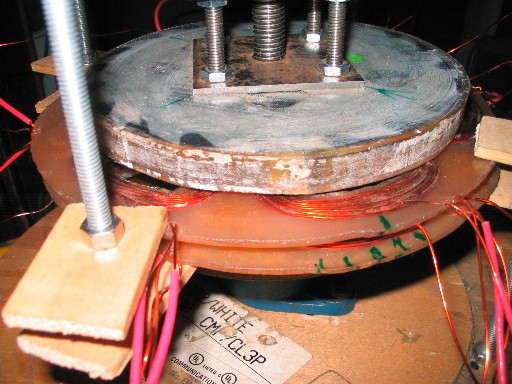

I got around to adding a third coil  to the  jig  .I offset the coils by 3 and 6 degrees .Looks like there's a slight difference in the width of the rise from zero ( stacked in line series ) . Am  finishing  out the stator at three degrees center coil and 6 degree outside sacrificing some peck to peck voltage for duration  . Pdf links for 0,3,6,7, degrees .

 The measurements were made on three 25 turn coils offset in series.Somewhat simular to
a single coil with wide legs at 75 turns. Mags are 1/2 X 1.5 x 1/2
