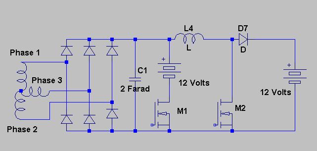

When winds are low ,M1 is off , M2 is is boosting into the right 12V battery
when winds are med , M1 is on , M2 is off , and the left battery is charging
When winds are high M1 is on , M2 is off and any current that is excess will flow into the right battery also , minus a diode drop .
huh huh
what do ya think
 should work
M1 is also be pwm controlled .
do ya think i need a third Fet under the righmost batt
Cap is optional. But stores power in low winds , for boosting.

Should work. I can't see why you want 2 batteries but fine if you do.
I suspect a reasonable sized low esr electroytic will work better than that 2 Fard thing which will not be a true capacitor.
« Last Edit: February 19, 2007, 02:47:59 AM by Flux »

A single battery version.
M1 is optional , but i would use it to let the blades reach their optimum tsr.
this is assuming the alt is more powerful than the blades, ie the alt could stall the blades in all but a very strong wind.
by varying the pulse width into M1 the current into the battery is adjustable .
so in low winds M1 would be full on ,M2 would be pulsing current into the batt
in med and high winds ,the pulse width into  M1 could be varied to let the blades reach their tsr,and M2 would be off .
« Last Edit: February 19, 2007, 08:00:25 AM by willib »
Re: When winds are low
« Reply #3 on: February 19, 2007, 08:59:31 AM »
One or two points I don't like. The basic boost converter is fine, you can control its pwm to track the alternator load to the prop during boost.
If you make absolutely certain M1 can't operate while the boost is in operation it may be ok, otherwise the boost converter will produce monster voltage spikes when M1 is open.
I suspect it will be ok on a small scale but I wouldn't want to do it with a large machine. Either use boost in low winds and accept the match in high winds without M1 or convert M1 to a true buck converter for control of load matching and wind the alternator not to need the boost.
In theory you could use a buck/boost converter but that is not without its problems with polarity inversion.
You are on the right lines, just prove one stage at a time.

Yeah, and not to mention that those high voltage spikes could fry M2. Watchout

Sounds like you're about to discover the SEPIC converter.

I wonder if these spikes could be a problem for the supercap or the rectifiers also.  It might be a good idea to parallel the supercap (or electrolytic if you substitute one) with a polyester or tantalum to grab the high frequency stuff so it doesn't punch holes in the dielectric of the big cap.

I dont know much about the cap but the rectifier are not as sensitive as the MOSFETS. You can do the following:
The diode across the coil is to short any reverse voltages caused by sudden current changes. That should take care of that. The Transient Voltage suppressor will leak current into the gate of the MOSFET whenever the voltage exceeds the specified voltage of the device and with this current and voltage in the gate the MOSFET will conduct shorting the output thus lowering the voltage and killing the spike.
The value for the suppressor should be chosen depending on the max voltage charasteristic of your MOSFET. If your MOSFET will only take 100v to fail choose a value for the transient voltage suppressor a bit lower than that, usually 30% lower will be safe. Now everything beyond that MOSFET will be safe from high voltages.
Hope it helps

That diode over the coil is destroying the working of the circuit.
The reverse voltages are used to boost the voltage.
And the other 2 diodes is your drawing are useless to because there is never going to flow current trough them like that.

Ok, you are wrong.
First we do NOT need the negative side of the spikes in that part of the circuit. They will cause damage to your MOSFTET. In this case since its 3 phase it should not be very necessary.
As for the other two diodes. Transiento voltage supressors are designed to work backwards. They will not conduct electricity untill you reach the reverse voltage rating that I was speaking about. This diode will conduct normally in forward as any other diode. Knowing that I added the other diode after the transient voltage suppressor connected to the gate just in case the first diode connected across the coil fails to kill the negative voltage, it wont go through the second NTE125.
This is a proved design that I use for the same purpose in power inverters. The same concept applies. I copied this design from Trace power inverter plans. Its bets to study electronics from what other people havo done. With a scope you can see how it works.

I forgot to mention, if you need the negative side of the spikes for the circuit to work for any odd reason unknown to me you can just remove the diode across the coil. the rest of the circuit will work the same. I just placed that diode there for extra security against reverse voltages across the FETS. That technique is often used with relays.

I've moved the two 1 farad caps to the boost side , because, during bench testing , if i let the boost continue till tha caps were spent , the blades would have to start up in a stall condition.
 till tha caps charged up.
the caps seem happier where they are now :)
they can take any extra boost and feed the battery during a lul.
