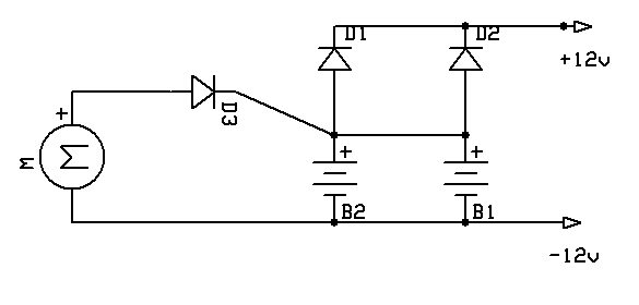

I bought some PVC Pipe, Caps and Machine Screws so I could make my own.  Thank you so much for the idea!
My mill currently only puts out 12v+ on moderately windy days.  But it does put out 6V+ on a pretty consistant basis.
My idea is to make two 6V packs to charge with my mill by hooking them up in parallel.  But is it possible to make a 12V bus bar by hooking the packs up, in series, maybe using some diodes?
I hope I explained that correctly!  I'll upload a schematic if I can find a good program for drawing them!

Here's my crazy circuit.  Thanks ExpressPCB.com!
The big M on the left side is my Motor (aka Genny)
« Last Edit: March 18, 2007, 08:22:45 AM by valterra »

I'm seeing now that I've just drawn another parallel circuit.  The 12VDC outs would be 6VDC (minus whatever diode voltage drop).  But still, is there some way to do what I'm talking about?

Re: Bottle caps for Ni-Cad my 6volt batt paks
« Reply #39 on: March 19, 2007, 06:56:37 AM »
I don't believe anyone has come up with a way to do what you are thinking.
(except with a 4 or 8 wire stepper motor)
They can be charged at 6V and used at 12V, but not at the same time.
It takes a DPDT switch.  One way is Charge, the other way is Use.
It unloads the windmill.  Could be a problem.
« Last Edit: March 19, 2007, 06:56:37 AM by ghurd »

Hey Glen,
To charge at 6V and use at 12V, could he use 2 bridge rectifiers for the genny output, one going to the first 6V string and second to second 6V string? Keep the 6volt strings isolated from each other that way for charging, and if using at 12V it would be an equal load.
Is that what's he's wanting? Sorry late and I'm droggy.
