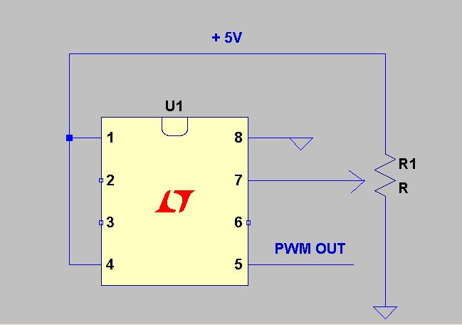

this is all thats needed for the 12F683 to get pwm
it has a built in oscillator , so ya dont need one of them.

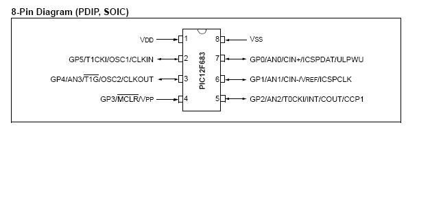

this is tha actual pinout of the 12F683
the varible resistor is connected between 5V and ground
The wiper on the ' pot' connects to the analog input of the 12F683.
the Varible PWM goes from full off to full on in 1024 steps, at 20Khz ,
but it can go faster ,with fewer steps .

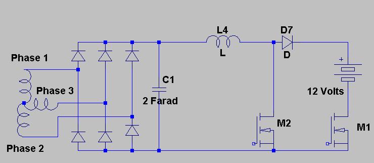

this is a possible use for the varible pwm
a boost circuit , but with only one pwm channel just connect battery minus to ground
the pwm connects to the gate of the fet M2

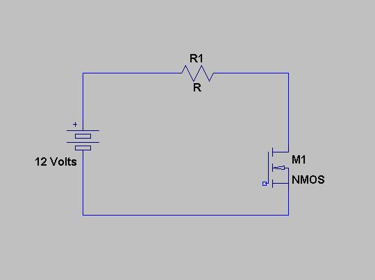

this is a circuit that i've used a lot.
the resistor is a small section of stainless wire to cut foam.
the resistor could also be a motor , such as a portable drill

Right now I'm just trying to nail down the best frequency for boost, using the inductor that i have.
i've been able to raise the boost frequency to 65.8Khz with 256 steps ,
next i'm going to try 7 bits resolution and get the boost frequency up to around 156Khz, or a little less .
« Last Edit: March 10, 2007, 06:29:28 PM by willib »

How are driving the gate on fet M1?  Are you keeping it in sync with fet M2?
« Last Edit: March 10, 2007, 07:22:41 PM by Boondocker »

I'm not using M1 at the moment , i have the battery minus connected to ground
« Last Edit: March 10, 2007, 09:06:06 PM by willib »

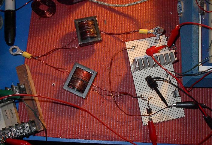

Here is the inductor i'm using .
it used to be all four coils in parallel.
but i thought i would split it up and use two Fets for boost , now i just have to figure out how to get the Fets to alternate, or at least not fire at the same time.
i could just delay one by a couple hundred nano seconds by putting the signal through some TTL chips
have not decided yet.
i purchased some fet drivers that produce a very nice signal and drive the fet gate at 12Volts.
« Last Edit: March 11, 2007, 07:04:06 PM by willib »

Re: New pic programmer DONE !
« Reply #19 on: March 12, 2007, 07:54:24 PM »
I think it works , i have sent the origional signal through a few inverters and used the inverting output on the TC4428A ( fet driver), and got 600mA output at 127 rpm at 12.38 volts , this battery is badly in need of a charge , it is a lead acid auto battery .
i have had the boost up to about 2.4A at the point where it woould normally just be starting to charge ( 220 RPM).
 i really have a lot more testing to do , i didnt get much done yet tonight.
over the weekend i charged almost every NiMH battery that i own
« Last Edit: March 12, 2007, 07:54:24 PM by willib »

« Reply #21 on: March 13, 2007, 09:44:28 PM »
Bruce are you still looking for a way to charge them (the NiCd battery) packs?
just an update :
tonight i set two different PICs to different frequencies , i might try setting them both to the same frequency , the odds of them both being exactly triggering at the same time is small .
when i use the same trigger source for both FETs ,(and the delay) the output is barely more than with one. I think this is because when one fires the other is trying to fire too close to the allready depleated voltage from the first .
or maybe  i should use the two 1 Farad caps as a buffer between the alt and the boost like in the diagram.
i dont know , first i'll try setting them both to the same pwm frequency , use two different clock sources , and see what happens
« Last Edit: March 13, 2007, 09:44:28 PM by willib »
