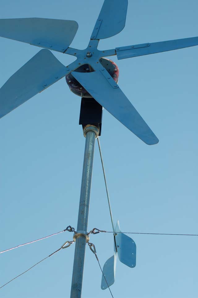

I actually have one in the air right now. it  is a 7 foot 3 blade. I built a dual rotor axial flux for it. I don't get a lot of wind in Florida, but I have seen 20 amps at 24 volts out of it. I also have his 5 blade 5 foot as well. I flew it for about a year. They start up in very low wind and I see 1 to 5 amps all the time. I use a boost converter to increase the voltage in low wind conditions. Today we had 15 mph winds and I saw 60 to 100 watts.
I really like them so far. no complaints. I am thinking about making my own wooden blade just to see if I can do it. It would be interesting to see if it would do better than what I am using now.
