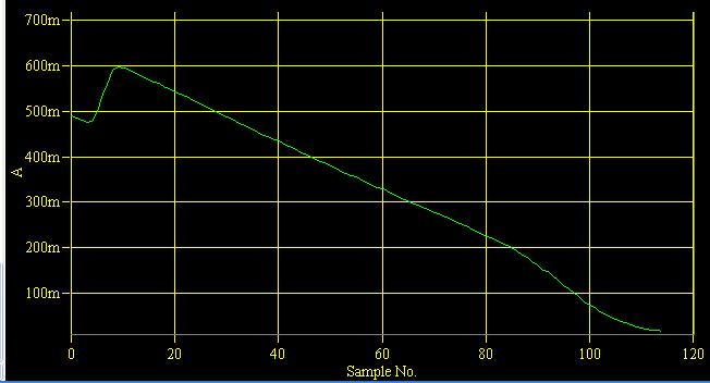

i have been using a flywheel on an excercise bike lately
i have  two 1 farad caps connected in parallel for two Farads total capacitance
they are connected to the alt output between the load battery and the alt.
how would one rate the power from a flywheel?
what i do is pedal fast and let the flywheel charge the batts for over a minute.
The starting current into two NiMH batts (in series at 2.73V rest voltage)is 597 mA and after a minute it is still above 250 mA
i have used a 12V taillight to limit the current  but later i will try PWM to adjust the current into the batteries , {less loss from lighting/heating the bulb)
in the graph above the current was sampled in one second intervals .
i clicked 'start ' too late so i had to pedal a bit more , hence the rise in current at the beginning
it starts to decline at 10 seconds into the sample session.
and lasts for 114 seconds
i think by 100 seconds the flywheel had stopped or was spinning very slowly at that point, and the caps were discharging the last of their power into the batteries.

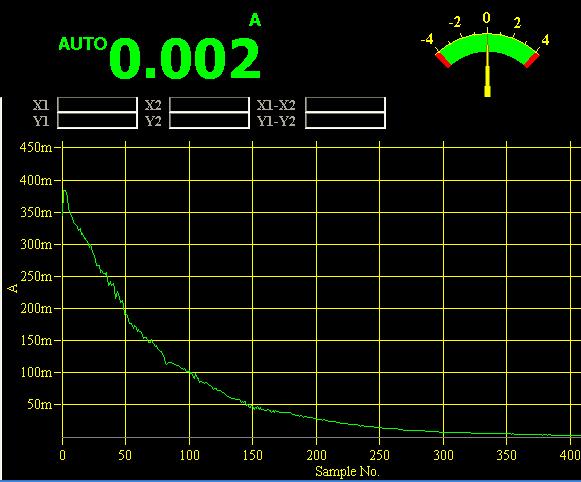

this next one is with the PWM set to a low value of on time vs. off time
hence the low starting current.
the rotors stopped spinning around 100 seconds the rest of the curve is the caps discharging into the batteries.
you can see the batteries are still taking in 2mA after 400 seconds , thats over six minutes

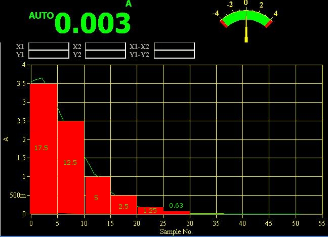

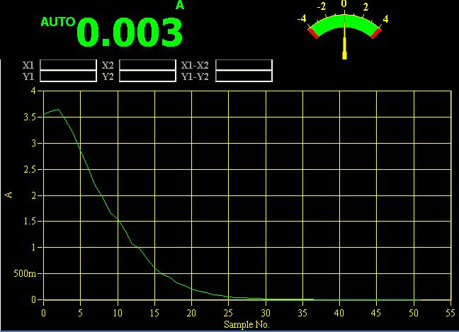

This one is with the pwm almost full on
It starts out with the current a little more than 3.5 Amps
at that rate of charge the Flywheel and caps  only lasted about 30 seconds
i thought it was interesting

teh area underneath the curve should be the amps/seconds. It would be nice to calculate it to know the amount of energy that the flywheel has at certain RPM. Assuming the alternator and diodes loss.

this is part of the data file i have to work with , there are 115 lines in the whole data file.
each sample is at one second intervals
i have isolated the decimal with a pascal program, 490, 485 ect..
if i could add them up , all i would have to do is divide them by 1000 before dividing them by 115 to get Amps per second..
but i am having trouble
it all comes down to how the numbers are represented in the program ,
490 is actually three seperate integers 4 , 9, and 0
i cant find a procedure or function combine 4 , 9 ,0  to represent four hundred ninety...
09:09:44 AM        0.490A
09:09:45 AM        0.485A
09:09:46 AM        0.480A
09:09:47 AM        0.476A
09:09:48 AM        0.477A
09:09:49 AM        0.499A
09:09:50 AM        0.538A
09:09:51 AM        0.559A
09:09:52 AM        0.590A
09:09:53 AM        0.597A
09:09:54 AM        0.595A
09:09:55 AM        0.591A
09:09:56 AM        0.585A
09:09:57 AM        0.580A
so thats where i am at the moment , i could go 4 times 10^2 + 9 times 10^1 + 0 times 10^0
wow that would work!!
« Last Edit: March 20, 2007, 08:09:12 PM by willib »

Ok, I got almost the same results. Check this out:
17.5 + 12.5 + 5 + 2.5 + 1.25 + 0.63 = 39.38 a/s
39.38(amps per second)/60 = 0.66 a/m
0.66(amps per minute)/60 = 0.0109Ah (amps hour)
So you got there a nice battery.
« Last Edit: March 21, 2007, 05:59:27 PM by s4w2099 »
