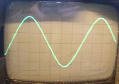

Following my last rather poor start at testing, I managed to rig up a motor to drive the rotor assembly so that I could do something a little more accurate.  Spinning the thing by hand and trying to count the turns just wasn't the way to go!
A small DC motor run from a Lab power pack gives me adjustable speeds, and seems to be quite repeatable; if I dial up the same voltage I get around about the same RPM.
Here is a picture of the 'scope with a 50 turn coil attached.
This shows about 3.5v at the top of the peak, and the time-base gave about 300 rpm.
(1 volt per division, and 5ms per div)
I get the feeling that this isn't enough voltage for what I want to do, and that I will need some more turns on the coils.  I'm planning on 4 ft diameter blades on this, and from what I can work out, it will be bearly cutting in untill 300rpm to charge 12v.

If that is 1 volt/division I make it 2.5v not 3.5v peak.
If you have 9 coils, one phase will give 7.5v peak. Star connected will give you 12.75 so as you say that is cut in at 12v at 300 rpm.
That seems fine to me for a 4 ft prop but I am not sure what you are using.
Hugh's 4ft prop would be fine for that cut in speed. If you want something slower then you will need more turns.

Thanks Flux, one of these days I will check my typing,  My excuse is that I was at home on dial-up and so time was precious!
I don't know what speed to expect from a prop, but 300 rpm just sounds a little more exciting than I really wanted.  If that is what they are supposed to spin at, then perhaps it will be ok.

Hugh's 4 ft prop cuts in about 300 rpm and when sensibly loaded with a matching alternator it is very quiet and peaceful. The same speed on a poor pvc rotor may be frantic and noisy.
Air X is bigger than that and is not even near cut in at 300 rpm. Blades vary so much that it is difficult to give general advice. Build decent blades and 300 rpm will be fine. Much slower will seriously restrict your power output.
