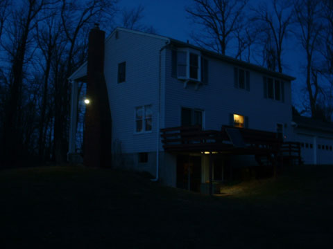

Another 12v/13w CFL added, doubling the load on my battery. I've turned the light timer down from "dusk-to-dawn" to "8 hrs". I was getting a little concerned after 3 consecutive sunless days, that I might be abusing my battery. The voltage never got so low that the controller shut off the lights, but I am used to seeing the battery voltage "floating" every night when I get home from work. That hasn't happened since I added the extra lamp. I need to get off my duff and get the 3rd solar panel added. There just hasn't been any extra cash these last few weeks for materials. I know the system would benefit from more storage as well, but I'm torn between buying another identical "marine" battery ($70), or just saving my money and buying some "real" deep-cycles. Decisions, decisions...
 Ever get the feeling you are being stalked...?
Cheers!
Brian

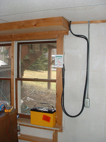

Looks good. What size is your battery and current panels? My setup could never run the light for that long I don't think. There is never enough sun in the day to replace what it used.

Well, I'm really not sure of the panel ratings. I'm guessing around 50w each. The battery is a WalMart "Everstart deep cycle marine" rated at 875 marine cranking amps/675 cold cranking amps, no amp hour rating. I'm guessing it's around 80ah..? maybe less, I don't know.

First there is a difference between a Wal-mart marine starting battery and a Walmart DEEP CYCLE. The deep cycle is a black case (not yellow) and 12V 115 amp hrs, costs $55 here when I buy them new plus core charge (take back a scrap yard junk battery! save the $7)
It should be fairly easy to see what you need. 2 13watt lights = 26watts per hour. So 10hrs is 260watts. Divide by 12V that is 21.7amps from the battery per night.
To see what you need from panels divide 260watts by hours of solar insololation for your place per day. Say for me 5 hrs. So 260watts / 5 = 52watts of panels to run a 10 hour night with 26watts of light.
So, a 115amp battery should run 10hrs of lights for about 5.29 days before totally dead with no charging. You should get some charging even on poor cloudy days but not as much as a good day. So you need more solar so a good day can catch up after the bad days.
Being a break even is about 52watts then you should probably have about 75watts available for losses and catch up times.
I think that's about how it would work for me here, you'll need to figure yours out yourself with your numbers.

I did not say you were wrong about your battery, I know exactly what battery you have.
I was pointing out a better battery is also a cheaper battery if you plan to buy another one. You might want to save a few dollars and get a better product for the job it's intended for. I know the deepcycle battery I mentioned with the black case is 115amphrs and costs less (here), works well. We don't now what the amphours are on the yellow case battery though and it costs more, at least at the Walmarts I been too.
I do know my Yellow battery was not as good as my black battery, which is why I don't buy the yellow for this type of use myself. I can't test the Yellow because it's wore out now, several years old, one of the oldest I had that was bought new. Mostly I used it as a starting battery and such, not wind or solar.
You are the one that is not sure on a few things, and I just offer help from experence. Since I don't know the exact numbers that would apply to you there I gave you the figures for me here, so you fill in your own numbers and figure it the same way to see what you need for your area.
You said, " I'm torn between buying another identical "marine" battery ($70), or just saving my money and buying some "real" deep-cycles."
 The black case one IS a real deep-cycle and it costs $55 here plus tax.
Also I mentioned to be nice, if you don't have a dead battery to take back they charge the core charge, here that is $7, buy any junk battery at a scrap yard for $1-$2 to take in to save the core charge. May not be worth your time if only buying one battery, if buying several batteries it might save you $10 or more.
You said "The battery is a WalMart "Everstart deep cycle marine" rated at 875 marine cranking amps/675 cold cranking amps, no amp hour rating. I'm guessing it's around 80ah..? maybe less, I don't know. "
You are probably right or close, so for less money you can get maybe 35amps more? And the black case deepcycle should last longer also. I figured it up for you that the black case battery should run your 26watts for 5.3 days with no charging. Actaully it will probably run longer since battery amps are normally figured at a 20 hour rate. So if you run the battery dead over 20 hours you should get 115amps from it. The faster you drain it the less amps you will get and the slower you drain it the more amps you should get. So a 115 amp battery should provide 5.75amps for 20hrs steady. If you run 20amps an hour you will get much less than 115 amps total, and at 2amps per hour you should get allot more total amps. Heck that one 115amp battery might run your 26watts for 10days from a full charge to totaly dead in your use? About 8 hours on at 2amps, 16 hours resting time?
You also said, "I'm really not sure of the panel ratings. I'm guessing around 50w each." also "I need to get off my duff and get the 3rd solar panel added."
So you have 2 panels, maybe 50watts each, so you should have 100watts? I don't know what your average sun is for charging with 100 watts. But I think I figured it up for you that about 5hours solar insololation should cover 10hours a night with 52watts of panels? Then you need some extra wattage to cover battery loses, and after a day or more of little sun then you need to catch back up agian when the sun does shine, so that takes extra wattage above your nightly use. So my geuss based on 5hours is about 75watts should be good for 10hrs of nightlight. If you have about 100watts as you seem to think, then you should have plenty of panels (based on 5hours) so it would look like the weak point is your battery perhaps. If you only have 1hour insolation then the weak part may be not enough panels, you'll need to look up the solar insolation for your area to see how many hours you should have there.
If a good sunny day or 2 charges up your battery full after a few cloudy days, then you probably have enough solar, adding more won't help since once the battery is full no more can be stored and the panels are just shut off by the controller. Of course if your battery is never reaching full charge then more solar would help.

 I have been googling this battery (MAXX-29)quite a bit, and have found some second-hand info on it, that seems somewhat reliable. I found 2 references to it on boards similar to this, one poster stated that it was a 125 AH battery, and another mentioned 120 AH. I don't think our local WalMart had any of the batteries you're talking about, but I'll check the next time I'm there. But I'm sure I would have seen it if they had it, I spent a lot of time checking them all out.
 I've pretty much made up my mind to get some T-105's when the next bonus check comes out, probably 2 to start with, and maybe another 2 by mid-summer when I hope to be converted over to a 24 volt system, we'll see how that works out, lol...

 They are deepcycle but do say Marine on them also, but they are not the daul purpose starting batteries like the yellow case ones. I don't know for sure but I dought the yellow are 120amphrs, but they could be I geuss?
I think most of Wal-marts batteries might be made by Exide, I looked quick but don't see any info for the EverStart brands.
T105 trojans are great batteries. For the golf cart and high fast drain uses they are often considered 105amps, but getting into the 20hr rate they are a 200amp battery. So for RE use a bank of T105's should be about a 200amphr bank, unless you run big heavy loads like I have done. 5,000watt inverter running a lathe, wire welder, grinder, etc..
at an off grid house for awhile. Even ran a 1500watt hot plate making alcohol fuel a couple times so I was putting big loads on mine.
If you have a golf cart dealer around you might be able to get good used ones cheap. I can buy T105's used for about $10, people who own golf carts and the golf courses don't want carts to be stuck with dead batteries on the 17th hole. So batteries are often replaced even though nothing wrong with them. A little pulse charging to get rid of sulphates and with our mostly low amp uses the used ones work like new ones most the time.
If you have to depend on batteries to run a whole house you mght want new ones, but like me I am happy with the cheap used ones for non-critical uses. 8 used T105s for $80 or 1 new for $70? I buy the used ones myself.
