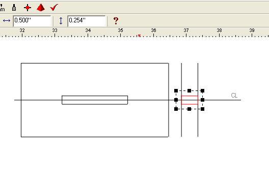

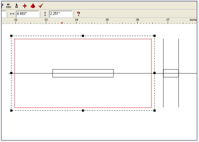

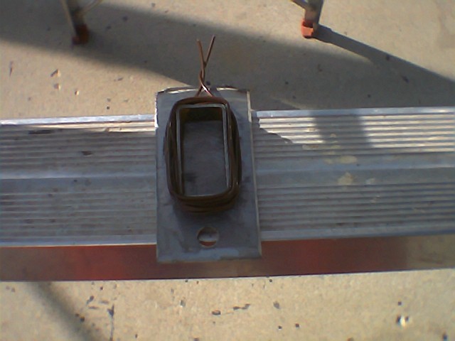

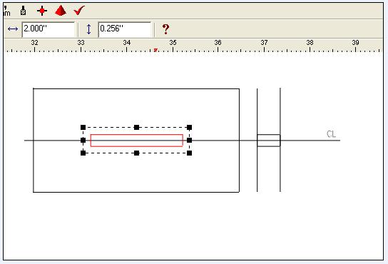

Raca fixture and coil winding
« Reply #35 on: April 19, 2007, 10:44:48 PM »
not sure what you have to work with , but i would make the slot 2 inches long by 0.25  inches wide ,by 0.25 inches deep, you could probably go a little wider if you had to , up to you..
and get a small paint brush , and some resin to brush on the coil as you wind it.
that way it will stay put when it cures
make a few turns dab a little resin on the coil , repeat till done
a little crayon on the fixture keeps resin from sticking to it.a small taper wouldnt hurt either .
you may not want to make the coil 1/2 inch deep , in fact i would start with a test coil about 1/4 inch deep ,
if you make the legs of the coil around .9 inches plus or minus a little ..
i made the fixture the length it is because as the wire wraps around the ends will bunch up and probably force your fixture apart
« Last Edit: April 19, 2007, 10:44:48 PM by willib »
Re: 32in Radial alt
« Reply #36 on: April 20, 2007, 11:11:01 AM »
Hi RP
 I probably would have done just has you say, but has it turns out i only need 12 more to get to Willibs design.
 Ill probably just jb weld them in place because i know i can remove them if for some reason it fails.Na we wont allow it to fail)LOL.They really like to stick to it, without anything its hard to remove them.
 Need to redo her(tower)legs to fit the beast for testing also.
 Back to the coil.
 Got the afternoon off and its a nice day.
 Thanks for the advice.

Re: 32in Radial alt
« Reply #38 on: April 20, 2007, 05:35:59 PM »
Thats the way it worked out.
its up to you ultimately ,so if you want to go with a slot of 1/2 Inch by 2 inches
just remember the more copper that you present to the magnetic field the better.
 360/45 = 8 degrees , so tour coils cant span more than 8 degrees
not sure if i mentioned it , but i did imply that i would wind the coils with a flat fixture , not curved , because at the perimeter of a 32 inch dia wheel , 33 inches with the mags installed , a flat coil should not be a problem.
« Last Edit: April 20, 2007, 05:35:59 PM by willib »

« Reply #39 on: April 21, 2007, 10:17:42 AM »
Willib
 Whats your thoughts on something like this?
« Last Edit: April 21, 2007, 10:17:42 AM by vawtman »
Re: 32in Radial alt
« Reply #40 on: April 21, 2007, 10:00:22 PM »
my eyes must be failing me because that hole looks a tad bigger than 1/4 inch wide?
looks a tad more than 1/2 inch wide too...
my thoughts on it are , it looks fine if you want to limit your output to 1/4 of what it could be.
« Last Edit: April 21, 2007, 10:00:22 PM by willib »

Re: 32in Radial alt
« Reply #43 on: April 22, 2007, 12:48:21 PM »
i linearized  a standard three phase machine , on the right.
the magnet spacing is 360 degrees/ 60 magnets = one every 6 degrees.
do you see the similarity between the two
i've left out the hole in the coils on the right one
if Vman makes the coil legs about .9 inches , and keeps the number of turns low , say 50 turns ,ie a thin coil
we need a test coil to nail down the number of turns though
« Last Edit: April 22, 2007, 12:48:21 PM by willib »
