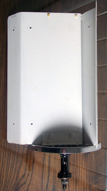

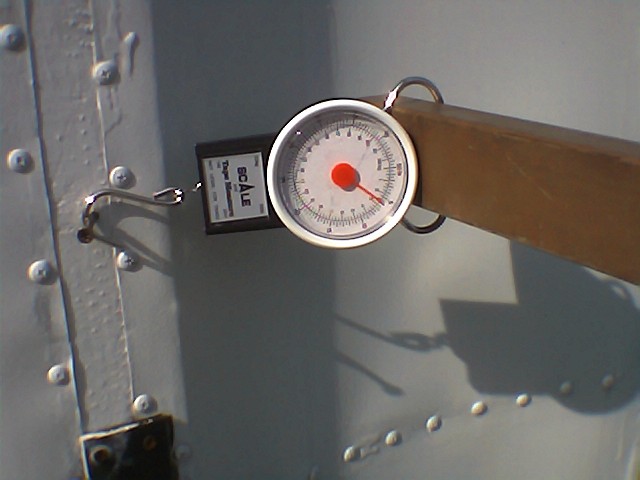

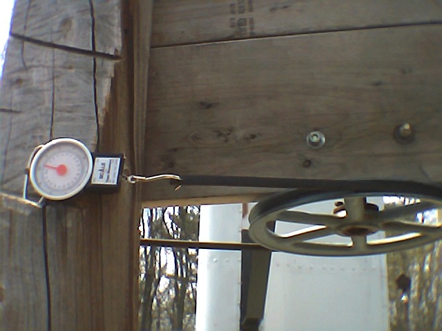

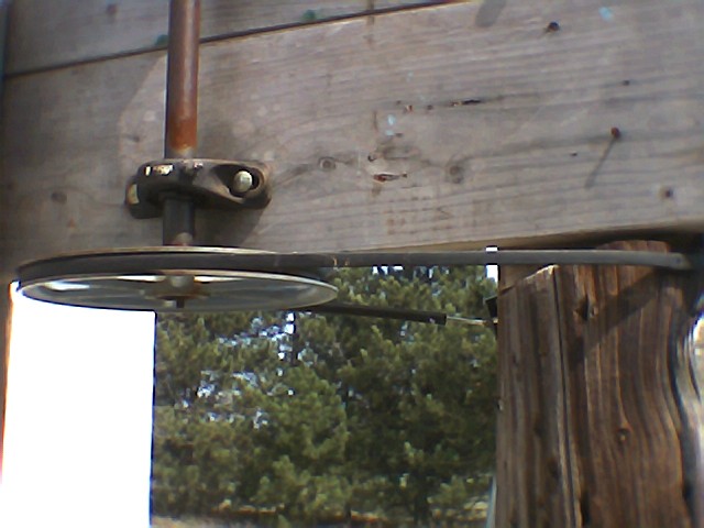

The turbine will start spinning when the gauge reads 8lbs,windspeed~around 12 mph.
The pulley is 12in and the belt covers half of it.
 Am i getting any usefull info here?Fun to watch the gauge.
 If i let it freewheel to 120rpms the gauge reads over 30 before i can start slowing it.
 The scale and belt were set so that the reading was 0 and snug.
 Heres some pics.

I don't understand the first picture.
In the second and third you seem to be using the belt as a rope dynamometer. You need two spring scales, one in each side and the force you need is the difference between the two.
Taking your figure of 30 lb as a best case ( will be less when you extract the pull in the other side) that gives you about 250W. I am not sure if it is sustained or whether you are removing the inertial energy. you need the speed and load at the point that it sustains motion.
Certainly on the right lines, keep up the experiments. Try it with the second spring scale. I find a simple wooden brake clamped round the shaft infinitely easier to read under varying conditions but it can be done.

 The first pic is steel tubing attached from the tower to the blade in a attempt to measure startup torque.
 Back to walmart to get another.You realize this is gonna cost me another 5 bucks!!
 Kidding
 How could a wooden brake on the shaft stop it when i cant with 2 hands.
 Would you please do a drawing when you can.The shaft is 1 1/4in
 thanks.

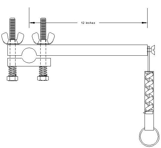

  This is what Flux meant by using a board as the brake, it's very controllable by tightening the thumb screws or loostening them which ever allows it to run continuous while getting a reading from the scale.   The double spring system works quite well also, just have to calculate the difference between the two springs and the arm length to get the torque.
Do you have a way to measure wind speed, rpm and torque at any given moment?  That information would make it easy to match an alternator to it.

Hi Ed
 Thanks,I understand now
 At its current testing sight the wind is all over the place.Today probably 0-40mph.
 Windspeed i think im a good guesstimator at and would not overblow things.
 Rpms i just count since the blades are visible when dragged down.
 Torque is what im trying now,right.
 Thanks alot and gonna build your drawing.

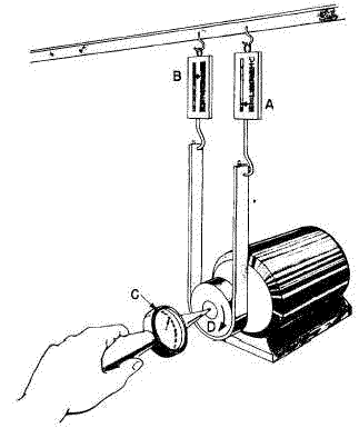

« Reply #7 on: April 23, 2007, 01:14:25 AM »
Hope this works.
You need tension in the belt to give grip, that tension is common to both so you need the difference in scale readings to give the force due to torque.
In this case the torque arm is the RADIUS of the pulley.
« Last Edit: April 23, 2007, 01:14:25 AM by Flux »

Flux. Souldn't that be DIAMETER instead of RADIUS of the pulley?
« Last Edit: April 23, 2007, 08:52:43 AM by jimjjnn »
Re: Spring Scale Fun
« Reply #11 on: April 23, 2007, 10:37:56 AM »
  I believe the radius would be the correct value to use since the torque or pull is actually on one side.   The radius would be the "arm" length.   Some of the small ones I've built like this I've always used the radius for calculating output.
« Last Edit: April 23, 2007, 10:37:56 AM by windstuffnow »
« Reply #12 on: April 23, 2007, 10:57:05 AM »
No , it should be radius, that is why I put it in capitals.
I scrounged the picture from somewhere and I have no idea why the pulley has D on it, I thought it might confuse.
The force boils down to one acting on the radius of the wheel as in any other torque measurement.
« Last Edit: April 23, 2007, 10:57:05 AM by Flux »

« Reply #13 on: April 23, 2007, 12:18:40 PM »
I think it was a part label - "D: RPM guage" or similar.
« Last Edit: April 23, 2007, 12:18:40 PM by wdyasq »

Hi Ed
 Could i make that out of hdpe?
 Love to play with the stuff. Is it too slippery to get a accurate reading?
« Last Edit: April 23, 2007, 03:15:59 PM by vawtman »
« Reply #15 on: April 23, 2007, 03:31:55 PM »
Thanks Flux
 Wondering something,if i use the 12in pulley with a belt matched for it,How does the friction of the belt and pulley factor in?If it was just on the shaft there would be less friction loss.Am i right or way off base has usual?
« Last Edit: April 23, 2007, 03:31:55 PM by vawtman »
« Reply #16 on: April 23, 2007, 05:01:21 PM »
  The idea is to add enough friction on the shaft to pull the spring scale to get a reading while its running at a specific rpm and load so you can calculate the output of the machine.  Either the belt/dual spring or tension arm type prony brakes are designed to add a force to the shaft to calculate this.  To much friction will simply stop the machine not enough and it will allow it to run free and you wouldn't get an accurate account of what the machine is doing.
  The thumb screws allow you to apply a controlled amount of friction to the shaft while reading rpm and torque.   With the belt over pulley type you would need to be able to adjust the spring tension in an at rest stat as needed to get it dialed in.   It's best to use a flat belt ( a leather belt that holds your pants up works very well ).   In either case the resulting numbers would be the same.   In order to get it correct you'll still need a way to measure wind speed, rpm and torque at any given moment for an accurate accounting of what the machine is doing.
« Last Edit: April 23, 2007, 05:01:21 PM by windstuffnow »

Thanks Ed
 How did you know i needed a belt to hold my pants up.Your right im hipless.I understand that friction is what were measuring but if you apply friction over a small area(the shaft)or the 12in pulley(big shaft)struggling with the accuracy of measurements between the two.
 The v belt seemed to cog alot.
 Off to a new setup.
« Last Edit: April 23, 2007, 05:17:21 PM by vawtman »

The friction of the belt and pulley is what you want.  That's the load you are putting on the mechanism.  The friction from the slippage will cause heat thus dissipating power from the turbine.
You could use a greased belt but then you'd need a bunch of force on the spring scales to get friction or a dry sticky strap of leather in which case you'd need less force on the scales.  In either case you subtract the force on scale B from scale A leaving you zero... until you start turning the shaft.
Let's say you have the shaft spinning in a stiff breeze at 100rpm with the belt slack.  You start tightening up the belt until your rpms fall to a reasonably steady 50 rpm.  You read the scales and find that one of them reads 8 pounds and the other reads 30 pounds.  30-8=22lbs. Multiply this by the radius of the wheel in feet and you have torque in pound feet.
Multiply the torque by the rpm and divide by 5252 to get Horse Power and divide HP by 746 to get watts.
Now try slacking up the belt some to drop the torque but the rpms increase.  If the torque drops by 10 % but the rpms increase by 30%, then your total power in watts has increased by 17%.
On the other hand if your torque drops by 10% but your rpms only increase by 5% then your total power has dropped by 5.5%  Any given turbine will have an optimum torque and rpm for a given windspeed for maximum total power out.  This where Tip Speed Ratio comes in.
This is the heart of matching the alternator (and the load) to the turbine.  Part of the trick is trying to design things to be as max as possible over the full range of possible windspeeds and (usually) preferably in the most common windspeeds
Hope this helps.  I'm sure someone will jump in if I got this seriously wrong.
