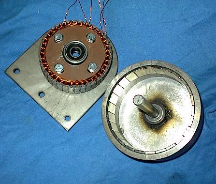

  Completed with the exception of the lathe test.  So far it was a sucess, very little cogging as I expected and the iron drag is actually much less than I had expected.  The force needed to start turning it was 2 inch/lbs or 300 grams of force at 3.5" arm.
  I plan to go back out tonight and set it up for testing and I'll post the results.  Here is a picture of the unit with the rotor off...
  I ended up with 10 turns per coil opting for a 200 rpm cut in speed.  After some thought I figured 100 rpm would be a bit slow.   It's purpose isn't for wind, directly, but for a small stirling engine.  Indirectly, it would work quite nice on a wind genny.
  Fun project !  My curiosity has been taimed and it was quite successful overall.  Have to finish up some other work then I'll complete the stirling for it...

  Spinning the radial in the lathe here is what I came up with... I only ran it at one speed to keep it simple and get an idea of what it would do...
Running at 400 rpm charging a 12v battery.. 3.5 amps at 14 volts 49 watts
I decided since it was quite easy to chuck the rotor in the lathe and the backing plate would pivot to go ahead and check the input as well.  My scale read 2500 grams at 3.25" which comes out to 1.49 ft lbs of force and at 400 rpm was about 84 watts so its about 58% efficient at that speed.   After calculating copper losses ( about 7-8 watts ) the rest has to be iron drag.  So it's loosing about 27 watts to the iron.  Not super efficient by any means but I mostly wanted to see if the odd pole/coil count would be offset enough to reduce the coging.  The cogging is quite insignifcant.   I think using some M19 steel to make up the stator stack the iron loss could be reduced considerably but not completely.
  As it turned out this was a really fun and quick project which merits a larger one in the future!

I don't see the return path for the magnetic flux opposite the rotor pictured.  Does the stator have iron behind it?
« Last Edit: April 30, 2007, 07:51:59 AM by BigBreaker »
Re: Radial completed
« Reply #18 on: April 30, 2007, 02:12:36 PM »
  The stator is made up of 8 steel plates laminated together.
