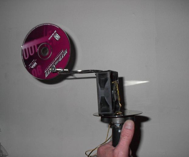

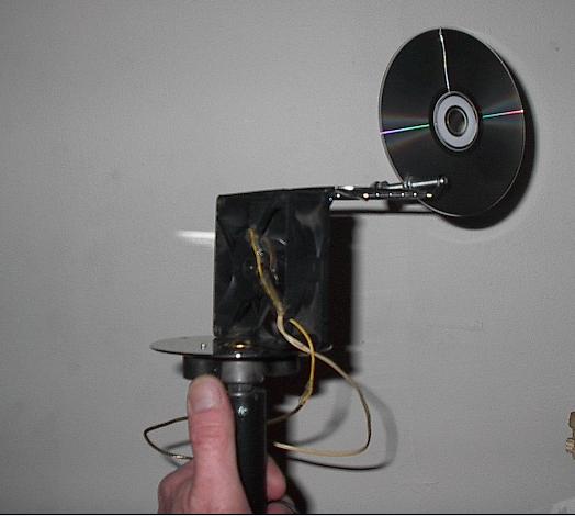

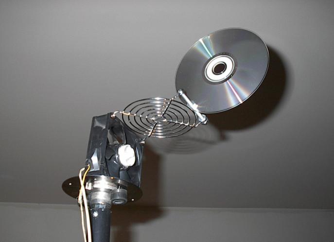

Thanks peter
after a lot of thought i finally installed a yaw bearing on the anemometer
so now it swivels as easy as pie
i used the chrome cover from another powersupply fan, to hold the 'tail'
i didnt think the chrome plated wire would break so easily when i bent it.
so i had to use another one , which i annealed before bending
the tail is held on with 10-32 threaded rod, and a couple of nuts.
the two bearings i used fit the pipe almost perfectly on the OD, and also fit a 5/16 brass  bolt with the ID .
so soon i will have some blade data
like wind speed vs. power out , as it seems good enough for china magnet it should be good enough for me.

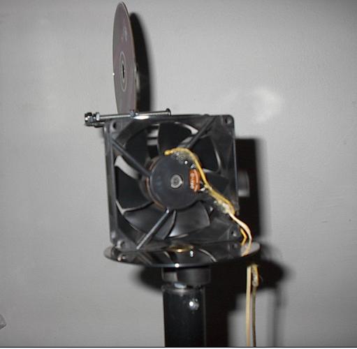

forgot to ask. How do you fight the fan's cogging ?
« Last Edit: May 14, 2007, 11:08:32 PM by s4w2099 »
Re: Anemometer II
« Reply #3 on: May 14, 2007, 11:11:45 PM »
What cogging?
it dosnt cogg.
once you remove the armature there is nothing to cogg against

Re: Anemometer II
« Reply #8 on: May 15, 2007, 11:01:27 PM »
yeah ya got to take the armature out , but not the hall switch or the magnet or the circuit board because ya need that
as the magnet turns it flips the hall switch on and off
the hall switch in turn switches some fets on and off
and if you tap into the drain of one of the fets you will get a squarewave with the amplitude of your power source , ie use 5V to power your anemometer you get a five volt squarewave out.

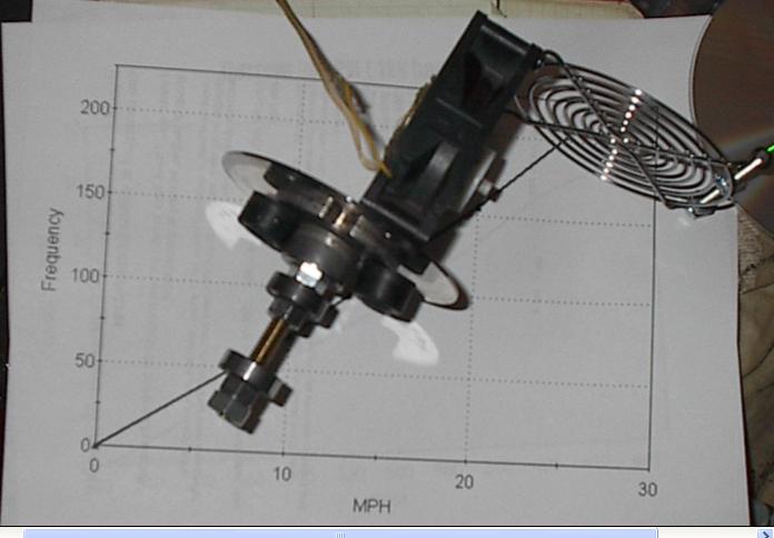

i had it apart yesterday to beef up the fan to mount connection so i snapped a pic of the bearings
