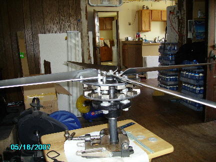

In a previous post I mentioned I had fitted a set of 10ft blades to my 8ft 48v Hugh Piggott machine, this has released it from stall and it has produced loads of power ever since. However there is a but! As was pointed out at the time by flux this was maybe not such a good idea anyway to cut a long story short I have decided to rebuild the stator as per Hugh's latest plans but with a bit of a twist in the construction methods and materials.

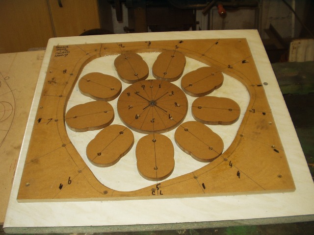

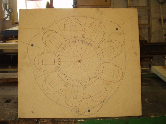

I decided as a first step to draw it out full size on 12mm MDF to use as a ref for templates and jigs for the router and to check that it would all fit. The layout is almost identical to the original Hugh Piggott design but I had to change the position of the mounting holes. The coils are in there original positions but will not be cast in place.

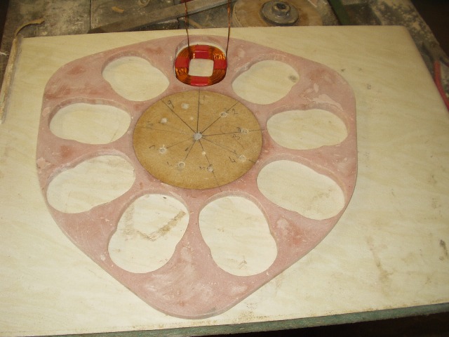

The mould is slightly different to the norm as there is an island for each coil

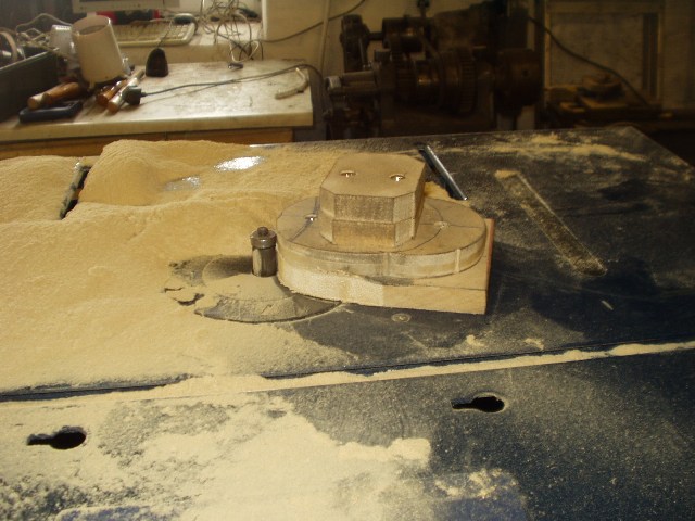

The coil islands where all cut on a router table from a master jig so all where identical

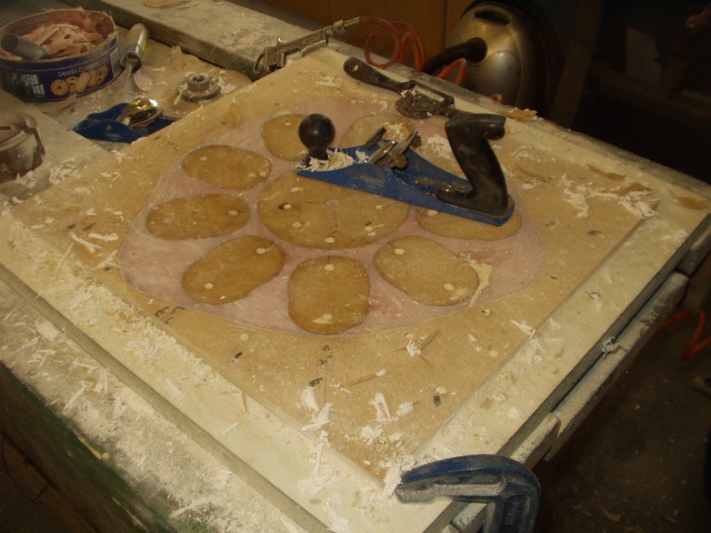

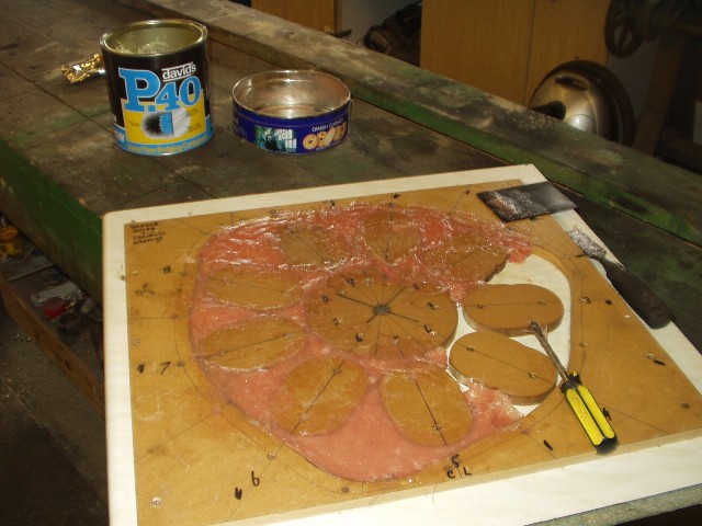

I have problems getting resin and matt locally so for this one I tried "Fibrefill" for those that haven't used it before it is just resin with chopped mat already in it. It is reasonably cheap and easy to get from any car parts shop. I was able to push the mixture well into the mould and vibrate it with a sander to remove any trapped air. This all went very smoothly and without any problems.

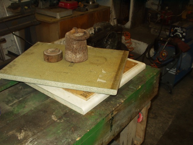

I closed up the mould, weighted it down and went for cup of tea.
On my return after about 20 mins the stator had set and I was able to start levelling off the top, this was best achieved with a sharp smoothing plane and belt sander
The stator almost fell out of the mould but I left the centre island in for now as a ref datum for centre.
