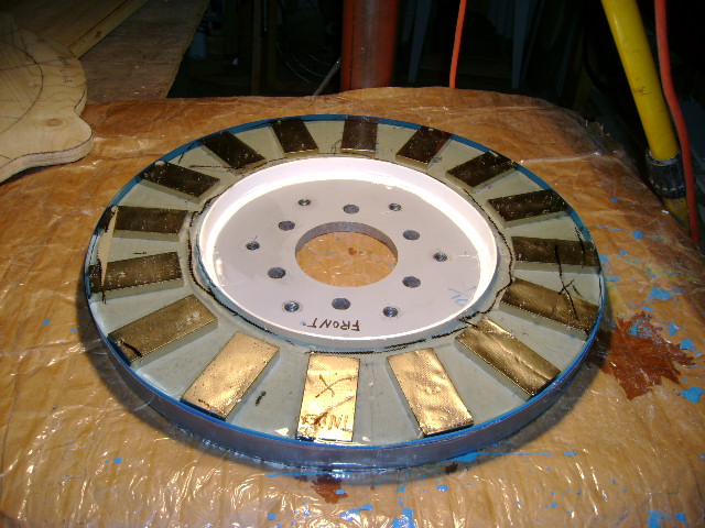

I purchased the 32 mags 3 x 1 1/2 x 3/4 from our host, and used a 18 in.  1/2 thick disc as Dan said the mags were a little too close together on his model. I used West Epoxy on the 2 rotor disc
My stator is wired for  24 volts and Dan did his for 48 volts. The stator is cast in fiberglas.

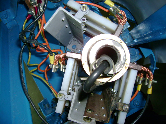

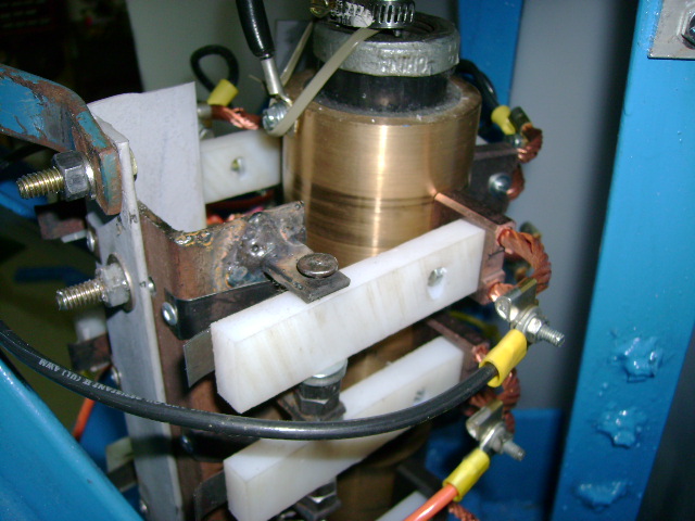

This is where I started to add a few of my own idea,s.  I use 3 sliprings on this model and will take 3 cables of 2/0 160 feet to my 24 volt array. This is a top view of my slipring and brush assembly.
I am using 3 brushes on each slipring for a total of 9 brushes. This machine will be putting double the amperage as Dan,s because his was 48 v and mine is 24 v  Somewhere I came across a discussion and was said Dan,s was puting out 83 amps. So at 160 amps divided by 9 brushes, would be 17 amps per brush. These are starter brushes and are rated for 600 amps. Should be an easy life even if my calculations are off.

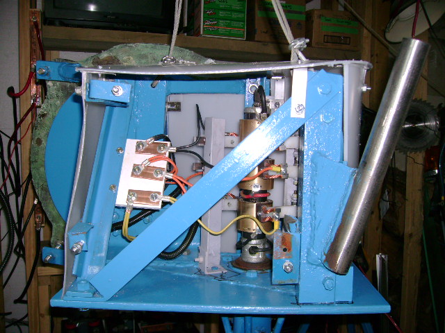

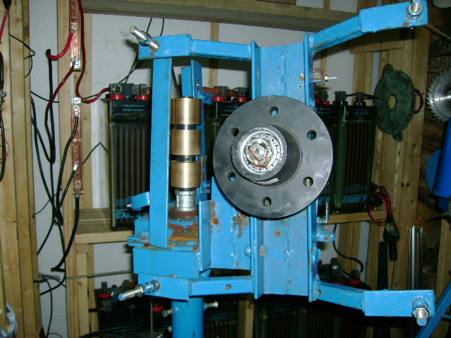

This is a rear view of my Dual Rotor with the rear panel off. This machine is covered as we get all kinds of weather in the Northeast. I used the buckets that the wire came in to cover the sliprings, brushes and my Yaw bearing. The buckets are slightly larger than 5 gallon cans

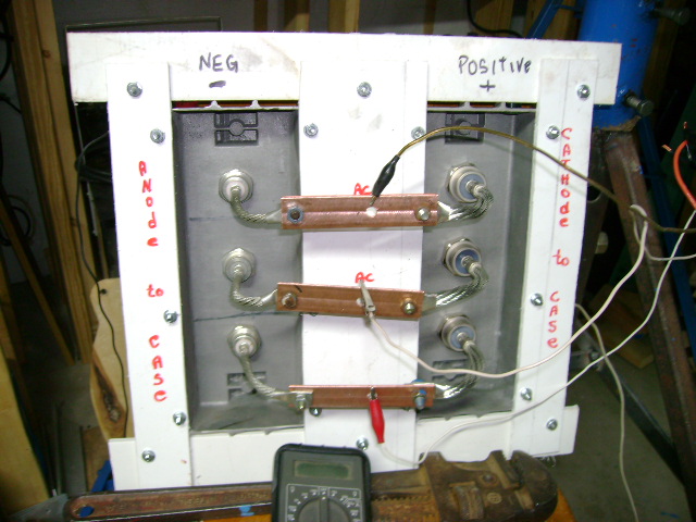

I am using 6 stud rectifiers in a homemade heatsink with fans and could be modified with larger heatsinks if they show any sign of overheating.
I have made a knife switch to control this machine and will probably rig up a load to short it into instead of the stator taking the heat.

Nice slip rings

One comment - for teh stop switch you have basically a triple pole double throw switch.  You only need a double pole single throw - although since you have it there I'd use triple pole single throw.  What you have now has 3 positions - down is braked, up is 'on' and in the middle is 'self destruct'.  If you only have two positions (open  - which would be on - and braked) it would be a bit safe in case anyone ever decided to mess with the switch.  Just a thought...  you have 9 leads on there - it be safer if you only had 6.

 Dan, on all the other machines I built from 4 foot to 12 foot I used my rectifiers at the top. This 17 foot is the first for rectfiers at the batterys. For some reason I could see the switch before the rectifiers, and never considered swich after the rectifiers. You could call it being narrow minded. Wife would say Pigheaded.
Matter of fact I will take your advise and put the switch after the rectifiers. It would be less confusing for my wife to shut it down when I was away.
Do you think I need more heatsink for the stud diodes. If you think I would be better off with 2 or even 4 of your heatsinks I will have you send them to me. I would rather over build the heatsinks, than have a problem. Thanks  Mitcamp

Now that you have the choice, put the switch before the rectifier. breaking dc with a knife switch with no flickers is a messy business.
If you do it before the rectifier there is no feedback from the battery so you can just short the 3 ac incoming leads. Minimum requirement 2 pole single throw, 3 pole single throw is nice. No need for any change over.

Put the switch BEFORE the rectifiers as shorted batteries get VERY NASTY!!!!!!

For some reason I could see the switch before the rectifiers, and never considered swich after the rectifiers. ...
With that arrangement I think she would become very confused when she first disconnects the switch from the "generator on" position and the mill speeds up and starts to shake itself apart, then she shoves the switch into the "brake on" position and sparks fly, the switch welds, the diodes explode or pop internally, then either the wires become red hot, the insulation starts smoking, and the genny catches fire or the mill continues to runaway and finishes destroying itself, throwing huge chunks of blade around the yard at about a quarter the speed of sound.
NEVER put the brake switch after the rectifiers.  Presuming you're disconnecting the battery properly, when you turn the switch on the momentum of the blades keeps the generated voltage from dropping until they have been slowed down.  With a short across the output the current climbs drastically, limited only by the voltage drop in the diodes and resistance of the wire.  Result:  Fried diodes and (if they fail open) a runaway mill.  (If you're NOT disconnecting the battery properly you melt the wiring into slag, set the shed on fire, and/or explode the battery and spray the vicinity with boiling sulphuric acid.)
You use a double-pole switch on the 3-phase side of the diodes.  Tie X to one pole, Y to another.  Tie Z to the opposite end of BOTH poles.  Label it "electric brake".
Off:  Normal operation.
On:   Three-phase is shorted on the AC side of the diodes:  Brake are on.
There is no third setting to foul up with (or confuse the wife).
