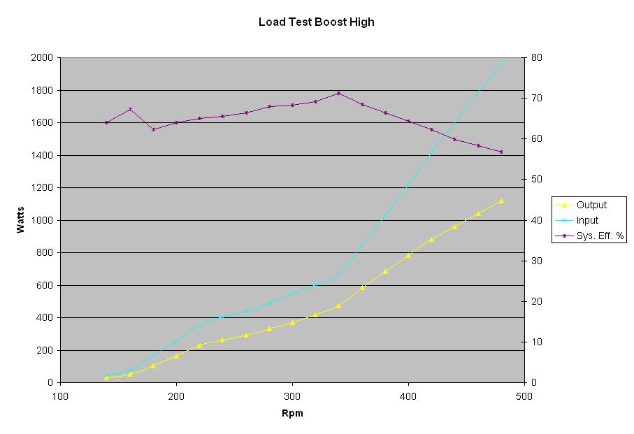

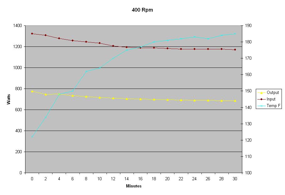

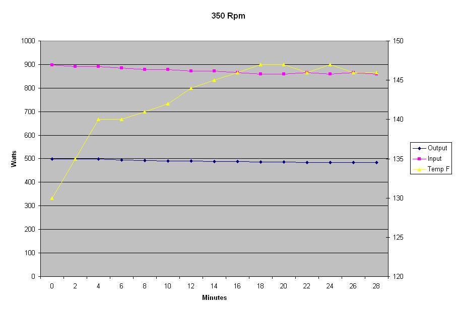

Here are some more graphs of test results which includes stator temperature.   Previously, I wrote that the efficiency of the alternator seem too good to be true.   Come to find out that the rpm read out from the drive controller was off when the alternator was loaded.  The rpm was 6% faster than the drive controller  readout compared to when I clamped an AC lead and calculated rpm based on frequency.

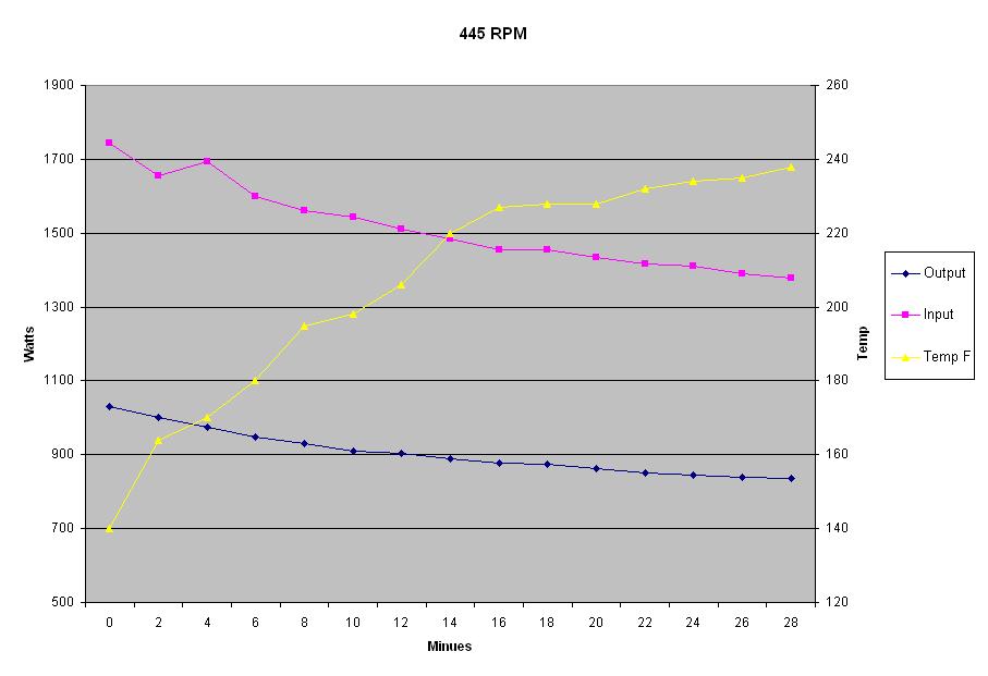

Also, found out that this little alternator can really tax the 3 hp rated motor.   It is rated for 3 hp at 880 rpm.   For continuous operations, about 425 rpm is the best the motor and drive combination can do without kicking out on overload.   Was able to get one series test done at 445 rpm after resetting drive a few times.

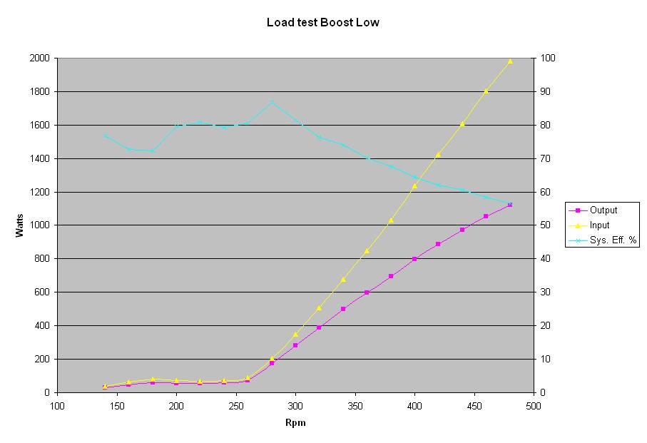

Playing around with the boost converter, one of the interesting things is if I set the boost voltage high, the over all efficiency stays up until the boost is surpassed.   Maybe someone with the electrical background can explain why.    Granted, I would not set the boost this way because it would stall out.
Other observation:  I'm amazed on how much heat is given by the rectifiers when some sustained amperage pass through them.  What a shame to lose that captured electricity to heat.

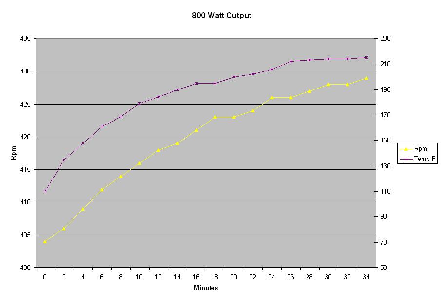

You derserve credit for some of the more meaningful work presented on this board pertaining to the axial flux alternator. In particular, the temperature data is most revealing and gives us an insight to the problems with the cast stator.
In looking at your data, one piece seems to be missing - the ambient air temperature. I assumed 70F in my analysis. This can be corrected for if significantly different.
Using your three power/temperature charts, the temperature rise over ambient gives gradients of 0.21, 0.24 and 0.34 degrees F per watt of stator dissipation. I used 0.3F/Watt in the following chart for the higher power levels.
The estimate for coil core temperatues includes a factor of 104F (40C) to account for the thermal resistance of the casting resin. The derivation for this is found here:
http://www.fieldlines.com/comments/2006/11/26/17291/409/27#27
Assuming 200C wire insulation rating, that estimated core temperature point is reached at 1kW output (760 stator watts).
Perhaps a more significant question is what happens to the casting structural integrity at those temperatures. Most cases of reported stator failures include reports of stator contact with the magnet rotors.
I would suggest a maximum safe sustained operating power level of 800W for your machine. This allows for higher ambient temeratures and a safety factor. It should be pointed out that this could be increased by 25% to 1kW if a non-cast stator was used.

One final question. Were these latest tests done into a resistive DC load, which you have shown, or into a battery bank? If you really want to see the alternator efficiency itself, better to measure at AC into a resistive load. Of course the final end results is better shown with rectifiers into a battery bank or better yet, into a constant voltage battery simulator.

The system voltage was controlled with a diversion controller also connected to a battery bank.  The voltage was clamped by the diversion controller at 28 vdc.  During the testing, the diversion controller was dumping energy to the resistors.
