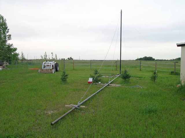

Here you can see the tower on the ground.  Not enough pixels for all the guy lines to be visible.  The gin pole is fairly long, but I had 20' of 3" pipe sitting around...  The upshot is that the tower is very easy to raise: 350 pounds to get it off the ground (measured with a scale), and the load gets smaller, the higher it gets.  Also due to the long gin pole length, the weight of the gin balances the tower.  I got off the tractor when the tower still had 15 degrees to go, and I pushed it the rest of the way up, by pushing the gin down by hand.  It moved gradually and smoothly.  Everything came to a stop at the apex without any abrupt wobbling - and presto!

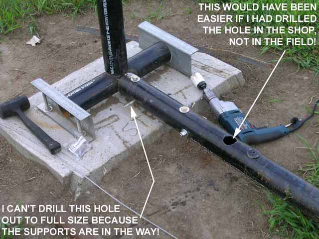

This is where I've made a few errors - nothing catastrophic.  I can't drill out one bolt to full size because I can't get the drill between the base supports.  How stupid!  Also stupid is forgetting to cut a hole in the pipe to let the power cable come out!  It's all fixable, but so much easier if I'd done it in the shop!

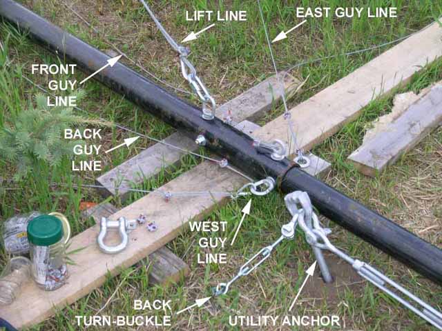

The middle joint is pretty busy.  The anchor is 22' from the base, and the first 3" pipe is 21' long, so a lot of cable ends come together in the same spot.  The guy wires are small here - they just stabilize the middle of the "noodle".  There is also the 3/8" lift cable connected to the gin pole.  The tower looks like a soggy noodle if I don't pull it up with a middle lift cable.

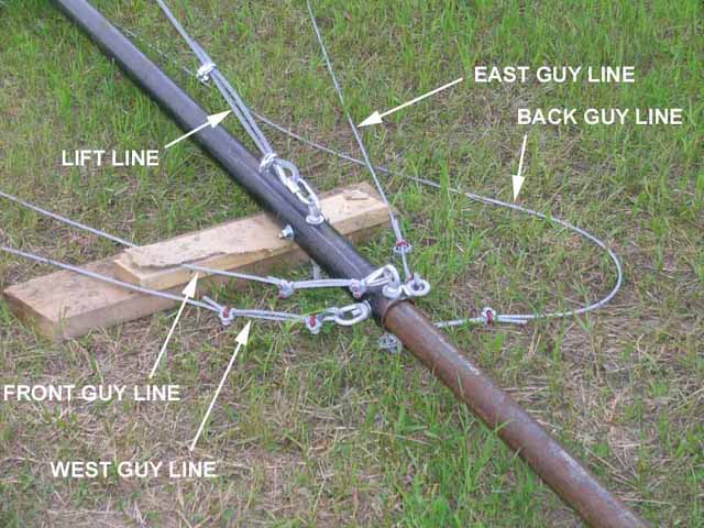

Here's the top set of guy wire attachments.  These cables do the real work, so they're 1/4".  I opted for eye bolts to make attachments, so there are a lot of multi-purpose fasteners.  The eye bolts attach the pipe segments, absorb the bending loads, and connect the guy wire reactions.  It sounds like a lot, but there's still lots of margin.

nice work Steven, you could drill a small hole in the anchor bracket and use a drill bit extention to drill that last hole. it looks like you will have enough clearence at the outside of the anchor bolt. pepa.

If you could get your hands on a angle drill you would be able to drill that hole with out any problem.

The last picture shows a threaded chain-link at the end of the lift line.  I'd suggest using some thread-lock on that since it will be up there vibrating in the wind for a long time before you use that lift line to lower it down again.

Using those threaded quick links is so-ooo convenient, but I have carefully resisted using them as much as possible.  Some loc-tite is called for.

Now why didn't I think of that when I had that hole-saw out?!?  Good thinking, pepa!

  I would ,if I were you, increase the size of your fittings ,turnbuckles,Shackles,Wire grips,  and standing wire to 3/8 inch.
Do away with that chain-link thingo,there ok for boy scouts camping ,,not this  sort of lifting gear-unless you get one quite a bit larger.

All comments are welcome.  The chain links don't make me comfortable, either, and I promise to eliminate them soon.  This tower will be raised and lowered several times this summer as I make improvements / repairs / etc.  I will have many opportunities to inspect and replace the hardware.
As for the anchors, the manufacturer's data sheet specified a 5000 pound load in my soil category.
The tower has been analyzed by by hand, and by FEA.  All components have a safety factor > 4.
If you still believe it's not enough, just say so.
I'll be looking at your photos in a minute to see where you're coming from.
Did you (or an engineer) analyze your tower's loads?

 You can spread those thimbles by twisting them sideways. Then you can delete the chain link all together. I think your ok anyway. Your turbine isn't that big to put that much load on it. I think your fine with those screw in anchors as long as you have good ground. I wouldn't use them on a big tower, with a big mill on top though. Just my thoughts.
