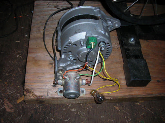

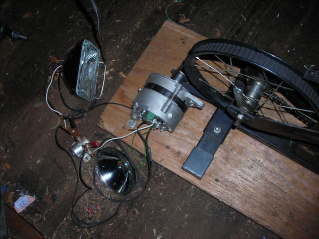

had this car alt laying around--so i decided to try it on my pedgen..
stock alt no mags and not rewired--surprized me it kicked right off without even a batt hooked up to it--just had a piece of wire from field clip to batt lug on alt...
once the field coil kicked in i could slow down my cranking speed--almost to a crawl and still get power out..the drag was kind of high with the wire from field to batt lug on alt--so i hooked up a 30watt headlite to the field and batt lug--plus a solinode to
switch on a 50watt headlite for power out...[took some time to figure this all out as
i was blowing headlites out every time the field coil kicked in]..
one other thing i did was to take the pully off and make a smaller shaft set up[just a piece of pipe slide over the alt shaft..any way this set up is only good for about 100 watts or more--but it does power up on its own...with a bigger pully i could of course
get a lot more power from it--but then i would need a batt to excite the field coil..
even a 9volt transitor radio batt would work--sence you just have to only momentarly
charge the field coil--for it to kick in..i belive the open volts was close to 50v
thats with me pedaling almost full out..
one thing that did surprize me was the low rpms to hit 12v with a 50 watt load-even
with a 100 watt load not much more rpms were needed..[thats after the field kicked in]
not sure of the voltage rating on this alt -no markings on it voltage wise[thrift
store speical 5 bucks-looked unused]so it may be a 24v alt??coils look to be the same as a 12v alt.. might be could for a water wheel set up or a windgen if it was controled.heres a short clip- 3meg.

i made a slightly bigger shaft for it[pipe]..plus i replaced the 30w headlite that
hooked to the field coil with a taillight bulb..now its a lot easyer to pedal when
theres a load on it..and i still dont need a batt to power it up..
 the more currant you apply to the field coil --the stronger the magnetic field..
not sure of the amp rating on this alt-65??--but theres no way im going to get that pedaling--so you want the amount of currant going to the field coil to be somthing you can handle--thats why i switched to even a smaller bulb--no sence in fighting all that extra drag--just for fun i hooked up a 400w 38v aircraft landing light--got way to bright to even look at--plus i had to pedal like a mad dog in heat...
not sure of what i can get out of it now--blew out most of my spare headlites..
guess ile have to borrow the amp meter off of my motorhome pedgen and find out..
its late here...heres a shot of the alt and wire hook up..
