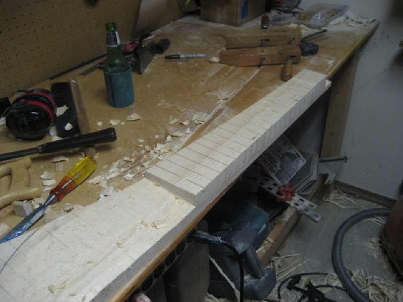

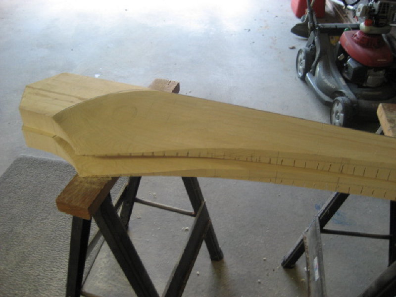

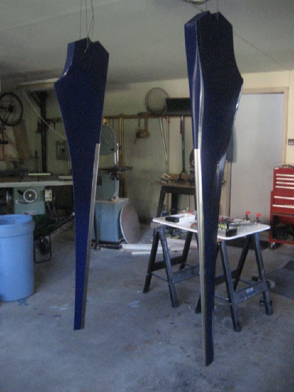

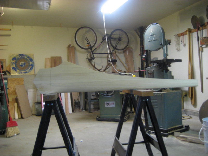

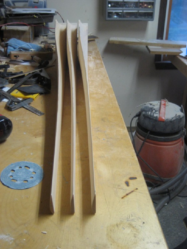

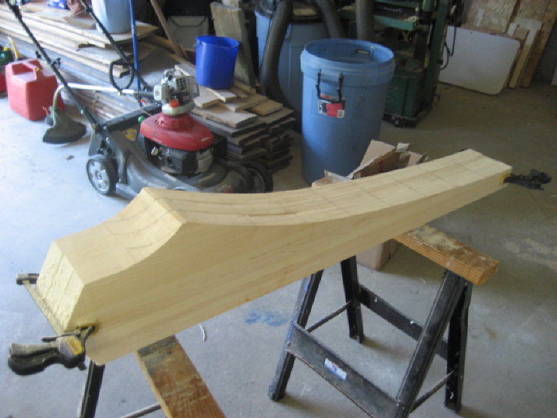

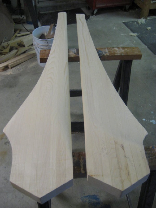

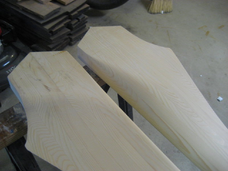

The blades will make a 2.8m diameter prop.  They are carved for a TSR of 7.  The cord length near the root is 11" wide with a thickness of 2.25" inches.  2" stainless steal tape covers the leading edge.

Just Bloody beautiful work -as we say down here !!!.

Thanks for posting that! Nice looking set and good to see some thick wide roots like that. I live for these "I did this" posts.

Nice work.  Always seems a shame to me that so much wood ends up as scrap on a set of blades like that.  What did you paint them with?

Beautifull craftsmanship Boondocker:>)

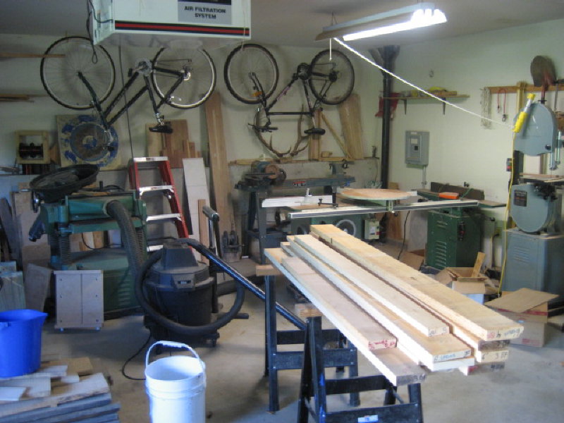

very nice looking blades boondocker!! Looks like you have a nice well equiped shop too, which always helps.

  I second Tom's comment about seeing some blades carved with the other half of the equation, wide root and more drop for greater twist. Those blades are beautiful and will really perform. I'm not sure what your application will be but they will start in a fart and will accelerate like a shot if not loaded down enough or limited with decent furling. Be careful, I carved my first 12' very similar and measured (AC frequency) verifying 800 RPM loaded in 60 MPH winds ! Couple coils came loose but the blade assembly held together, I swear by that Gorilla Glue  with screws too of course. Very nice work, keep us posted.  Dave B.

Frist prime, and then used outdoor Rustoleum gloss spray paint.
