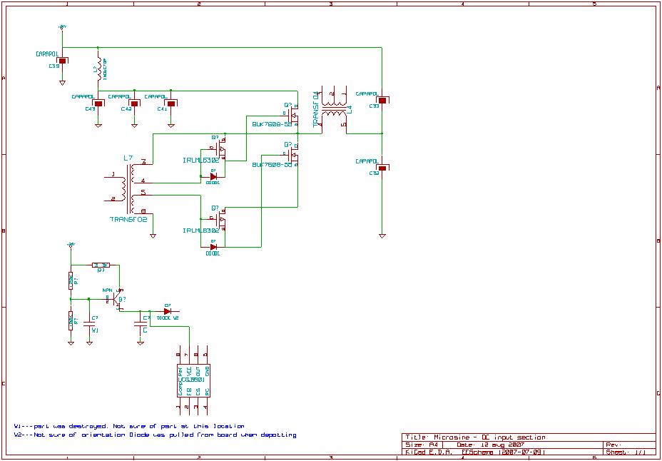

I had given up looking for a broken Microsine to take apart and jumped in feet first by taking one of my units apart.
Presently I have most of the potting compound off and most of the major components removed from the cicuit board.
I have begun to trace out the board and draw a schematic of the device. I have started with the 24 Volt DC input section.  I am using Kicad (freeware) to draw the schematic so others will have access to this software to view the schematic. I've posted most of my files into my photo uploads. Lists of parts, pictures, and schematics, and datasheets.
I could use some help identifying some of the board components....mostly surface mount items, or even help in organizing the data I post to make it more usefull.
Comments on the circuit would be interesting as well.
Cheers, Perry

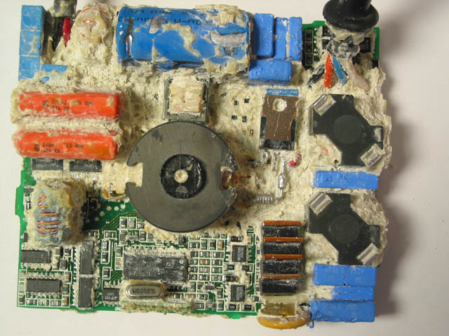

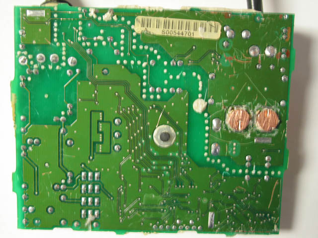

This is what it looked like a few weeks ago.
Higher quality pictures can be seen in my photo section.
« Last Edit: August 13, 2007, 02:41:21 AM by Perry »

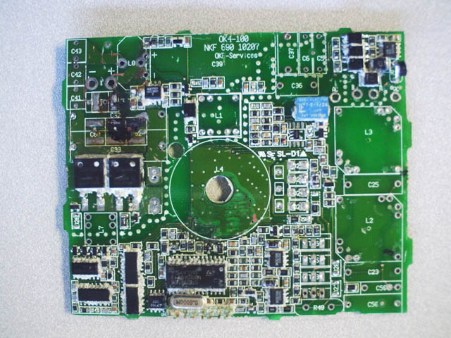

And this is what it looks like today.
Notice the dotted lines on the board?  The drilled thru holes still full of potting compound. They split the board up into sections.  The top left section is the area I'm working on right now. It's the 24VDC input section.
The sections are isolated from each other by transformers.  L7 is the input into the 24VDC section from the control section.  The 24VDC section outputs into L4.

C40?      1U0 K 63V PH
C41       1U0 K 63V PH
C42       1U0 K 63V PH
C43       1U0 K 63V PH
Those are most likely 1.0 Microfarads/63V caps.  Just insert a decimal point
for the "u" and call it microfarads.   Same kinda thing with
certain resistor designations.   1k0 would be 1.0 K Ohms
1R0 would be 1.0 Ohms  etc...
Does R49 measure like a resistor even though it looks like a capacitor ??
Maybe it measures like a capacitor ??
73 (Q73?) IRF644   ( Just a cheap 250V MOSFET  )
boB
« Last Edit: August 14, 2007, 12:41:40 PM by boB »

Ok, This is an attempt at posting an image  of my schematic to date.
As you can see it's useless.  :)  Kicad will only allow me to plot to the clipboard which I tried to paste to Photoshop and to Paint with the above result.
What I need is a FREE ( so everyone can access/use it)schematic drawing program that will allow me to take a clean image shot of it so I can also post the image here.  Any ideas?
I presently uploaded the file Microsine.zip which contains the 5 files that are in the project directory of Kicad so others can view it. ( Not much to view yet.)
I've also upload the individual files.
« Last Edit: August 19, 2007, 08:45:47 PM by Perry »

I had a little time to day to move forward.
Questions of the day.
I've got a Surface mount semiconductor with four leads. Marked 8G P124 BV (You can see it just to the left of L1 and there are three more in a row at the top right of the circuit board)   Any ideas?
Transistor marked 1F p.  My guess NPN from measurments.
Transistor marked SA p.  Have not measured yet.
Cheers, Perry.

Oh, forgot; that four-legged part could be a bridge rectifier ...

I also have two OK4E (Europe) made by NKF, but they are still working. Many have been broken down here in Europe due to high temperature. I have mounted mine on a big heatsink, after 10 years still no problems. Nothing to take apart for me:)
Like Reiney I also use EAGLE. May be good for you to try!
For some time I also try to build my own gridtie inverter, it's a hard thing to do. Not much information on the internet. Maybe your schematic will help.
May be I can offer you some help first.....
The part with 4 leads could be a bridge-rectifier or an opto-coupler, it's Easy to measure the 4 diodes inside or LED and transistor.
For the SMD transistors please look at:
http://www.repairfaq.org/REPAIR/F_SMD_trans.html
for Case-marking Cross-Reference.
1F    BC847B
SA    BSS123
Hope this helps!!

R49 must be a Varistor for 130 Volt. It's a protection against overvoltage....
