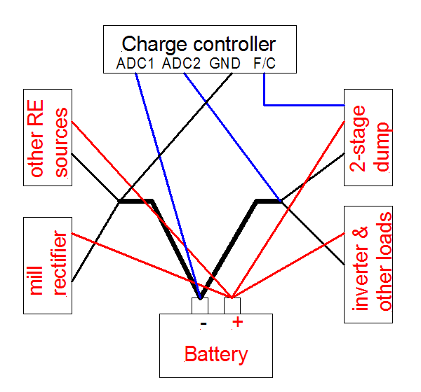

Here's an overview of what I'm thinking of -
The controller uses two analog to digital converters to sense the (current dependent) voltage drop across two battery cables or shunts. Since most systems have battery cables in them anyway, you can use them for free. The only technical requirement here is that the system wiring needs to be split into separate "source" and "load" sides and the controller's ground needs to be on the "load" side (so that the ADC inputs are always positive with respect to the controller's ground; I don't know of any microprocessors that can measure negative voltages.)
Based on the accumulated amps-hours in and amp-hours out, the controller will signal the dump load to switch from float mode to charge mode.
Note that if battery cables on both the source and load sides are the same, you don't need to do any calibrations since the scale of "x millivolts drop per amp" will be the same on both sides, you only need to subtract or add the ADC readings to get the net charge (or discharge.) If you use different sizes or lengths of battery cables then you will need some sort of "user interface" on the controller to program the relative values of the ADC readings on each cable.

Okay, I had that backwards... we had some wind this morning and the DVM on my battery wire was giving negative reading. I guess the way to think of is that the voltage "drop" across the ground wires actually pulls up the ground values with respect to the positive side of the battery.
The point is only one of implementation because the microprocessor can only handle positive voltages on its analog to digital converters. So instead of hooking up the charge controller on the load side of the system, it should be hooked up to the source side of the system.
Here's the corrected architecture:
That also suggests to me that if you run a ground wire along with the float/charge signal to the dump controller that you should put a resistor in series with the ground line to allow for the difference in ground values. (I don't think you'd need to go to an optoisolator until you had more than .5 volt difference. For example, 50 amps of source and 200 amps of load would only be .25 volts and that would be okay.)

I think that is another good reason to use the same sized cable on both the source and load sides. In that case, change in resistance cancels out (read next sentence) so you still only have to count "units" in and units out. The trouble there is you might use energy at a different temperature than you make it. For example, perhaps you use more energy during the day when it's warmer and charge more at night when it's cooler ... every 10 degrees C would give about a 5% error. While it might be possible to ignore this, there's no particular need to. It's just another number for the microprocessor to multiply while is calculating amp-hours, it's no big deal to take it (temperature) into account and that helps if you want to do data logging.
"Self-heating" in the shut wires was also brought up. For example, if you are using a one milliohm ground cable as shunt and putting 100 amps through it, you will have a .1 volt drop across the wire and it will consume 10 watts. I don't know how much that will heat the wire but my gut feeling is that with that length of that thick of a copper cable that the answer is "not much" and that the self heating factor can be ignore. Perhaps someone with more experience will comment on that.
That does imply, however, that two temperature sensors are needed. One to measure ambient temperature and one to measure battery case temperature. One could add, say, an LM35 for remote temperature sensor but thinking about it, what would the charge controller module do with the battery case temperature if it knew it? Unless the charge controller module can program the dump controller's voltages, there's not really anything that it can do with battery case temperature. I think it's something that the dump load controller (which manages float and charge voltages) should deal with. (And that means that there's no need to glue the charge controller's microprocessor to the battery case to use it's internal temperature sensor, it can be placed in a vented case to measure ambient temperature.

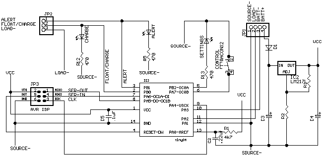

Here's a first pass at a schematic; I'm thinking that with all the discretes in the circuit that the cost might be up to six or seven dollars now.
Notes:
There's no single "GND" on the schematic, as indicated in the previous notes, the charge controller works on the "source ground" which is SOURCE- in the drawing.
Also, I've been no fan of adjustable voltage regulators but have been using lm217's in my mill circuits because of the large input voltage that they can take, much more than most fixed regulators.
I have put the full programming header for the AVR microprocessor in the schematic because it exposes the SPI interface. It might be possible to use the SPI interface for data logging. In that case I would put a resistor in the ground on that connector to keep the communications ground from messing up the readings of the other grounds.
 - Ed.

The gain of 20x may be nice...
From the other post I remember 19mv, if that is full scale then the 20x isn't enough.
ADC will see 0.4v in = 20mv * 20 you need more gain like 250x.
Ideally; GAIN = 5 / full scale shunt voltage.
Dual/quad opamps are cheap. AD8607 or 9; offset is very low, Iq current is very low.
250 gain, can measure current full scale. Two resisters to set the gain. 4 resistors if including ground offset shifts (the voltage across the shunt) as difference amplifier.
The opamps can correct for signal direction.
Using two opamps can measure current in and out on the battery input, do not need two shunts.
One opamp with offset half scale allows pos and neg currents to be measured, resolution is halved, and more difficult to make accurate.
You do have two (shunt) cables, so the cost is the second wire back to the controller, both ways work.
The ground is not the battery?
Input to ADC are always referenced to gnd unless setup as differential inputs.
Ground needs to go to battery, then the other places to ADC.
As drawn along with the low gain the current into battery is derived from the current into load. Huge stack up of errors. Use the opamps for the gain and signal inversion of the neg input from the load.
I understand that "net" amps is enough for charge control. Being a newbie, though, I'm also interested in how much power I use vs. how much I make; one shunt won't tell me that.
I'm not op-amp savvy and limit myself to circuits examples I find. You wrote:
I'm still stuck on the case that if the mill is sourcing current then that end of shunt/cable will be negative (and therefor outside of the "rail") of an op amp connected to battery ground. I also realize that this is a common condition, it's solved, and I'm "uneducated" with regard to the solution. But I don't get what you're saying... (I avoided the issue with the two cable/shunt setup but am always willing to learn!)
The tiny84 not only has differential inputs but also is very flexible in allowing you to mix and match them and even reverse them under software control. For example, on one ADC reading I can set SOURCE- as the negative input and BATT- as the positive input and then on another reading I can set BATT- as the negative input and LOAD- as the positive input.
I think that the chip will do okay on resolution because it also has a selectable 1.1 volt reference internally. With a millohm wire, 50 amps is .050 volts, times 20, that's 1 volt. With 10 bit resolution, that's about 50 milliamp resolution. Above 55 amps, I can selectively switch to the 5 volt reference to get to 250 amps... it's a ridiculous thought but the turning off the gain amplifier would allow reading to 2000 amps! (If the ADC could read it before the cable melted...)
If you read your datasheet on the Tiny84 (I haven't read that one, but assume that the Tiny861 I have read is similar), I think you'll find that resolution goes down when you use the gain amplifier, and also when you use the 1.1v internal reference (the ADC is specified at 4V). IIRC, you will end up with 7 bits using both, not 10 bits anymore.
There is a trick you can use to increase the resolution, though. The AVRs ADC can do about 15,000 conversions per second, and you probably need somewhere in the neighborhood of a few tens per second. You can use something called "oversampling and decimation" to gain about 4 bits if you oversample 256X (8 bits). There is an application note from Atmel that explains this fairly well; look on their web site. You need a bit of noise on the signal to make this work, and leaving out the decoupling capacitor on the analog supply worked for me.
Best of luck,

I went back to the data sheets; I missed that you shouldn't put more than 4 volts (or VCC-.5v) on the external reference... thanks for pointing that out!
I didn't read anywhere that you loose resolution with the internal 1.1 volt reference. I think that the issue there is accuracy since 1.1 volt source is not a precision reference. But it's the same reference for both the the source and the load so its value only matters when you want to convert to real world readings like "amps." But if you think of the readings as "charge units" then the accuracy of the reference doesn't matter (as long as it's voltage is constant!)
As I read it, the integral nonlinearity (INL) error might result in the SOC calculation only being good to 7 bits, but that's less than a 1% error and if this circuit does that then certainly I got my money's worth!
I've been doing 16x oversampling because I have number of channels to read and I've been thinking about the 10ms control loop I've been using in the PWM controller... you're probably right that can slow down the control loop to 100ms or so in this app and do more oversampling.
