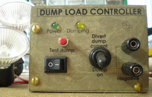

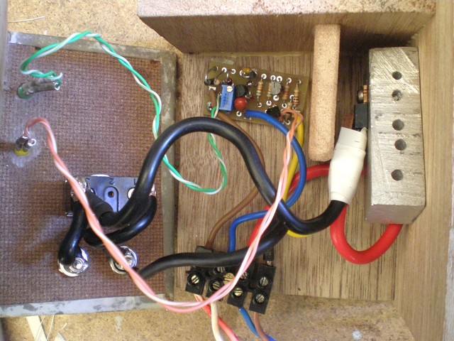

Here is the finished(?) box.  The impulse test switch connects a 1K resistor across the centre pin of the ZM and the bottom of ZD1.  The divert allows the current through the dump to be measured (or an additional load to be connected in series).  The two 12V 50W downlights (in series - 24V system) on the left are the current dump load.  The on/off switch allows the circuit to be off, to avoid the small drain on the batteries.
« Last Edit: November 26, 2007, 08:33:09 AM by South Easter »

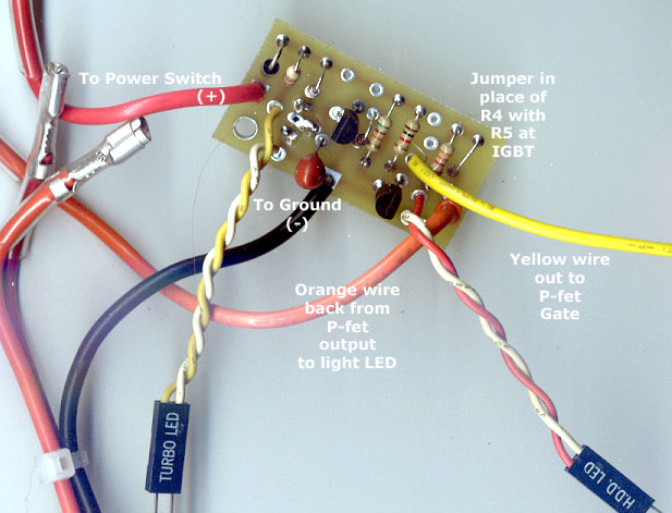

« Reply #50 on: March 31, 2008, 08:54:26 AM »
  Thanks for all your help those last few weeks on my IGBT remote dump load project, Ghurd!!!  It's working out just fine so far, NO magic blue smoke has escaped yet and I don't think it will any time soon!!
 For anyone interested in the full story:
 http://www.fieldlines.com/story/2008/3/31/141234/584
Blessings, Snow Crow

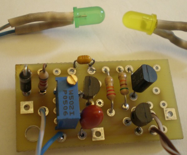

I need little help, i want to make this circuit but i dont know what is the little blue box on the board:
Re: Dump Control / LVD Circuit
« Reply #54 on: May 26, 2010, 04:36:23 PM »
Hi! I'm new on this forum and sorry for reopening old post.
electroman;
That is a multi turn 5 K potentiometer. In the schematic it is the one that adjusts the voltage setpoint.
Glen might pop in and explain. His website with much info is over here: http://www.ghurd.info/

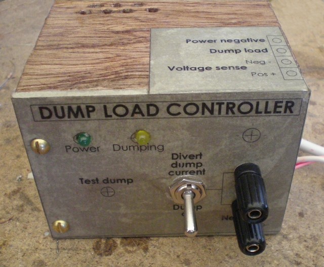

And, I would like to report my Ghurd Dump Load Controller modified for 24 volts to drive some big IGBT bricks is working fabulously.. It dumps about 40 amps and can regulate my bank easily keeping it between 28.6 and 28.8 volts with a KW coming in. So you folks at 24 volts can use it, too.
This is the load (4 .800 ohm power resistors in series / parallel for a .800 ohm load. Yeah, I know its actually 1037 watts at 28.8 volts:

Hi Electroman,
Tom is correct.
It is specifically a 5K multi turn pot.
It is very important to be 5K. It is very important to be multi turn of at least 10 turns.
There is a lot more happening in there than just a voltage divider, and if it is not correct the rest of the data will not apply.
