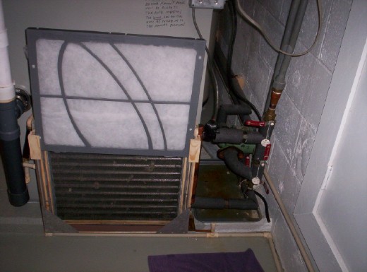

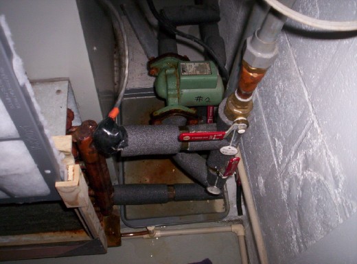

Yes, using ground water will work great, at least it dose for me, I have a flowing well that dumps 1000 gals an hour into our pond, It is a 4 inch well that I drove down myself with a 200 lb slide hammer, using my tractor pto with a large pully for raising the hammer up and down using a rope.
The well is only 50 foot deep. I have a 1 1/4 inch suction pipe for our water system inside the 4" along with a 3/4 inch pipe that goes into my basement thru a heat exchanger radiator. I did install a small grundfos pump in the line, to move the water faster.
The water temp is 40 degrees year around. I run the forced air fan and the pump with my wind turbine. the water exits the exchanger at 45 degrees.
The heat exchanger is installed in the cold air return of my furnace. I also use the same heat exchanger in the winter from my outdoor wood stove to heat the house.
when using the cold water, the condinsation water runs to a floor drain,
We have had 90 degree weather, and 90% humidity this summer, and we enjoy 68 degree temp in the house.
It removes enough water out of the air, that it will shut down my dehumidifier.
After the water goes thru the exchanger, it than goes back to the underground pipe that runs to our pond.
My house is not super insulated, and is of 2X4 wall construction. We are very happy with the setup, and most important, FREE.

here are a couple pictures of the exchanger on the cold air return of my furnace, and the piping comming into it. The top gray lines come from my outdoor stove, and the lower lines come from well. I have raised the filter to see the exchanger. It is rated at 125,000 BTU.
As you can see, I do not have the house cold air return ducted, the air simply comes down the basement stairs and goes into the furnace thru the exchanger radiator.
