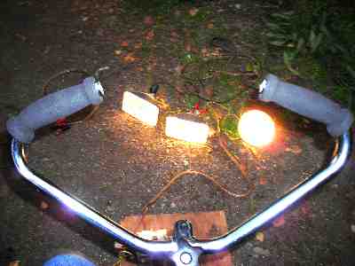

sence i like to hike and bike--i coud'nt help but build these...there just exersize bikes--with bike rims installed-then a flat belt for power out...
might give some of you guys some ideas...
first one is a stock car alt--no mags..theres a small amout of magnatizem left in the rotor to get things started. its good for how many amps your strong enough to put out.
heres three 50watt car headlights....i did get up to 24v with a 28v 400watt aircraft landing light[no easy task]..100watts is real easy at a slow pedal rate..
heres a treadmill motor 1.5hp dc --ive used it a few times to jump start my motorhome..
same three bulbs hooked up [lights look a little dim because of the camra flash]
last is a 0.38hp ac 280-400?volt motor conversion--puts out a easy 110v ac at a slow rate of peddling..works great for floresent lights[heres two 40watt bulbs]or a 110v ac color tv.its wired right now with all 3 phases in series..i can also wire it with a rectifer for each phase--then wire those in parelle--good for about 280watts..dc..[the tv is a easy pedal-so far ive watched a 1.5 hr program]

Any tips or Do Not Do list to consider before hacking?  The automobile alternator is the place I would start.  I have all the part laying around, and can frame it up with unistrut.  (I love that stuff -- erector set for electricians).  But your plywood board looks very stable and probably safer around toes, as well.
I guess with the automobile alternator you use the matching voltage regulator?  And I guess you do not use a battery to make the voltage stable?  I would sort of tempted to put a battery in it, or at least add a large capacitor.
What RPMs do target the alternator to turn at?  Typical automobile apps are something like 500 rpm minimum up to 2000 rpm at nominal running speed?  Does that sound correct?

hey phil...
no regulator is needed--i just use a taillight bulb hooked up to the field clip on alt
and the batt. lug on alt..that gives more than enough power to the field coil-maybe
even a smaller bulb would even work[the less field stringht the easyer to pedal]
heres a post i made a while back-plus video...there i had a 30watt headlight hooked to the field coil--i changed that to a taillight bulb--makes it a lot easyer to pedal under load...
          http://www.fieldlines.com/story/2007/7/31/93955/8934
« Last Edit: September 01, 2007, 12:59:12 PM by hiker »

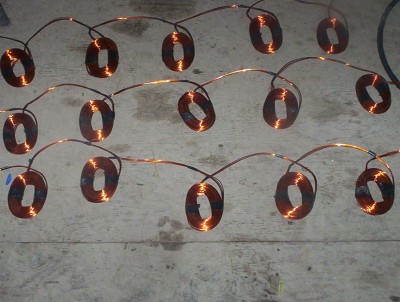

heres my old 12"dual rotor mill 8 and 6 combo--used the pedgen as a test bed..
never did get a chance to fly it--blew up when i tried to power up a 400watt
aircraft landing light[real close call]!!!!!!!!!
