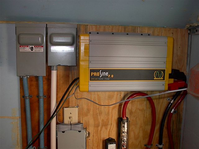

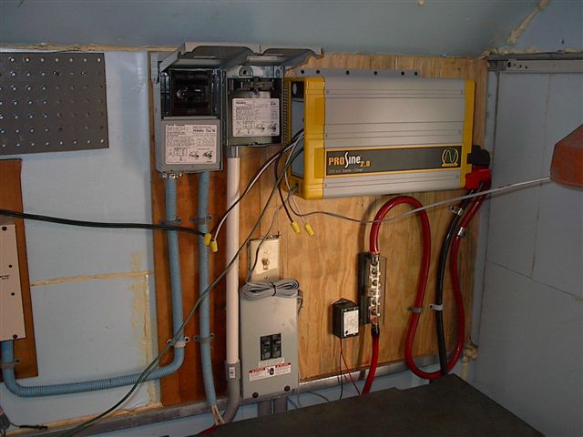

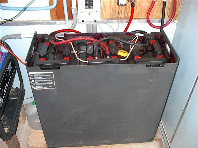

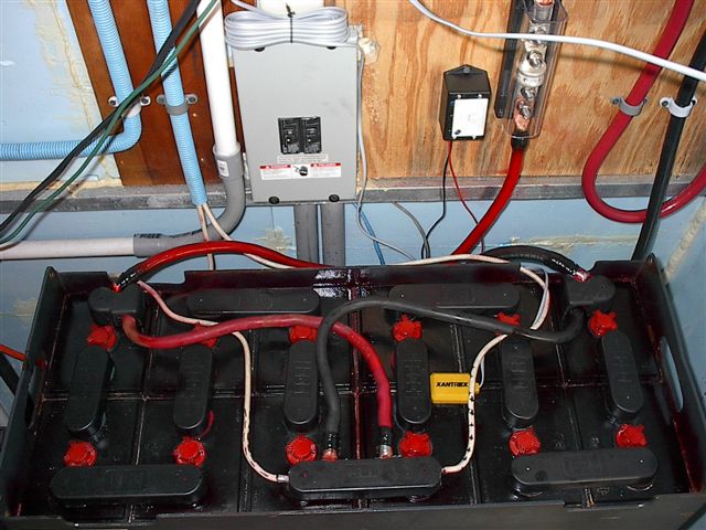

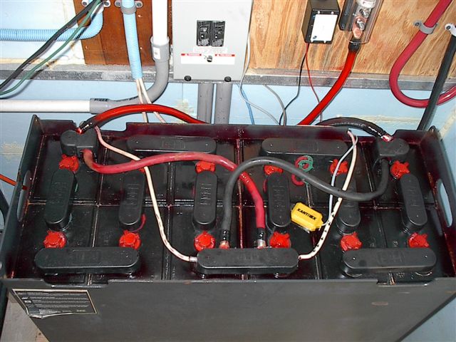

I took some pictures today to send to my brother in OK and thought I would post them as well. Making small progress every day, yesterday was the bus bar repair and connection to the inverter to make use of it's battery charger.
First three are my battery setup, It's a GNB 24 volt 750 AH that I wired for 12 volts to be able to connect the inverter that I selected. I finally began using the inverter to charge the battery and ran an Equalize run on it today and was getting almost 100 amps at the start. The hydrometer is almost to the Green line by only .25 or so. The battery seems to be coming up fine, I plan this weekend to connect the inverter to some loads and begin testing the battery to see how much capacity I can get out of it. Today, I turned off the inverter charger and allowed the two Solar Panels take over and they actually kept the battery at 13.6 volts all day long without losing any ground. I need to look at the tracking mount as I don't think it's parallel with the sun exactly and the panels were only putting out about 7 amps. I still think I should get around 9 amps. During panel building, One panel shorted was getting 4.5 amps and one was getting 5.5 amps, I ended up with a weak cell in the lower one I would imagine but it's sealed now. The two panels are in series, shouldn't the MMPT controller be able to still deliver the full power? I know normally the lowest current panel will hold the larger current panels back in series. but shouldn't it deal with that? Maybe I should try paralleling them? Just wondering, I may try that as well if I have good testing sun this weekend. Today was awesome blue clear skies and I had to be stuck inside working.
The next two are of my inverter mounting and a couple of fuse boxes. I eventually plan to Label everything for the "Visual" thing.

Nice looking setup. Looks very clean and professional.

Thanks Tom, It will look a lot better when I get it done. Right now I just have the inverter rigged to an extension cord to make use of the charger. As some probably can see I make use of everything and whatever is on hand.

Looks like battery set-up is right below this very clean looking system.
 I've read that the battery gases would be bad for the electronics and plan on keeping mine in a special area away from my electronics. (Wooden battery box for now,will be moved into chest freezer very soon as the nights are getting colder).

All comments are appreciated. My plans are to build a wooden box top for the battery with an air space and using a small 12v computer fan, vent it to the outside of the shed. Just not enough hours in the day to do all the little stuff. I read the Xantrex manual thoroughly and having it ingest Battery gases is a bad thing and actually gases in the shed at all will be bad. I have been leaving the door open for now. Just trying to get everything working.

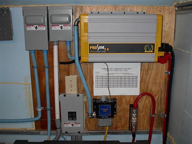

Here is a shot of my nearly final setup. I love to make things look good besides being functional! The only other thing I need to do is build the forklift battery vent. It's on the list of things to do, been cutting trees in the back of my property for almost 3 weeks now, time permitting, to get more evening sun. I was getting shade on the panels around 3PM and now, am almost making it to 6PM from what I have cut out. I will then move to the front yard to cut three more trees that are killing my morning sun. Then it will be back to building the other two panels. I have started saving up for four commercial panels and am planning on some around 170 watts or so. Found a website selling Evergreen panels that have blemishes for $2.94 a Watt. I can afford those and don't care if they have a few scratches or dents in the frame. As long as they make electricity, I'm good. Until next time...

Looks good.  What's on the sheet hanging on the wall?

Thanks, RP, I think I have come a long way since starting this entire project in July, I think. It's my temperature compensated specific gravity chart. I need to laminate it and stick it to the wall with something other than electrical tape and I would imagine after I get used to reading SG I won't even need the chart.
