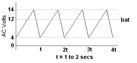

In my last diary entry, I noticed a relationship between AC Volts, current, and wind mill RPM. I think what may be happening in my system is something like this:
Genny volts is limited by battery volts.  When wind mill rpm increases, battery voltage limits RPM to 12 VDC.

One of my favourite songs is Pink Floyd's: "Is There Anybody Out There?"  I think I'm getting blade stall at winds of 3m/s.  I'm trying to add PWM to balance RPM and battery charge.  I'm using a PICAXE 28X1 as microcontroller, and input is ala thebackshed.  I'm not an electronic guru, I'm just a scientist.

 Kahoona- as no-one replied, I think the graph threw a few off. Now, I've zero experience with this and you likely know much more than myself, but the relationship between rotor RPM and voltage is direct. Once rectified voltage is clamped to the battery (12volt in your graph) that is where it will stay and current rises with more rotor rpm. You may well be running into stall based on the graph- voltage rises from 4 volts to cut-in at 14v, at which point the alternator loads and then drops back to below cut-in to start the cycle over. Looks to me that the blades and the alternator are not well matched. Thats my guess.

I agree.  Blade RPM and power are not well matched.  That's because in a moment of inspiration, or maybe a moment of madness, I upped coil configuration from 80 turns to 800 turns .  I've magnified everything by a factor of 10.  Instead of getting blade stall at 300 RPM , I get blade stall at 30 RPM.
Volts on the left are RMS values.  I'm trying to develop a PWM system to match RPM vs.TSR.

Your graph seems to be saying stall stall stall. You mention that you have upped the coil count by a factor of 10, so stall is inevitable if you clamp it to 12v.

oh and I had meant to add the graph is indicative to me of
acceleration without load up to 12v or so, then the battery and rectifier kick in and swamp the blades making them stall and decelerate.... then with no load again, they speed up... only to get kicked in the head again by the battery. So what you are seeing i think is a electro-mechanical triangular wave generator, as your blades gyrate between stall at about the time they may be just getting aerodynamic enough to make some lift, and then feathering stall as they go completely un-airworthy and without load, recover again.......just my take on it though

Battery and rectifier kick in and swamp the blades making them stall and decelerate .... then with no load again, they speed up... only to get kicked in the head again by the battery.
I think re-wiring the coils (option 5) is probably the best choice but it would be a pain to take everything apart and I'm stubborn (LOL).   I'm trying a PICAXE to add PWM and I'm trying different loads (duty) to get better aerodynamics.
