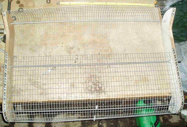

Here is a blade set with the wire on, ready for the fibreglass. These blades are just under 2 feet wide and each blade set is 3 feet tall, giving me an aspect ratio of 6:1
I'm using the threaded bar to stretch the mesh out so the mesh is taught, although the leading edge is still less than perfect. The holes that the rods pass through will be used to fit balancing weights.

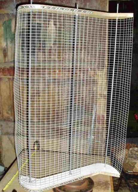

I'm not sure about how far the fibreglass shouldcome along each side of the blade, I have an overlap but it is not as big as some of the others that I have seen. I don't know if that will make a difference or not, although there is probably an optimum.
Here is a picture of the assembled blade standing upright.

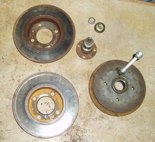

These blades will mount on to the bottom bearing and hub assembly which came from a scrap car, any advice on cleaning this lot and corrossion prevention would be gratefully appreciated:

I'm kind of curious how much the rotor will weigh when completed though. There's always talk about this or that design's efficiency but never anything on weight and how that affects things.
It seems to me that using fiberglass sheets would be easier/better than doing the fiberglass work yourself. Known weight, even thickness, smooth...something to think about for next time.

take your rotors to a brake shop and have them ground flat
 it will save a lot of problems later on.
if you use decent mags on those rotors it should make good power .
don't be surprised if you need more swept area to get out what it is capable of producing.
it may be wise to build in a method of adding additional vanes.
« Last Edit: September 30, 2007, 10:04:21 PM by electrondady1 »

I intend to construct the alternator using the two discs pictured, they have a diameter of 24cm. I intend to mount 12 neos, N38, per disc, they are 2.5cm x 2.5cm x 1cm. I intend to use 9 coils of 100 turns each, one in hand. My wire is 20awg (I think) so I'm aiming for higher voltage, lower current.
If I manage to achieve a tip speed ratio of 0.8 then I estimate that this mill will spin at 8 m/s in a 10 m/s wind, or 152 rpm. If I connect the windings in star I calculate that I will get 25 V ac @ 30Hz and a rectified voltage of 24V dc.
Does this sound about right to you?

A nice idea, but it may not go.  Around here it is illegal for brake shops to grind brake rotors thinner than minimum specs.
