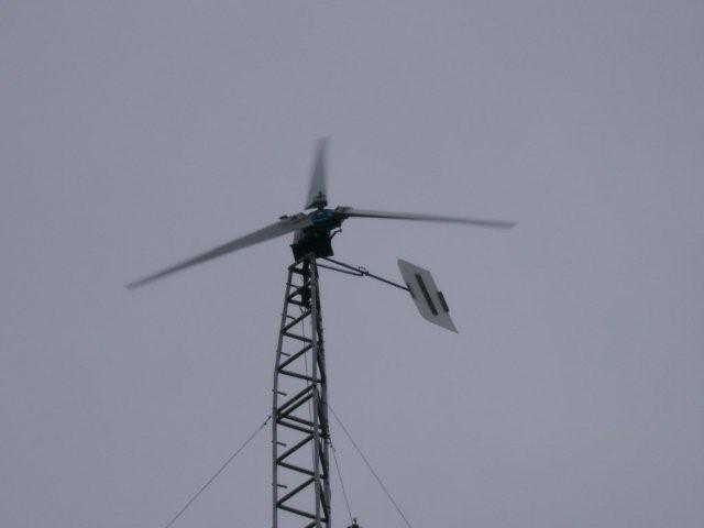

Same mags, same wire size, same # of turns. I added Yaw bearing, slip-rings and brushes, with a enclosure to protect it from the elements.3 wires down to large stud mounted diodes. You can see the link below if it works, or check my  FILES
Had to get a crane to set it on top, as its total weight was slightly over 400 lbs. I had several jinpoles laying around, but decided to go with the big stuff and be certain I would get to use it this winter.No time for mistakes now.
The finished generator sit at the bottom of my 100 foot tower for 2 months. I had balanced the blades on the hub previously and made notes of tip to tip measurements. The hub was then numbered, then the blades. I then took it apart to wait for a day to instal. The blades weighed 15 lbs each and the 16 inch hub weighed in at 48 lbs for a total of 93 lbs. I choose this method of blade attachment to make it easier to drop the blades to the ground, when they need refurbished in the future.
The tail was hoisted next. The tail boom is 7 1/2 ft long and 1 1/2 diameter sch 40 with a 1 1/2 angle iron brace going back to the tail hinge. The tail fin is 1/4 puckboard 3 1/2 feet tall and 2 1/2 feet wide. It,s super tough stuff

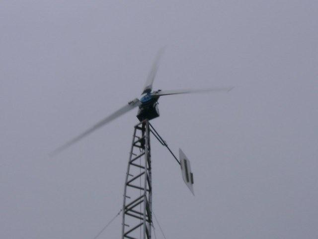

It,s been up for 4 days and I see the tail getting light at 15 - 18 mph when its, putting out 50 - 60 amps. A few times the wind gusting took the ammeter to 80 amps, then 90 amps a few times.  I did see one time 100 amps briefly from a gust. During those wind gust the tail was furling fully and stayed there til the gust subsided. The machine runs nice and smooth, no vibration. It makes a whoosh whoosh sound, according to my neighbours, and at 60 amps a whine that kinda makes you grin.
Not sure if I  will need to add a little weight to the tail. I will keep my eye on it and decide when I can get some stable winds without gusting.

I think I got my pitures sorted out. Previous were resized and fuzzy.This picture is showing the machine in a 14 m.p.h wind.
This picture is showing the machine starting to furl at 16-17 mph I have seen 70 to 90 amps during short wind gust.

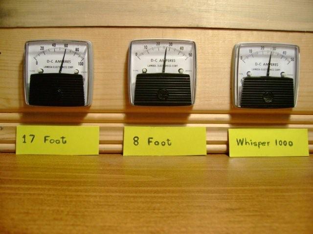

Next picture showing my amp meter set up thats upstairs where I can monitor it at a glance. I have digital amp and volt meters at the battery bank also. The 17 ft and the whisper 1000 ampmeters are both connected to my 24 volt bank of batterys and the 8 ft ampmeter is connected to a seperate 12 volt bank.I have been fine tuning my meters and are reading similar readings,not perfect yet but very close. My only windspeed indicator is a anolog Danforth/White approximately 4 in diameter,2 scales 0-25 and 0-100  It,s almost as old as I am.
