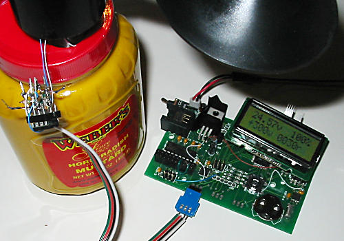

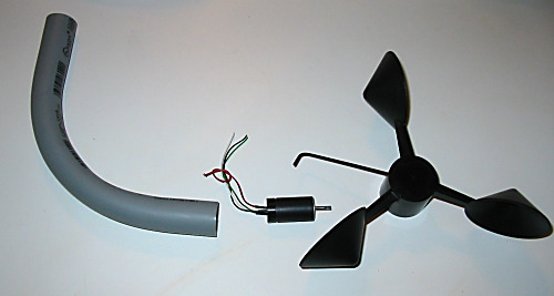

I started to build an anemometer so that I can get a better handle on how well my mill is performing.
I bought a cup set from our host and dug out a pair of little servo motors I'd had for some time -
The motor has a 3mm shaft. I ground a little flat on it, drilled the cup hub out to 1/8" and put in a set screw. The motor was just a little smaller than the ID of 3/4" schedule 40 PVC so that looked like a good mount.
I opened one motor, looked up its controller chip and figured out that the back-EMF taco function should work even without the motor being powered... it did but I didn't get "good" readings at low speeds. The control chip claims a "divide by 2" of the commutation speed and a "de-jitterer" ... the taco wire doesn't really give linear pulses until about 200 rpm but it did look like it might be consistent at lower speeds so I moved forward thinking I would work it out in calibration. But outside in the wind though, I didn't get any readings at low speeds. (Inside, the cups turn consistently at walking speed but the taco doesn't give a reading at all.)

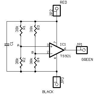

Plan B:
I dug under the chip and saw what looked like a three phase motor. I pulled the controller board out and put my meter on two wires. Each phase is about 10 ohms and makes about .1 millivolt RMS at 100 RPM. (That's pretty good power!) I "dead-bugged" a little opamp circuit onto an 8 pin wire wrap socket -
And wired it up to one of my little microcontroller boards.
Yeah! Most of the display is dummied but the 0030r (30 RPM) is a live reading. Also, it reads 12 RPM walking briskly inside. I was counting; it did seem to be taking about 5 seconds to make a rev... I do see why a "de-jitterer" is needed because I do get spurious readings when it's jiggled.
I'll try changing one of the resistor values a little on the theory that when the motor is not making voltage that it will pull one line a little bit away from the other. I'm not sure if that will get rid of the jitter or just move it to a small rpm. I also know how to do it in software so I can do that if I don't find an electrical solution.
Tomorrow I'll calibrate and then get it in the air.

The opamp configuration is open loop with balanced input. Any system noise well be amplified at the full gain of the opamp resulting in noisy output. Best to offset the input with a little negative feedback like a 1M ohm, connected to opamp output to neg input should help with the jitter.

Op amps should be used with feedback from the output to the negative input.  When connected that way the positive and negative inputs have essentially the same voltage due to feedback.  You can then figure out what the gain would need to be to cause that balance.
Op amps set up this way have very high input resistance, which is good for sensing a pickup coil that pushes little current.  Given that you want a digital pulse and high input resistance, a low voltage MOSFET would do just fine.  Protect the gate in the usual ways - cap and resitor.  The coil might need some extra turns to activate the gate.

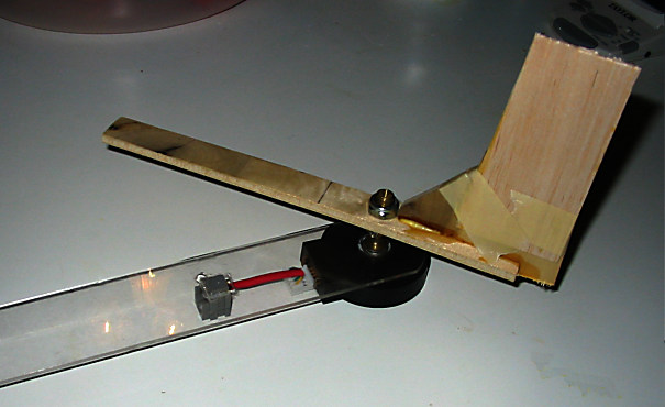

As I see it, it looks like it needs an inner an outer shaft to get the moving parts around the wires. Am I missing an easy way around that?
Meanwhile, here a stick on an encoder on a stick...
I already had the encoder mounted on the lexan arm (feedback for a motion control system) and I obviously didn't take a lot of time making the vane! It's not a ball bearing encoder so it has a light static drag and take about 5mph of wind to make it point. It just so happens that my little controller board has a port that matches that plug so I think that the mark-1 wind vane is done give or take a coat of varnish... the rest of the idea was to put a magnet on the vane and a reed switch on the arm for automatically synchronizing the pointing.
Overkill: that's a four thousand tick encoder. I found a sixteen tick "rotary position indicator" on Digikey for $2.58 USD. The torque was given as ".5 to 3 oz-in." The high side seems high, the lower end might be okay. I put one in my shopping cart for the next time I make an order there. Mouser had some hollow shaft continuous rotation pots for a little over 2 bucks each. I could probably point the dead zone east and never notice it (as opposed to using two of them.)
Okay, these are schlocky solutions but I have to get back to figuring out what's up with my MPPT booster!
