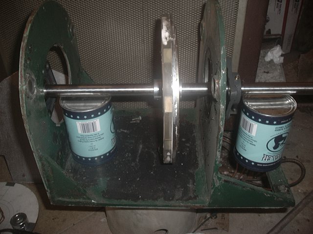

« Reply #4 on: November 12, 2007, 05:14:29 AM »
My Re mate did this (duel rotor), the centre magnetic rotor was of fiberglass, needless to say it failed quite spectacualy, Ok it is fair to say it was flying at my place when it failed.
You must have a solid steel centre magnetic disc as flux said. It has been discussed that a larger diamiter unit would be more cost effective magnet wise.
But we all are free to experiment as I do, sometime I win sometimes I loose but I have fun trying.

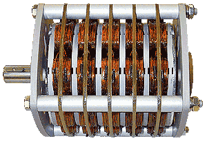

« Reply #6 on: November 12, 2007, 07:37:12 AM »
I had this pic posted a while ago. Hope it'll provide you with some ideas.
Powerbuoy
« Last Edit: November 12, 2007, 07:37:12 AM by powerbuoy »

« Reply #7 on: November 12, 2007, 11:09:34 AM »
I wonder how hot that thing gets without even having open sides on the center rotos let alone the stators.......
I've been following the design concepts and issues of the axial flux design for a few years......and things have changed an awful lot, as each problem has been dealt with......and heat buildup in the stator was one of those problems....
« Last Edit: November 12, 2007, 11:09:34 AM by ZooT »

Allen
May I ask the reason this failed ? Did the composit magplate fly apart ? Thats one thing that concerned me on even the steel backed plate . I was thinking of a round ring of somekind going around the outter dia of the magplate to help insure this didn't happen .
Please advise why this failed . Was it the disk comming apart or was it a problem with rubbing assotiated with alignment problems , heat or something else ? How long did it run and how did it do while it was running ?
Thanks for the post Lonnie
« Last Edit: November 13, 2007, 12:16:32 AM by HomegrownPower »

I can't change the dia of the pma due to having most of the parts and need to use them to save the bucks of fabracating them . I'm going to do as Flux advised and use a steel plate with magnets on both sides .
I've already had to squeeze the 12 inch machine into a 11 and 1/4 inch disk . Thats primarly because of having 2 mag plates that size , the housing to mount the shaft assembly into and even a lid for keeping rain out so it just made practical sence to adapt the PMA to fit it . If I ever wanted to have a belt tentioner for different size pullies for different rpm's I have the cabinet the housing sets on already made for doing just that .
Since I'm throwing in all loose magnets on the place trying to use them I think I'll throw in the 8 neo's I had left over . That way I could put 4 neo's on each side of the center plate with two sets of the weaker magnets in between each neo.
With all 32 neo's and 16 groups of the other magnets almost the same size as the neo's it will have to have an incredable flux field . At least it seems like it would have to I wouldn't want my finger inbetween the plates lol .
Attatched is a pic of my toy so far . Looks like completion will be pushed back a week or so . I'd be interested in seeing this stack of coils you made if you could do that .
Thanks for the replys and have a good one Lonnie

Re: Stacking Stators in PMA
« Reply #18 on: November 15, 2007, 07:09:17 AM »
 some times we take on projects and they begin to have a life of their own.
we make a series of compromises that changes the original concept.
you are saying you have a total of 32 2x1x.5 neos ?
you can put them together any strange way way you like,
as long as you realize the optimum configuration would be to place
16 of each on two 14"steel disks.
the forces you are dealing with are not trivial !
please take precautions so that you are not injured.
i think its a mistake to mix neo and ceramic mags on the same disk as you describe.
looking at your  housing it appears as if the bearings are not as yet mounted permanently.
you could adjust there placement to accommodate larger rotors.
you already have perhaps $300.oo invested in powerful magnets
why not spend the $50.oo and get the right size rotors.?
« Last Edit: November 15, 2007, 07:09:17 AM by electrondady1 »
