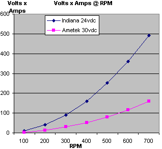

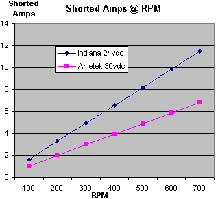

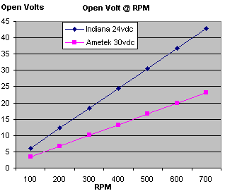

Hi guys,
I think Indiana 24 is a far better generator than Ametek 30 (three times more "open volts x shorted amps" than Ametek 30 at any RPM).
Here are the open volts and shorted amps for both motors:
Ametek 30 (4" diameter, 4 7/8" long):
RPM   Volts     Amps
100    3.36        1.00
200    6.71        2.00
300    10.07     3.00
400    13.24     3.95
500    16.60     4.88
600    19.92     5.85
700    23.24     6.83
Indiana 24 (4" diameter, 7 inches long, labeled 24V, 0.5 A, 375 RPM):
RPM    Volts     Amps
100    6.12        1.64
200    12.24     3.28
300    18.36     4.93
400    24.48     6.57
500    30.60     8.21
600    36.72     9.85
700    42.84     11.49
Here are the graphs:
Open volts versus RPM
Shorted amps versus RPM
Open volts x shorted amps versus RPM

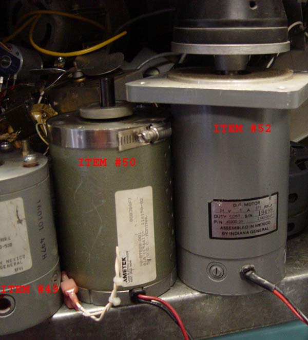

It's the one on the right side, marke as item #52:

Thanks for the photos! No wonder it pushes more being considerably beefier.

It looks more like an Ametek 99, which costs more than a standard Ametek.

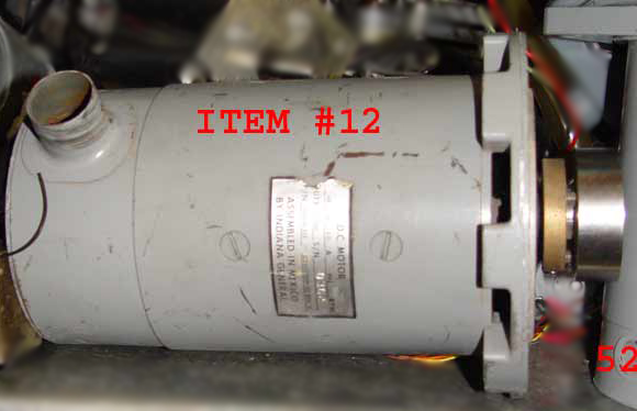

Yes, it's beefier, but take a look at Indiana 48 (labeled 48V, 3 Amps at 840 RPM) compared to Indiana 24. The 48 is on the left and 24 on the right side.

coldspot,
Indiana 24 beats your price per output big time in the range of 240-450 RPM.
At 450 RPM, Ametek 30 just starts to make some usable power.
Indiana 24 starts making usable power at 250 RPM, and it makes roughfly 180 Watts at 450 RPM.
Until 450 RPM, Ametek 30 motors are expensive decorations.
