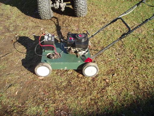

         Many years ago, it was customary for the Hydro company
to dispatch several crews of linemen to clear away dead trees,
branches and other dangers to their lines. These days cutbacks
have eliminated this practise and the first snow storm will cause
many power outages. I live in a rural area and this problem is
even more severe.

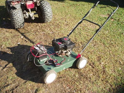

From info obtained from this site, I built a backup generator.
An old lawnmower that I bought at a yard sale several years ago.
$20.00. The engine is a 3.8 HP Tecumseh and I bought a new plug
for it, changed the oil and cleaned the air filter. I fitted with
a 4" pully and purchased a Delco 37 amp alternator from the local
wreckers. $15.00. I had the pulleys and an old belt. I took the
old mower wheels and handle and mounted everything on a scrap piece of
3/4 " plywood with a 2x4 frame. I also had a small walmart battery
and some used cables. I plan to get a better(bigger) battery for it.

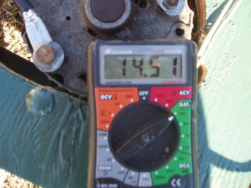

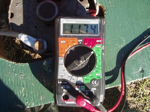

Before I started it today, I hooked up my voltmeter.
Started it up and turned on the handle mounted switch.
I can hook up my little inverter and run a drill or a grinder.
My main interest is to power my fridge or computer. It will do this easily.

Looks good. At least your food won't go stale if you have an outage.

Hahah.. but seriously thats a nice set-up you have there. Hopefully you won't even need to use it but, its there if you do.

By the way, nice setup, Fiddlehead. Its nice to have the amenities when the rest are sitting in the dark.

A website with stuff like this recommends putting several light bulb sockets in parallel. Insert 100 watt bulbs until the voltage dips slightly, and this will give you an accurate mark of actual max output (some inverter losses, etc)
