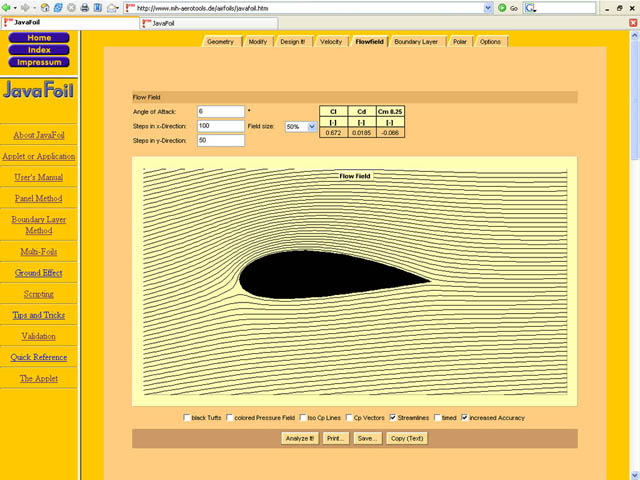

To visualize what may be happening for wind turbines, I have used JavaFoil which is a GUI modeling program
Here is the flow diagram of a single NACA4425 airfoil at an AOA of 6 degrees:
Here is the same airfoil doubled up as a "jib/mainsail"
note the small window showing numbers for Cl and Cd ..also note the flow pattern in between the two blades and the point at which the lower blade would start to show "flow separation" on the topside ( hint ..it is laminar in between the blades)
I have a lot more of these images (and higher res) at diff AOA and diff spacings/lead of multiple blades:
http://s145.photobucket.com/albums/r203/scorman1/blade%20design/flow%20diagrams/
That JavaFoil program generates Cl,Cd and L/D in chart form for any AOA and RE#:
http://www.otherpower.com/images/scimages/7526/NACA4425polar.txt

One issue with your simulation is that the jib is normally not the same shape or size as the main. The slip between is also adjust depnding on the wind angle and conditions. A turbine with a jib blade would always be tacking at the same angle to the wind so the slip and size of the jib blade could be fixed.

You seem to have missed my comment about the fast moving air foil affecting the air flow when it is doing work.  Can JavaFoil deal with that?  In the extreme, all the work done on the air foil due to the pressure differential would end up going into countering drag.  We need a solution somewhere in between, where we allow some external work to done.  It would be interesting to see that kind of simulation.  I suspect the flow lines would break down very quickly for say a TSR of 7.  That's where the pressure differential across the wind turbine would come into play.
As far my analysis is concerned versus Betz', I can only go on what I read.  My Model doesn't need a spreading of the air flow down stream.  Half the flow is through the turbine.  The rest goes past.  There is no problem with the mass equation.  Both flows could continue down stream indefinitely.  Of course, they won't.  But that's no concern.  What matters is what happens at the turbine.  Mathematically, to find the maximum or minimum of a curve you differentiate with respect to the variable of interest and set the result to zero.  That's what I did.  My result was 10% higher than Betz'.  Well, nice if it holds, but it may not.  The assumption that the speed of the air flow just beyond the radius of the rotor, which determines the pressure behind the rotor, satisfies a linear equation may be faulty.  Rather than being linear the curve may belly up or sag down.
As far as measurements are concerned, there is no reason that one couldn't measure the pressure distribution in front of, along side of, and behind the rotor.  A multi stage manometer would be useful for that.  Those are expensive, but one could build their own.  We did stuff like that on a summer job I had one time.
