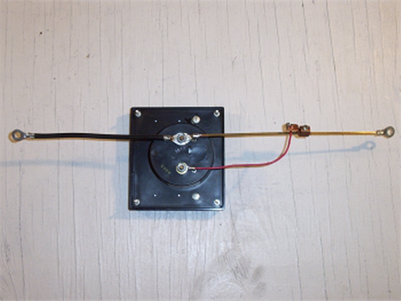

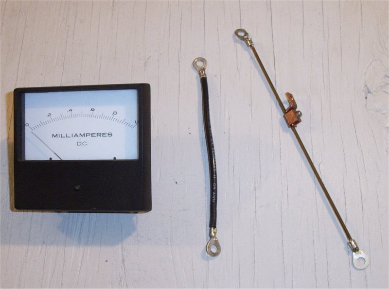

I have struggled with trying to calibrate and reuse old milliampmeters for years.  Calibrating them for a known current is tricky.  Paralleling up resisters has never worked for me.
I have finally figured out a way to do this very simply.  Starting with a 1 milliamp meter (full scale).  I attached a piece of brass model railroad track (because that's what I had) with eye terminal on it to one bolt of the meter.  A screw cable- end that will fit over it provides the calibration slide.
Attach a small wire from the screw cable-end back to the other post on the meter.
Get your polarity right.

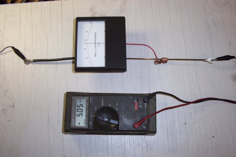

Give it a known current.  5 amps in the picture.  Slide the cable-end on the brass until you get the reading you want tighten it down and your done.
Make sure you solder all your joints to reduce resistance.  It only takes a few tenths of an ohm to screw you up.

#10 copper wire works pretty well, too.
About 1 millivolt drop across one foot per amp of draw thru the wire. I figure good for 30 amps continuous and 50 intermittently.

Pretty Slick.
I wonder about the resistance of the test leads and clips.

It could be done the same way with a little more care to get more accurace but I'm pretty sure it's close enough for these tired eyes to see on an analog meter.  Sure is a simple way to use up some of these old meters though.

Having the meter connected to a current terminal is bad practice. Shunts should always be four terminal. At best a bad connection leads to errors, worst it will kill a meter.  Solder a separate connection for the meter.  Instead of the slide connection, solder a wire a wire a a distance longer than you expect to need. Then use a 100-500 ohm pot in series with the meter to calibrate.
