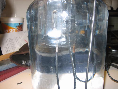

I was messing around a bit with electrolysis the other day.  I see a few issues regarding the storage and handling of hydrogen.  It has a flamability range of about 4% to 75% concentration when mixed with air.  You need to ensure that you keep it fairly pure.  From observation, this does not appear to be a problem on the hydrogen gas collected above the negative electrode.  I would be a little bit more concerned about the oxygen from the positive electrode, however one could just vent that I suppose.  Also, you pick up a lot of water vapor, and a bit of your electrolyte with the hydrogen produced and mist picked up in the electrolytic tank.  I read about one project on-line, although I can't seem to find the link right now, where they ran the product gas through a water column bubbler, then a catalytic chamber to recombine any oxygen present, and then dehydrated the gas through a dessicant before storage.  I believe it may have been an old Homepower article.  You will need a way of filtering this and maybe dehydrating the output.  It strikes me that you may be able to design a tank geometry capable of generating substantial pressure, based on weight of the water above.  one other option would be to use a pressurized tank to perform the electolysis.
Here is a small tabletop experiment with a sodium hydroxide solution.  by fixing the collection tube, hydrogen could be easily pressurized to the equivalent water depth of the container.  It would seem that modest pressures could be obtained just by having a tall cell.  Still, at modest pressures, it would take a large storage tank to have a significant energy storage.  Have fun, Rich
