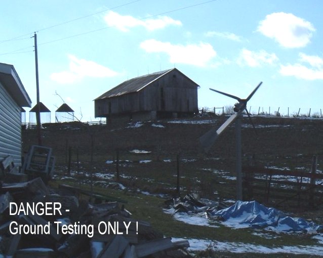

Hello RE-group folks,

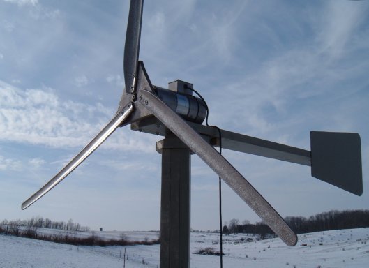

Here is the latest on my recent Low wind Leeson DC motor Hawt windmill. It actually exceeded my expectations and I am VERY happy with it.
It was discussed here:
http://www.fieldlines.com/story/2008/1/7/3321/39833
 I needed something quick, easy, and effective primarily in the lower winds for consistent daily power, and I must say I like it alot.  I was going to view this one just as a 'Back-up extra windmill' for a temporary use, but it is better than I had thought. Of course it is not as efficient as a brushless alternator with efficient wood blades though. (And I am using the nice alternator I had made previously for a Lenz2 Vawt) So I needed something quick and easy for a HAWT.
I am pleased with the results so far. Over the last few days it is doing an approximated average of 1200 WATTHOURS each day! Here is how I approxiamated it:
I have two 12v 115AH 'Marine/RV' batterys. Each night, I watch ONE HOUR of TV (140watts including the inverter usage)  from EACH battery. (2 hours of TV total)
And a few hours of 10W lighting also. It equals 300 watthours total that I take out of the two batts each night.
The next day, it only takes 3 hours to completely charge EACH battery fully. So this mill charges both batterys (300watthours total) in 6 hours.
Therefore, since there is 24 hours in a day, thats 300 x 4 = 1200 Watthours.
It generates good at night also, even though the breeze can sometimes be alittle less than daytime.
Yes, I think it is at least 4 times better than my small 4 foot mill above my roof. (maybe even more considering all things)
I painted it brownish grey to blend in better with the background and to be MUCH less noticable from the road about 1000 ft away. (and the neihbors)
Once the snow melts again it will be practically invisible. The blade rotor diameter is 6 feet and 9 inches.  It is only being tested now on a 8 ft. wooden pole because my truck brakes need work (again!) and so I couldnt get the steel pole/pipe yet. I had to make the tailboom and furling out of a wooden 2x8 for now.  I plan on putting it only on a 11 foot high pole primarily for looks and since the electric lines are fairly close and since I actually want it to be as 'unnoticable' as possible. These electric lines unfortunetly go down our back proper line (instead of out at the road)
This is the back side of my house and the dominate wind direction as you see the mill aimed. I live in a very hilly valley type location. So there is alot of 'up and down' wind gusts especially down near ground level. Its like a constant roller coaster effect.
And obviously because the mill is lower to the ground and at the corner of my house. So the main (Best)direction of the winds is down this big valley (not shown to the right) where 40 head of cattle are kept, and also many times from the direction of that big barn on the hill in the first picture.
I am actually amazed at how good the wind is hitting my mill. I do not seem to see THAT much turbulance.
We actually live on the side of a big hilly valley. So the wind from the direction of the house is non-existent anyway-- since it goes up a very long big hill, hundreds of yards long, with many, many trees, barns, farms, and some houses.
But from the dominate direction(s) it is almost always generating something.(1-3amps)
Maybe the curvature of the PVC actually help with this turbulance?? I don't know-- but I think it is doing great.
Often times, the winds seem like they may even 'push off' the back of my house (to the left) as you see in the photo and then hit my mill effectively. This may even make it better in low winds this way? It sure seems possible. But of course, we all know the fact that the higher you can put a mill in the air the better it will perform.
It is nice that the dried out weeds along the fence will be barely moving and the mill is still generating alittle something all the time.  I must say I LOVE MORE SWEPT AREA !!! Can go wrong with more swept area!
The smart, experience guys keep saying that time and time again, and they're sure right.
The YAW AXIS is simply a 6" long 1/2" bolt that goes all the way thru with two big washers in the middle that have grease between them. It turns easily. I know, I know,,,I have to secure that wire!
I was surprised that the furling actually works! I quessed it perfectly on the first try. For this simple furling, I used two shed door type hinges for the whole mill to tilt back to a certain degree. You can see the STOP BLOCK I screwed on there so it don't go back too far. A big wind gust tilts it back automatically. I still need to put in a spring or big rubber band to pull it back down though. Didn't have time to do that today.
Anyway, it is usually doing 1-3 amps, but goes up to 7 amps when it furls at about 500rpm.  I am very pleased with the daily average watthours. I just need more batterys now.  I am going to take down "Passing Wind -200X" when a warm day comes. It is being retired. It was a great stepping stone, but this bigger one is MUCH better in consist daily watthours.
Any comments, questions, concerns, or wisdom, or advice, greatly appreciated!!

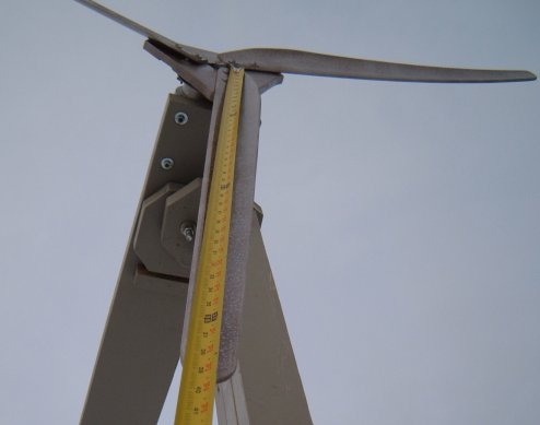

Sounds like you're getting good performance from those modified blades, I for one, would like a template of them!  If you get the time and are willing to take the trouble, a decent from the front with a ruler by the blade would be a help.  I'm still trying to find an ideal shape for mine, it sounds as if you have it.
I used tilt up furling on an earlier project, and there is a problem with it if you have winds that change direction a lot, which you may or maynot be aware of.  If the turbine is spinning clockwise (viewed from the front) and yaws to the left, the result gyroscopic forces make it tilt upwards and furl when it shouldn't.  But it yaws to the right during a gust, the reverse effect tilts the turbine downwards and stops it from furling or at least adds extra 'weight' that it has to overcome to furl.
Please insert the word 'photo' in there.  :-)

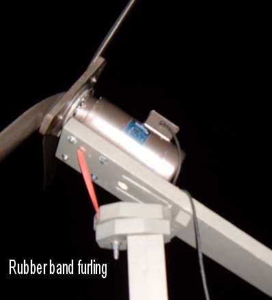

Happily, I have seen no problem with the tilt-back furling whatsoever. I know this sounds contradictory to what is commonly said, but this mill either has very little wind turbulance hitting it, or it 'handles' the turbulance extremely well.
It sorta 'freaks me out'.  It does GREAT even at this low level. I think I found a FAR better location than on my rooftop!
The YAWing is STEADY with this mill and its location.  Even though the Yaw axis turns very easily (especially with that long tail in a tiny breeze), the mill yaw axis stays good and steady in the directions. It does not ever move erratically, so therefore the FURLING also is working great.
I am VERY Happy with the furling. I quessed perfectly where I wanted it.
I went ahead and put the 'Rubberband furling' on it(until I can find just the right spring), and it works GREAT. Only took a minute to put on there:
ONly a BIG wind gust makes it furl all the way back.(probably 25mph+)
I have watched it furl many times now. It furls at about 6 amps which is fine. It still makes some power when fully furled.(I've seen 3 and 4 amps if the gust is big enough)
But sometimes it can take 30 seconds or more for it to come back down to the normal position after the strong wind gusts hits it and has passed. This seems to work out better this way.
I would rather it let the really BIG gusts pass by fully in the furled position , rather than the mill move up and down real fast.

I tightened up the big rubber band alittle bit since it was spending too much time in the furled position. Now it works perfectly! It comes back down smoothly right after the big gusts.(2or3 seconds)
 Today it is doing ALOT of steady 4-6 amps and now furls nicely at 7 amps which is when it begins to make the 'wirling noise'.
