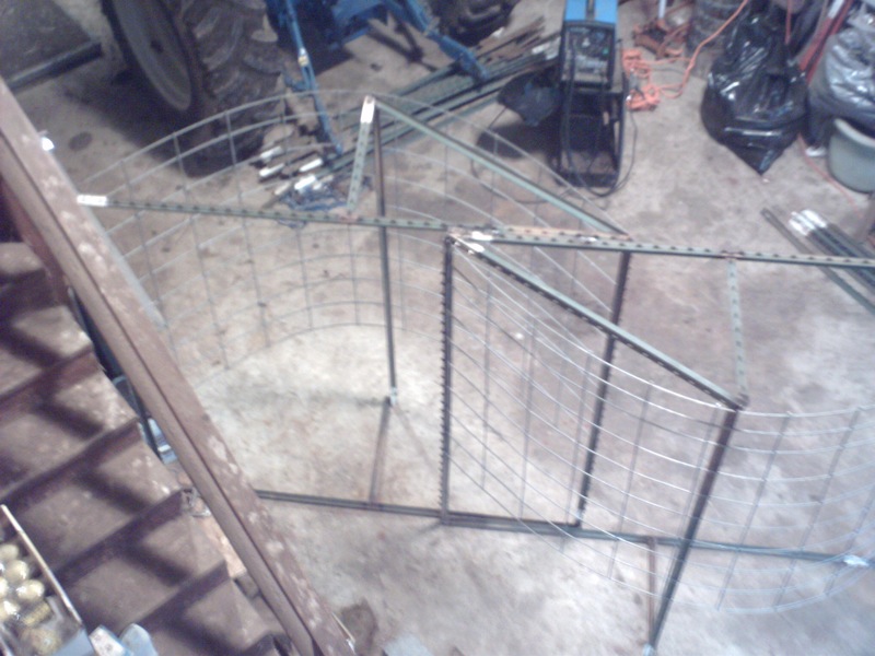

Here's the start of the first 48sqft rotor frame, it's just over 6' tall, 10' diameter...
Hopefully you can see the basic shape 'cause I used my kid's camera. The t-posts were relatively cheap and I had some hog panels laying around - I need half of another 7' long piece to finish. I'll probably use fiberglass sheets for the skin unless someone's got a better idea - thats one of those 'we'll see' kind of things for now.
The plan is to make another one of those frames (the smart way this time ;), and offset 'em 90°. That'd make it 96sqft and just over 12' tall. I might put the plastic barrel rotor on top just for kicks. Even if all I end up making is a self propelled merry-go-round, I'll be happy. It'll probably be a death trap in action but it ought to be cool.

My brother and I got most of the first rotor frame welded together last night. I just need to finish tacking the hog panels down.
I noticed that the frame has some flex to it but it's not too bad. I figure I can add a couple braces later if it looks like it really needs it.

Balsa model airplane wings have quite a bit of flex to them too until you skin them....

I made a 6x6' square test carriage yesterday afternoon. My boss had some 6" plastic caster wheels that he's letting me borrow for a bit. And today I clamped some metal siding to the rotor frame and took the whole thing out in the driveway for a bit.
Even though it was on gravel it was sort of trying to get away from me. I only let it move a few inches on its own and then the wheels got stuck and the rotor started sliding off the carriage because I forgot to clamp it down.
Test done, back inside. Looks like it ought to work ok to me. :)
