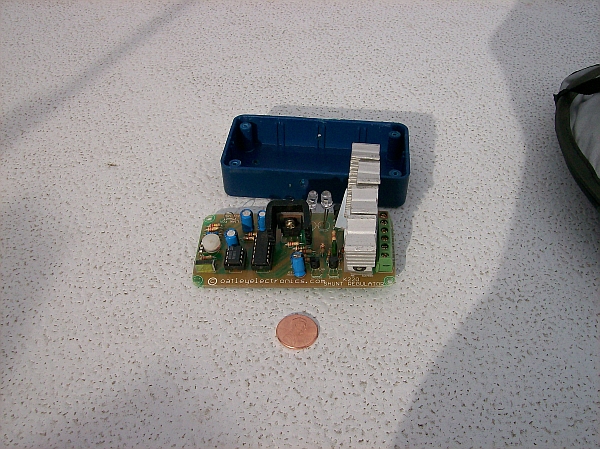

I'm finishing my K220
 But the "Dummy Loads" that the kit plans
call for building are just not my kind of
ideal set up. "Take some electric jug elements and double them up and cut down to 3.5 Ohm resistance in length".
 I make some from Ni-chrome wire from an old hair blow dryer but they just seem a bit on the whimpy side and I'd rather have something a lot more heavy duty. Just to be safe.

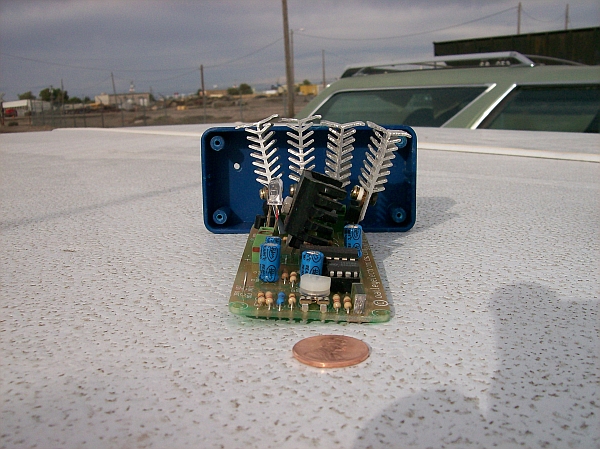

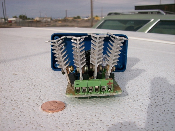

 Just look at the heatsinks I made for the MOSFETS.
 Without any they can handle a current of 7 amps.
left side view
Right side view
Side view

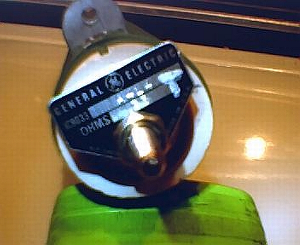

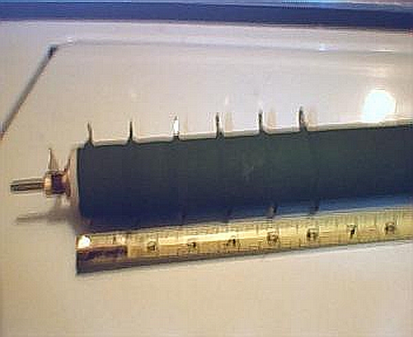

I did get an "General Electric","IC9033, A4L4"
Thats 33 Ohms full length,(12") but it has tabs and between any of the 6 closest together tabs,(1.25") are 3 Ohms.(12x12=144 divided by 3 gets 48 watts)
{or should I be using the 14.4 V?????}
 If I used the first set, skipped a resistance section to the next tab and used these two, then skipped again, I would have three but a wire connection between them all,,..?? Would I need to open this up by cutting the wire???? Or would this be OK to use that way????

« Reply #5 on: February 03, 2008, 07:50:55 AM »
Better.  Don't go cutting it up.
Not sure how many tabs are on it, but number the 6 closest together tabs #1 to #6. #1 is on the end.
Feed positive into #4, take it out of #2 and #6. It will dump about 4.8A, or 70W.
You might be able to use the last tab (15 ohms from it to #6?) as a positive, pull 3.4A out of #6, and 2.4A out of #2.
Between this one and the others, it's plenty for the Ametek and more.
I'm not clear on the math you show, and think you typoed it.  I use 14.4V.

 G.E. unit has 7 tabs total, 12"length
End with 6 tabs
Name plate
Tab 6 to 7, 18 Ohms
  1. to 2 = 6.8
  2. to 6 = 6.8
Thanks for the info on the GE unit
