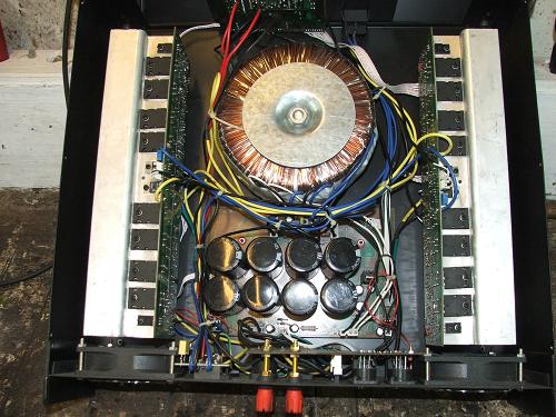

   there are times i need to put it all back again but this amp wont ever make no more noise.  yes im building a hummer .not a 4x4 . a wind gen.
  when i looked inside the amp i had so menny  thoughts   .
  i struck gold here i thought. but inside the big round thing was a steel ring .
  looked like a flat strip all coiled up . might make a good door stop in the summer.
   but i got a fair bit wire from it.  enough to make 8 coils.
 in the pics there are 11 coils. . other three were from sum thing else .
  as the wire is not all the same i will have to keep looking . till i can match up enough for five pairs . five phase .10 coils.

I am drooling all over that toroid...
« Last Edit: February 19, 2008, 10:20:36 PM by s4w2099 »
Chagrin
  • Posts: 195
Re: recycling copper for coils
« Reply #2 on: February 19, 2008, 10:42:15 PM »
That was my thought too. That toroid is (was) worth more than the value of the copper on it.

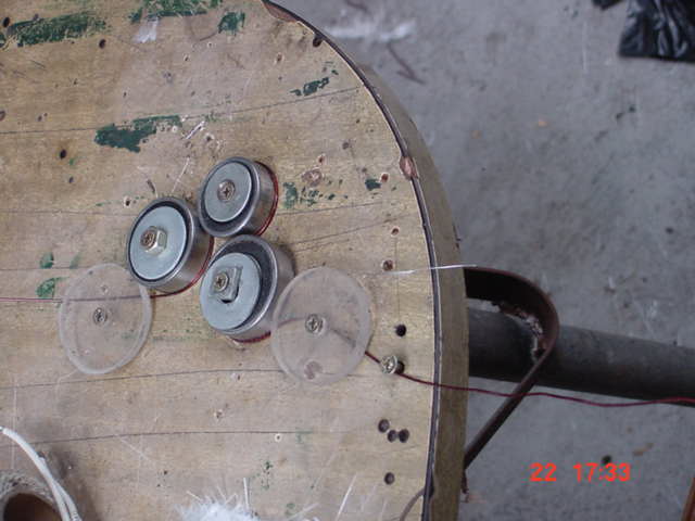

Looks like it's coming along nicely. I too have been forced to use recycled wire in a recent project.
I found that to get straight wire (straighten out the bends and kinks) that three 6203 bearings arranged close together and screwed onto the bench, straightens the wire without damaging the enamel. .. feed wire between and around bearings...(will post pics if you like ).

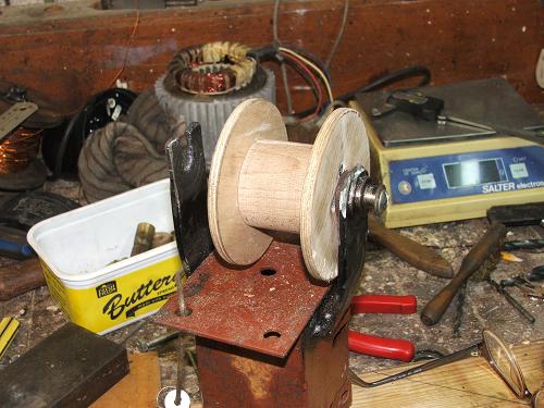

 what i do now is wind it on to a drum .right hand turning drum
 and left hand with big thick glove trying to take out the kinks.
 its hard work. it also starts to make my left hand hurt.
  so lets use our brains instead of brawn.

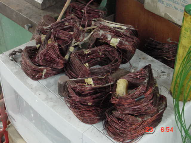

« Reply #11 on: February 20, 2008, 02:53:04 PM »

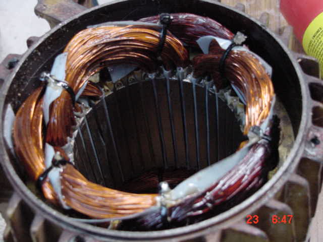

Yes I did it like that for a short while, and realised it was not satisfactory.
Here is a pic of the three bearings screwed to the desk. The large washers allow you to move the bearings for different tension and wire sizes.... just release screw pressure, slide bearings closer (more tension) or further apart (less tension, larger wire etc.)
The wire goes in kinked... and comes out straight, kinkless, and removes any loose varnish.... note I mean only loose varnish. It won't get it all off.

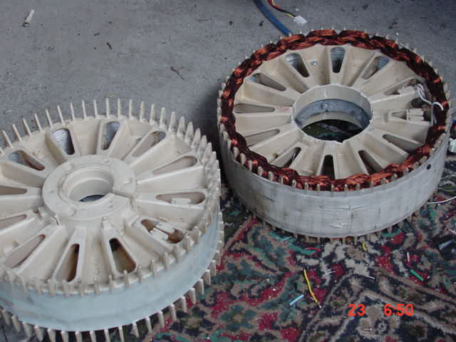

Here is where the wire came from. The one on the right still has wire, the left one has been stripped of the goodies.
and ended up in here.... 3KW 1440 3 phase 415v... emergency rewind for an industrial (Fish) freezer, and I had no wire the right size, but those plastic stators did (thanks to Bryan and Dennis). So my first rewind was a desperate 1 day learning curve. The sleeving paper was donated by Zubbly, along with the knowledge to do it. Without knowing him, I would not have dreamed of attempting this
Used fibreglass resin for the coils. I sincerely hope I never have to visit this motor again.... will be hell to get the resin out of everywhere.
There is more work ahead for the wire straightener I'm afraid......
Best of luck with it........oztules

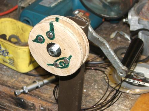

  i will add a few pics of my winding set-up.
  a heavy one to wind the loose wire on. then wind it again onto a small wood drum.
 then from there i can wind a coil.
