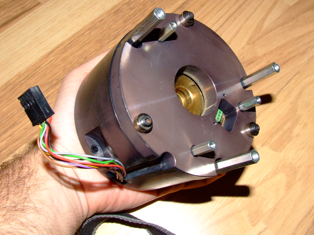

Today was a big day. The company I work for (printing shop) decided to clear out the old stuff that's been piling up in the attic for 10 years now. While this is not a big company, the IT dept was constantly updated so the old stuff went up.
About 7 Macintosh 6500, 9500, AppleWriter/Epson/HP printers, 21"/17"/15" monitors, one Linotype RIP, one Linotype imagesetter, only good old stuff ... So I delved in, scrounging nearly 100Kg of power supplies, circuit boards, motors, transformers, and one HUGE motor that looked like gold to me.

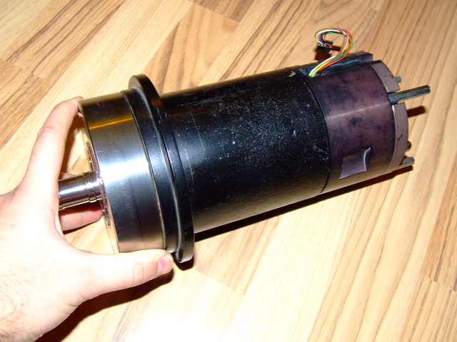

It had eight wires out, and it was the biggest stepper motor I have seen so far.

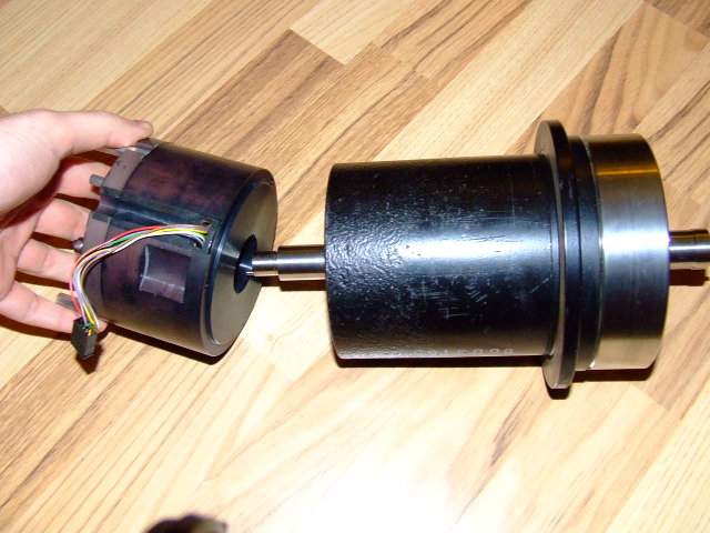

Took it home and dismantled it a bit. To my dissapointment the actual motor is only 1/3rd of its size. The rest is just metal. Heavy as hell, about 10kg full metal. Some magic bearing inside that keeps spinning the massive flywheel for minutes.

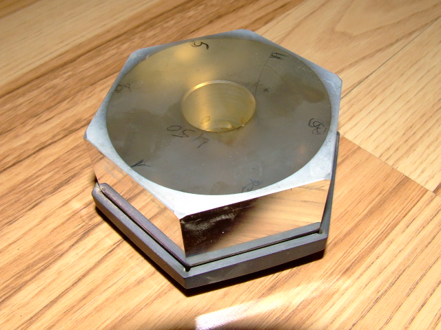

This motor was used to spin this hexagonal mirror and reflect the laser beam that was writing the photo-sensitive film. I guess the giant flywheel was for constant rpm.
The bad part is that the shaft is part of the big thing, taking the motor apart leaved me without the shaft or bearings. I could order that to be custom made but only if you think it's worth the trouble.

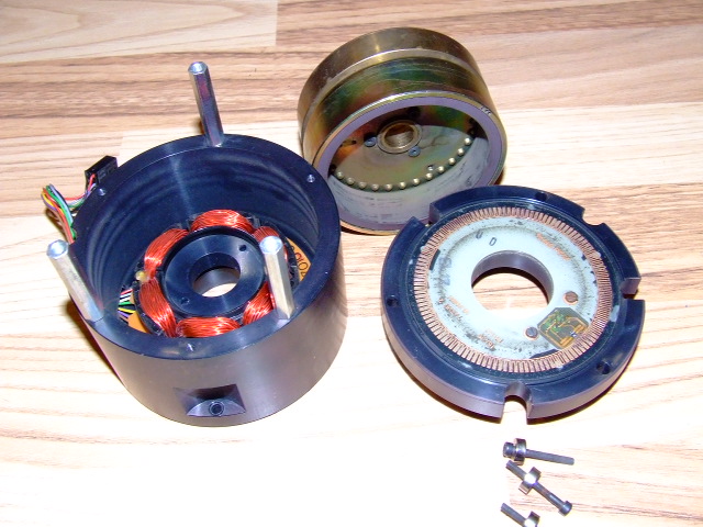

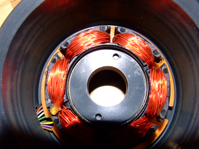

Taking the lid apart I found one tacho disk and the ring magnets on a circular armature. The 6 coils are wired with thick wire (about 1mm) and I presume the 8 wires are the coil ends.
The question is - is this worth the trouble of making a custom shaft and bearings?

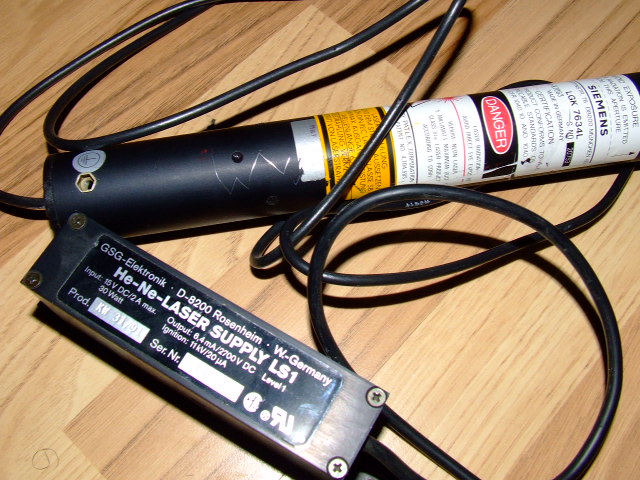

Another goodie was the laser unit. This is a class IIIa red laser tube powered from a He-Ne Laser power supply. Operating on 12VDC, it takes about 1 Amp to fire the tube.
I was thinking about using the power supply to light up a fluorescent tube. I wonder, is this wise? The 2700V output made me wonder.

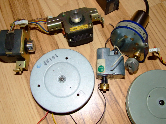

The wide assortment stepper and PM motors will sure come in handy for small projects. Many of them have gear-down boxes. There were also two old floppy units that I took apart for those cute little steppers.

I cant see any downsides to the big flywheel, maybe just leave it on and use it with that? Try spinning it at a known speed and see what voltage you get.

If you were to lift that big thing with your hands, you would surely feel the downside. The motor is made of aluminium and it's less than a third of that thing's weight. I'll ask a lathe worker to try and make me a new shaft. If the motor doesn't put out much power I still have place to glue small neo's instead of the original magnet ring. Hmm...

I would try the large motor like it is before considering making a new shaft.
Don't forget the degaussing coils in the monitors!
Might be able to rewind the motor with smaller wire from the monitors.
Anybody have any idea why 8 wires?

Maybe the large flywheel part can be dissassembled and just the bearings and shaft used, if it can be taken off?

Fungus, this is as far as one can go with dis-assembly. The flywheel is pressed onto the shaft. No visible bolts, no nothing. The outer case is casted in one piece. Everything looks like it's going to survive any power tool I can imagine.
To me it's a mystery why this very delicate piece of engieneering (The Linotype imagesetter) with so many sesitive parts (sensors/mirrors/reductions) needs something that looks like it's made for tanks. I am pretty sure this has on bearings at all. I dismantled something similar once (don't ask how, it was a full day cutting the case in half although that was way smaller than this one just to see the strangest thing - the shaft had no bearings just some conical holes for it, coated with some alien-looking stuff that featured no friction at all...

There are 8 coils. Maybe those are the coil ends. Or maybe not. I get strange readings. Three wires have 1.8 Ohms in between them and another three have 1.2KOhms in between them. The good news is that the coils are screwed inside the case, so if I'll get some fancy tool I'll be able to unscrew it and manually isolate coils.

The laser fires no problem :-) I'm trying to find a use for it, one that's better than driving the cats outside crazy.
I am afraid of that power supply. 2700V/46mA output. I tried to connect one 8W fluorescent tube and it worked but I only got about half the normal light. The wires were a bit loose connected and you should have seen/hear the sparks over there. Frightening stuff. And power-hungry too, it eats up more than one amp, steadily, to fire the laser.

I took a compass and checked the no of poles on the inner ring of magnets. There are four poles, NSNS, 90 degrees apart. I was thinking about replacing the magnet ring with 8 magnets (half HDD neo's) as the space alows that. What do you think?

The 8 magnets will short the flux.  Looks like 6 coils?  4 neos will cog a lot less than 6.

About the motor. Are you sure? 8 poles would short the flux? How come? There is plenty of space for 8 HDD halves, with about the same width in between them. I fear that 4 poles would require too much rpm to put out useful voltage. Also, I could skew those magnets to avoid too much cogging.

It would always have 2 neos over a pole at the same time, so the flux would run neo to neo along the top of the T... instead of through the coil, around the laminations, and out the oposite coil.
At least that's how I see it.
