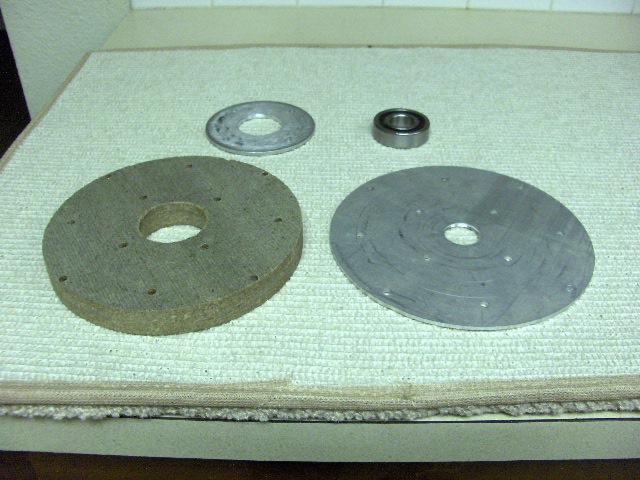

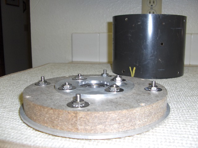

I've had a few people inquiering about the Garbogen assembly.
Prior to the fire last Jully I had hoped to try some end cap and magnet secureing upgrades.
Here are a few pictures of some new end caps I'm trying.
A few years ago I built a new deck for my house out of that plastic/wood composition material.
It works very well as a mounting base for the Garbogen.
We use a router circal tool at my store and that worked out very well to make round inserts from the material for the motor cans.
I used the same router tool to make a slightly larger plate out of 1/8" aluminum to use as a stop plate/bearing rertainer. Also made a smaller round bearing retainer for inside the motor can.
Here are a few pictures.

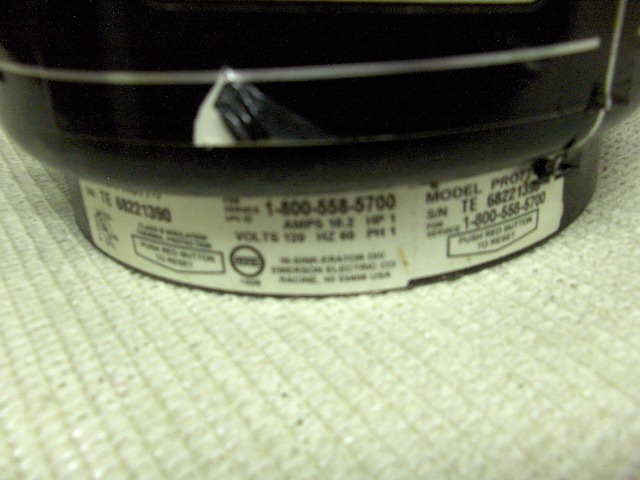

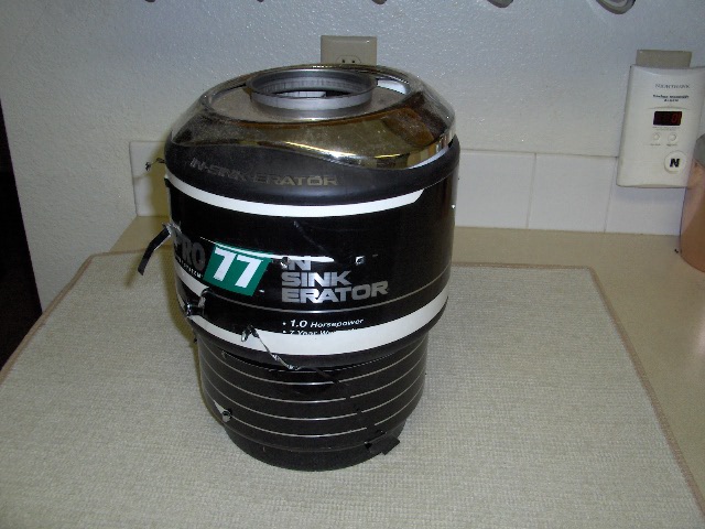

This is where the Garbogen starts. This is a very rare 1 HP, 10.2 amp I found dumpster diving.

Nice the Idea of having the inner outer race retainer fit snug in the motor can works

Yes I still have blades ($20 each). I can build a PMA only.
With the new solid steel armature, new 3/4" shaft, new end caps, no rectifiers and 4 wires coming out of the can ($175 each).
At this price you may be inspired to build your own?
I think I should work up a parts price list for all the special parts that make up a Garbogen. Then you could just buy what parts you can't make yourself?
The magnets will be hard to find unless NTL still has some available?
Today after checking clearences I've noticed I'll have to recess 4 of the mounting screws that hold the aluminum stop plate to the comp/wood.
This will make clearance for the end caps to just fit snug. If the screws are not shortend and sunk into the comp/wood they will dig into the coils.
With these new end caps the doides no longer will fit inside the motor can. So a heatsink just outside the can or 4 wire down the tower.
