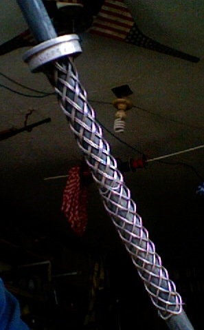

On the subject of supporting the wieght of the cable down the tower, the best thing to use (which is used in the industrial electrical field) is a "Kellems Grip".     It is designed like a chinese finger lock with a hanging loop. The harder the cable is pulled the more it grips around the entire circumferance of the cable. It is used alot with hanging multiconductor SOW cords or power drops to machinery.

Sparky;
And this is what mine look like:
« Last Edit: April 07, 2008, 08:36:34 AM by TomW »

tom, i didn't know what they were called. thank's

Re: tower building
« Reply #18 on: April 12, 2008, 07:09:37 PM »
The type I have are perfect for tower downleads. Just bore the top "cap" of the yaw tube on the head to fit that smaller diameter of the round part to fit in it. I have an industrial salvage and surplus place nearby they have lots of cool parts.
