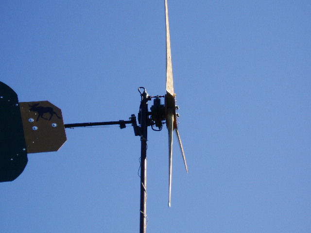

Hello to All.

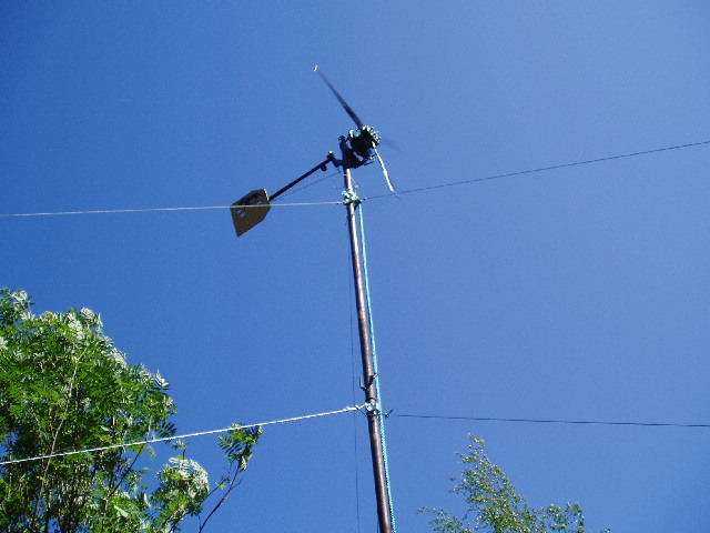

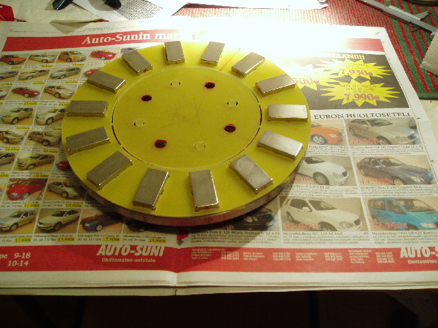

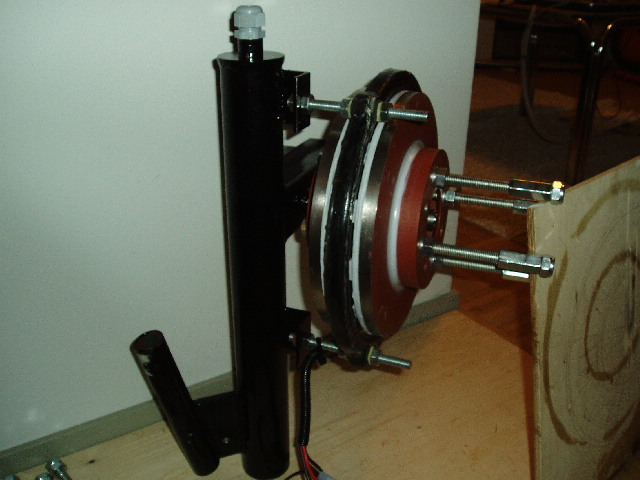

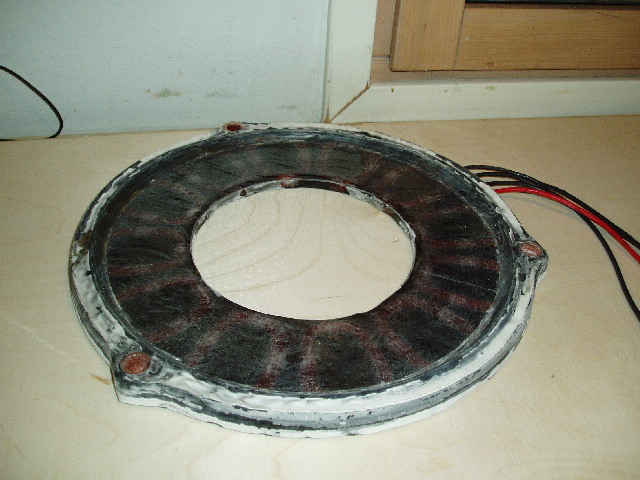

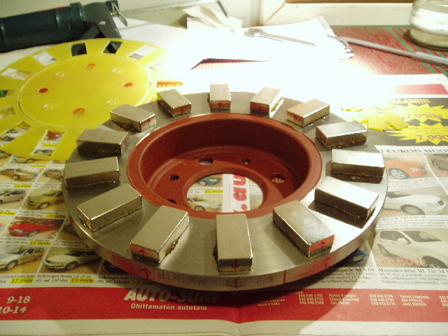

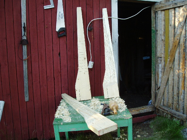

This is my first post and here are some pictures of my first windmill project.

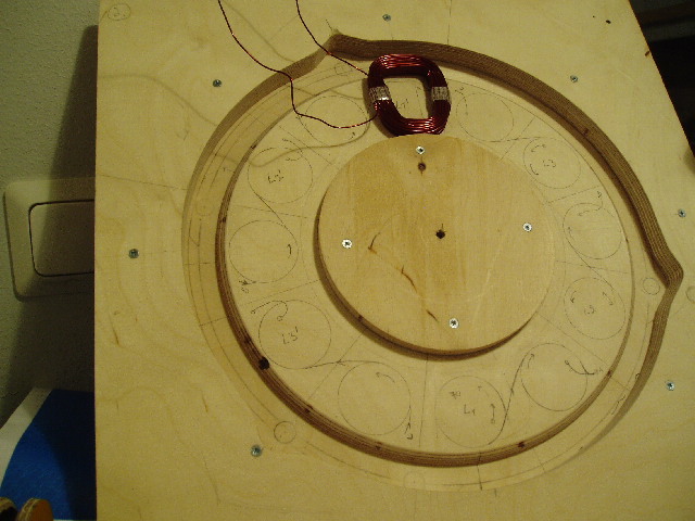

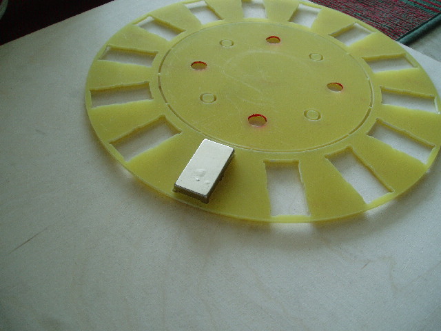

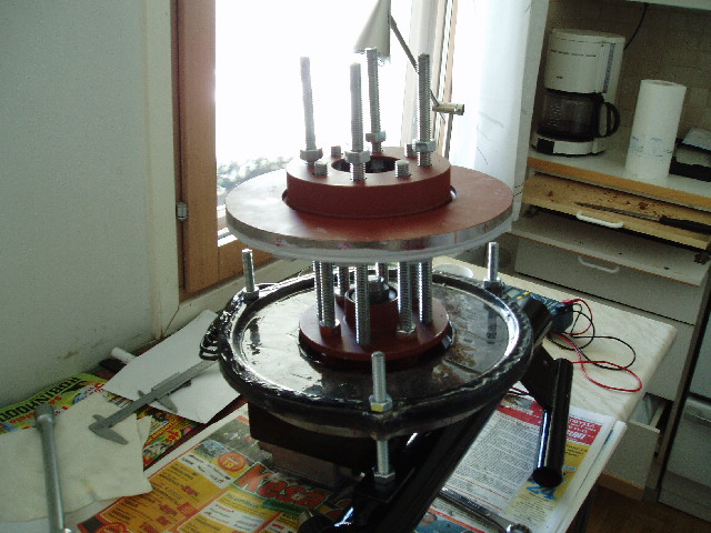

It,s 3 phase 10" brake disc alternator with 12 coils and 14 magnets.
I have 60 turns of 18 AWG in coils and 4 coil in series.
I use little different winding style than usually seen in here and I get 12 open DC volts in 60 rpm.s.
Any comments are more than welcome.

Looks like  great work down to the carved blades and everything.
I don't understand the 14 / 12 three phase setup though.
I only see 2 magnets lining up with a coil at any given time. I would have thought it would need to be 7 phase. But then I have a lot to learn.

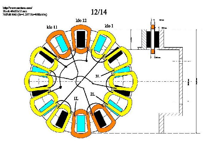

 Clockwise Counter Clockwise winding.

I'ts very nicely done, thank you for sharing pics.  I do have doubts about how you've wired it.  For one, I think the cutin speed (60 rpm  assuming its for a 12V system) is way too low and that will hurt you, I wonder if it will ever get out of stall.  Secondly - with 18 gage wire the resistance is very high and I worry that because of that, and the cutin speed you'll get very little from it and it might overheat.
I don't see the sense in the 14 magnet/12 coil arrangment...
I wonder what the diameter of the blades is?  At any rate -  even if it still requires a bit of work you've built a good machine and it's not too far out!

It is Clockwise Counter Clockwise winding just like in picture.

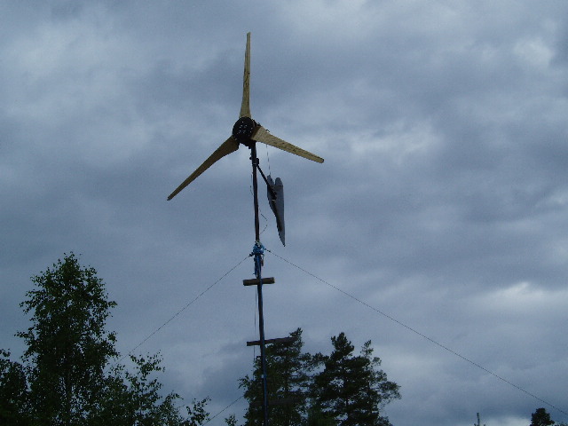

The blades are 9 foot diameter and I had little overheat problem but now I am working on mppt system witch hopefully allows it run faster.
I measured 10 Amps in high wind but it seem to be to much to the coils.
Sorry my spelling I,m from Finland.

I agree with dan that your cut in is desperately low for 12v, it will work much better at 24v and even then it is slow.
I doubt that you gain anything at all by using 4 extra magnets with that strange setup.
For 12 coils you will be better off with 16 poles not 14. At least it does work ( some of the odd combinations are very poor).
Yes if you can get the mppt to work then you will overcome your stall and heating problems.

Looks to me like that winding puts the current through more copper than necessary, resulting in higher I2R losses.
Another way to look at is is that you're summing two voltages at a 30 degree phase angle.  Assuming a sine wave you'd be losing about 7% of the voltage (and thus the power at a given current) that you could have gotten from the same amount of copper and magnets in the same coil arrangement, but with twice as many turns of half-the-cross-section wire, connected in a 6-phase system.  (The actual amount would depend on the waveshape, of course.  Perhaps this arrangement would make for a sufficiently flat-topped waveform that you'd do as well, or even better than, the more traditional setup.  But at first cut I'm inclined to doubt it.)
Regardless, I'd expect that adding more magnets in the more traditional style would have more copper under poles, raising the voltage and improving the ratio of power out to stator heating.
I'd love to hear your EE friend describe the logic behind his recommendations.  Could you get him to compose an explanation of what he was trying for?

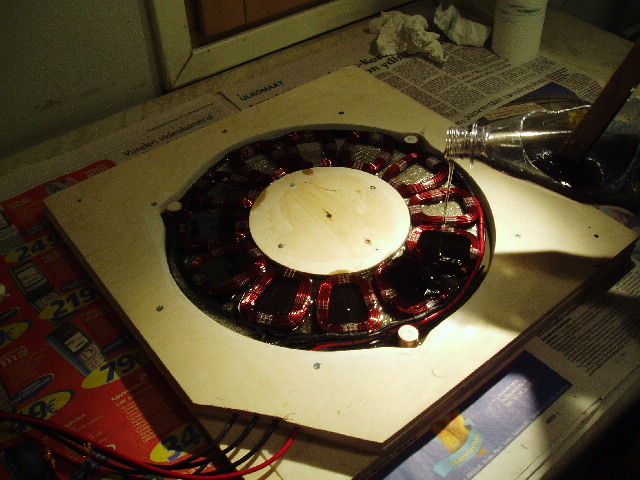

I updated that first picture little bit to make it more clear how the windings are made.
There is a star point and I even have a wire out of it.
« Last Edit: April 12, 2008, 02:24:53 AM by wellery »
Re: Windmill project
« Reply #13 on: April 12, 2008, 03:50:43 AM »
Thanks, that's easier to understand.
Now that you have buried the star point inside the potting you can't connect it as Jerry suggested.
« Last Edit: April 12, 2008, 03:50:43 AM by Flux »
