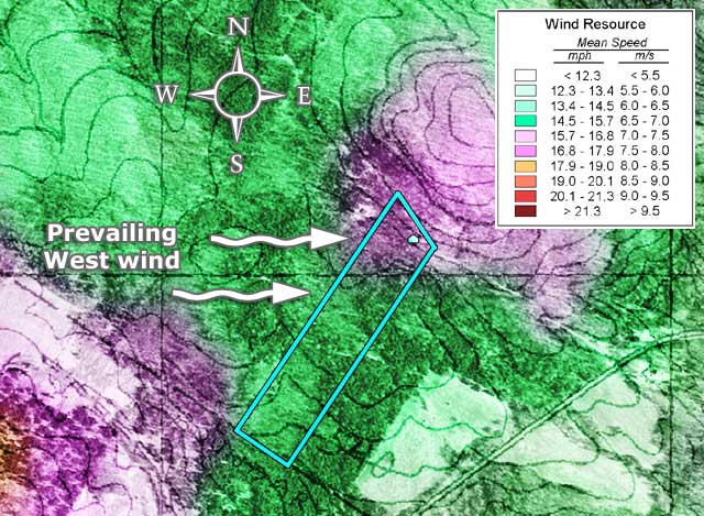

  In January I hooked up a "Watt's Up" meter to my Air-X to see what kind of power it was actually putting out.  I have the Air-X (12v) mounted on the peak of the camp roof, about 5' above it.  The metering took place over a three month period, from 01-08-08 to 04-08-08.
  Current Voltage:   13.6 volts
  Minimum Voltage:   12.3 volts
    Peak Amperage:   31.3 amps
     Peak Wattage:  506.9 watts
        Amp-Hours:   62.4 Ah
       Watt-Hours: 2793.0 Wh
  Guessing from these figures, the wind blows hard, but not for long periods of time?  Placement of the Air-X is probably an issue as well.
  The wind map for the site shows that I sure be getting an average wind speed of 16.8 to 17.9 mph. Not very useful winds if they're aren't steady enough!  I wonder if there is any means of setting up my system to take better advantage of the wind on my site?

I suspect you are seeing winds much lower than those predicted figures.
The AirX will not be very impressive, its total crap in low winds and I doubt that it runs below 10mph, but even in a 12 mph average wind area you should have some useful winds up in the region where it ought to be going quite well.
When you get average winds in the 17mph region the thing ought to be performing well.
Local site conditions can seriously alter the wind speed, taking figures from national resources or even from the local airport may be almost meaningless.
You might not be able to change the wind conditions, although a bit of extra height may work wonders. You can cure the other problem, virtually anything will beat an AirX.

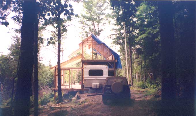

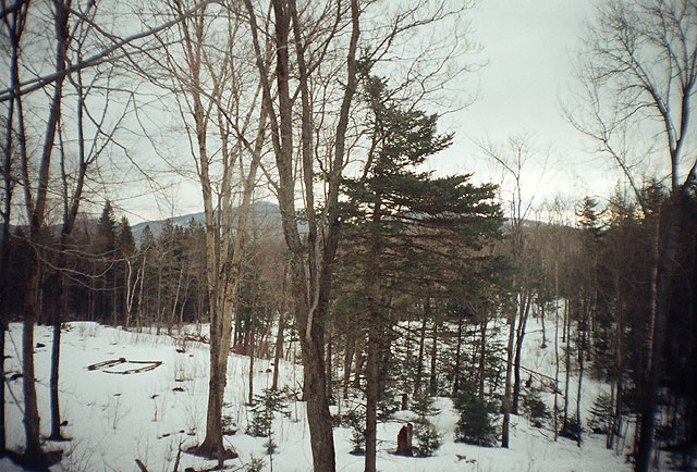

  There a lot wind up there!!  I've repair the tin on the west side of the roof twice in the three years the camp has been there.  The winds I see are very close to the winds shown in the two links that follow:
http://truewind.teamcamelot.com/bin/TrueWind.dll?WindRose?Rec=1311&Area=NE
http://truewind.teamcamelot.com/bin/TrueWind.dll?DetailSheet?Area=NE&X=250&Y=4950&Z=50&a
mp;Map=?176,424
  The picture below (old photo) is looking west and as can see, beyond the camp there is not much in the way.
  This picture below is looking SSE and yes, I still need to clear a few trees.
  One thing that would help the Air-X is to add some tail to it.  The tail is so short that the blades starve it of wind, thus allowing it to turn out of the wind.  I'll do an add on to the tail and put it higher to see what difference that makes.

 Your going to need to get it up higher with all your trees. I have that problem too. I think your going to need to be higher than fifty also.  If your tallest tree is 70' you need to be up around 100'. It's hard to get up that high though
« Last Edit: April 19, 2008, 08:57:01 PM by jmk »

 One good thing is, the lot owners around me have been harvesting timber for the past year. If I wait long enough, and cut the tallest of the trees on my lot, I should be fine with a 60' to 70' tower.
  If I go up 100', I'll have to deal with the state, because of the elevation it would need to be lighted. I really DON'T want to get the state involved it my project, if at all possible.
