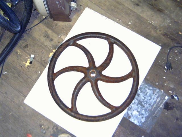

i've been thinking of going with both a big radial and a v belt overdrive.
my friendly machinist gave me a sweet 18" wheel.
old timey steam control valve from from a big lake boat.
he cut a v into it.
1" shaft.
i think i need to add a dual rotor radial to the bottom side

i think i can get him to add an "n" shaped channel on the bottom big enough for 24 poles using 1x2x.5's
and still run the v belt to another alternator.
it will need to be dual rotor to compete with that brute your building.
decisions! decisions!

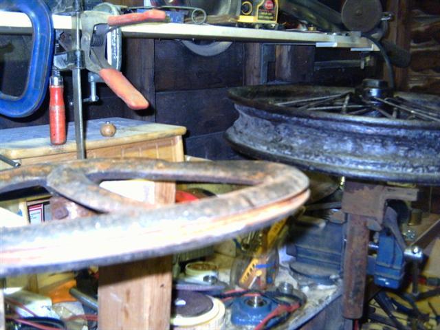

pay no attention to the world war2 ammunition carrier wheel in the back ground.

 The 18in wheel could be 36pls.with the 1x2s.
 Why? is the ammo carrier top secret? :v)

the wheel's not secret.
 it's just part of the mess that my shop has become.
when it gets below -10c degrees i don't spend a lot of time in there.
now that the warm weather is here i can clean it up !!
36 1"poles on an 18" wheel is kind of tight mag spacing.
« Last Edit: April 23, 2008, 07:20:15 AM by electrondady1 »

Hey that looks like all of my work surfaces!
No matter how many shelves and storage units I put up in my garage and workshop it seems that I tend to store 'stuff' on all my worksurfaces, leaving me little surface to actually work with. Each time I want to do something I have to clean off my worksurface...
