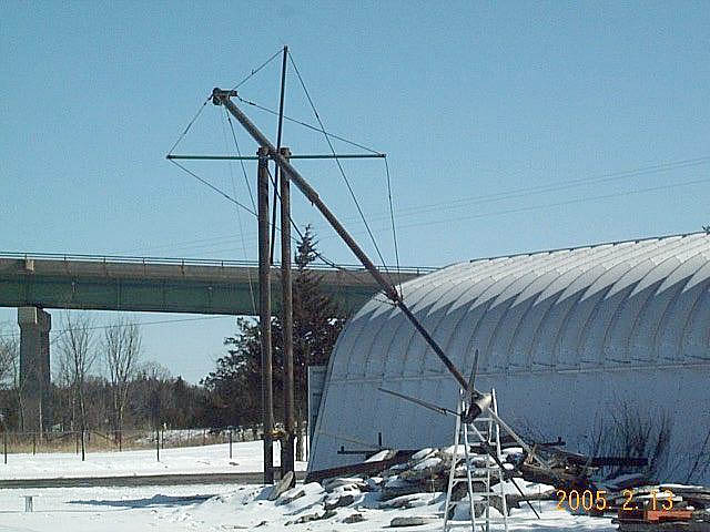

Hey guys, I got the permit to build a 10' genny next to my house.  It'll sit about 10 feet above my house (about 30 feet in the air).  It's the best location considering the circumstances, and there's actually quite a bit of wind at that level.
I've been trying to scrounge up an old (water pumping type) Windmill tower, but I got to thinking about how big its footprint would have to be.
I came up with this idea of a tower using 6 x 6's or some kind of similar square lumber.  Of course, this is an exploded view.  The two outer pieces are cemented into the ground.  The middle piece fits snugly between the outer ones.  That keeps it from rotating.  Also supporting it would be 3 large bolts or metal rods of some type.  I chose 3 because you could space them out over several feet.
The main advantage of this type of system would be that, if you remove 2 of the rods, I would have a pivot point that I could use to lean the middle piece against the roof of the house for maintenance.  Also, depending on the weight of the finished mill, I could easily mount it to the top of the middle board.  A 6 x 6 square wood platform should be big enough for a large floor flange or similar to support a vertical pole for mounting.
I'm pretty sure that I'm not doing anything unusual here.  Something tells me that I've seen this concept before.
What do you guys think?

somebody on here did this design on a large scale using telephone poles.

i have seen a tilt up tower done like that with telephone poles with a counterweight on the short side of the tilting section to help in tilting up and down but it was still guyed once tilted up..... do a Google search of tho board for telephone pole tower....

FrankG from "www.theworkshop.ca" had posted a photo of one like that in the past here, and I had seen photos of pole mounted ones before that, although in all cases I saw the swept area was less than 10 feet in diameter if I recall correctly.  Rich

I would point out that a 30 foot unguyed tower makes for a large lever, the tower base would have to be substantial I would think, also 30 feet is a lot of gravitational potential energy for 200 pounds of material should it come loose above your house or car.  I happen to know that even a small wind turbine at 25 feet can put parts through a car windshield.  Rich

I am a fan of tilt-over tower, but mine will be guyed.
Saw this free standing 65 footer in action:
The two 30 foot base pipes are 10 feet in the ground, so pivot point is 20 feet up.
It was counterbalanced at the base with a billet shoved inside the bottom 6" pipe.
A boat winch cranked it up and down in about three minutes ...my wife could handle it!
Also saw a guyed 60 foot Rohn lattice tower with similar tilting mechanism.
I have the engineering print and some pics if anyone is interested:

Thanks guys!  Those are exactly what I'm talking about - except I am finding that the square lumber is easier to come by.  But that's not a functional difference, except like I said, square ones would help prevent rotating.  Don't know how big of a deal that really would be.

The 10' mill is too big for what you propose as a tower.
Strength aside, it will sway all over the place.
Even with guy wires, the middle section will move from side to side in strong winds.
The bending moments applied by wind gusts and abrupt yawing (it's a big gyroscope) will snap 6" lumber.

Good point.  I think I'll have to use 1 solid pole.  They make them up to 25'.  Or I'll have to look into something completely different, like someone mentioned building one out of scrap steel.  Welding can't be THAT hard.  ;-)  Remind me that I said that when you visit me in the hospital.
