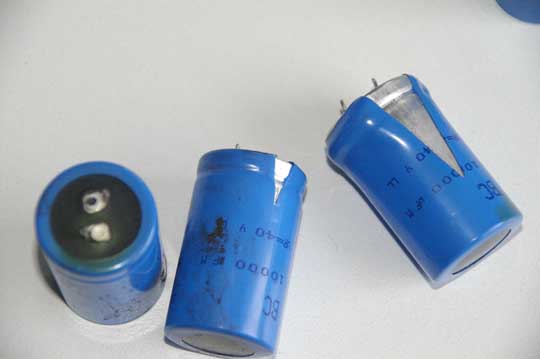

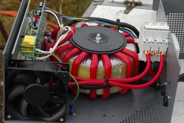

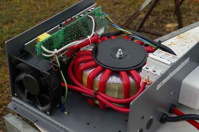

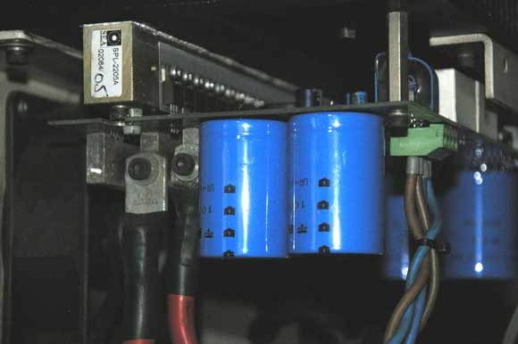

At first light I opened up my Solar Energy Australia (SEA) inverter, only imediatly aparant fault was the 10000uf/40v capacitors.
Ho Hum, just starting my winter fruit season, it's Saturday morning, weighed up the alternatives and headed for Perth (capital of my state) 2 hour drive to purchase a new unit.

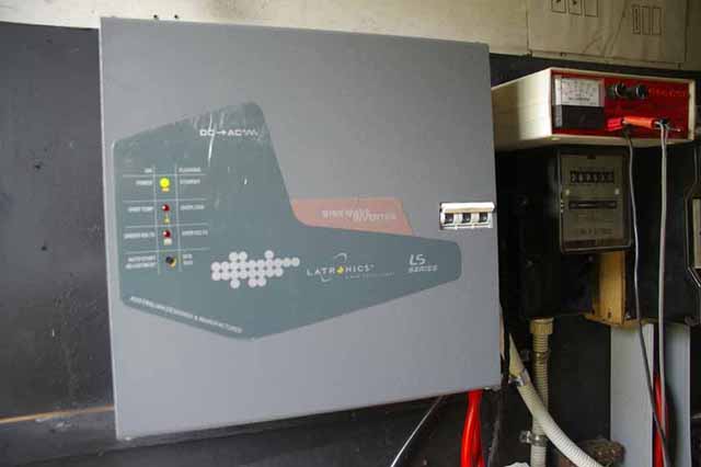

Only one business was open on Saturday, business is so good others don't need to. Placed my hand deeep into my pocket for a new 3Kw Latronics sine wave inverter, these are Australian made quality units.
Pleased to say power was back on by around 4PM and even better the fridge showed no signs of defrosting after 13 hours of not running, this was very fortunate as the grog was still cold.

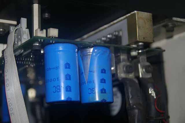

I have ordered 4 new capacitors for the SEA inverter, this is where I suspect the fault lies based on the apperance of the one on the right of the pic it looks to have overheated to me, and the fact that full 240 volts (asumption) was briefly attained each time the inverter rebooted. Worth a punt anyway, even if it has to go to inverter hospital after 5 years service it's probally time to change these electros anyway.

If replacing those caps, I would add an additional two to four more.  All caps have an ESR that can result in heating.  A cap rated at 85C will only last a couple years if used full time.  External caps at the input terminals will work just as well.

Replaced the 4x 10,000uF 40v capacitors with 10,000uF 63V ones, powered it up and all seemed well, tried increasing loads all is very well, they show all signes of overheating.
Magic smoke had escaped from two of the capacitors
Since the replacements were physically larger(higher voltage) they just fit.
I haven't returned it to full service yet but am confident all is well.
