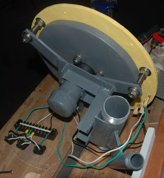

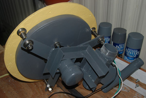

After a lot of help from the board, I am finally putting my first windturbine together.
The one I made with a ametek motor does not really count.
This one was a lot more challenging.
Here are some picture I took on May 18th.
You can see the completed alternator, the frame that holds it together, and in the last image, you can also see the bridge rectifier.
(Please, be kind, it is my first welding job)

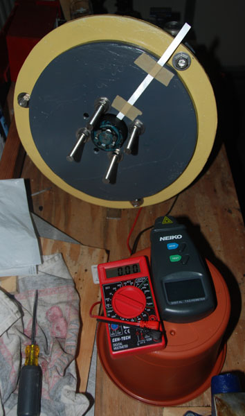

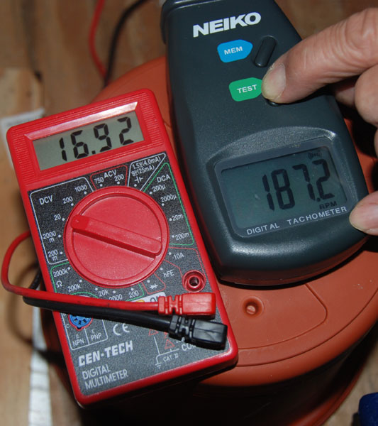

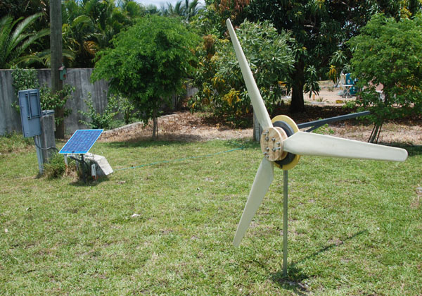

The next step was to test what the voltage / RPM relationship is.
Here is the test set-up
I will add a chart of voltage versus RPM later.

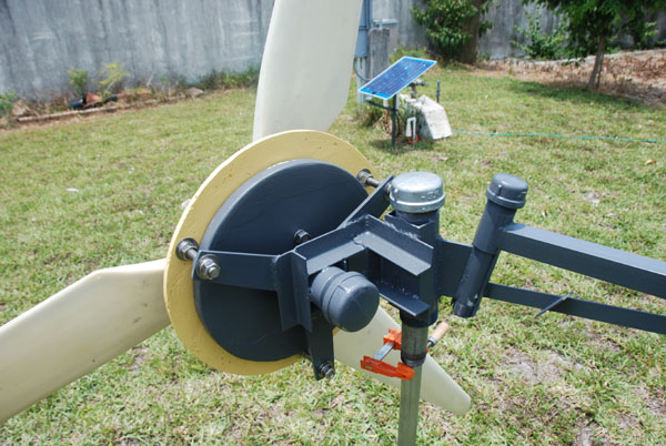

The props are attached with temporary wooden discs because I do not have the ability to fabricate them out of metal. I will replace those hopefully soon with stronger material.
The tail-frame has also been attached.
The tail will hopefully furl.

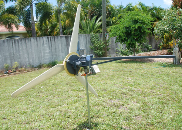

The next steps are still somewhat in Limbo because I am getting afraid to actually fly this beast. I am in the middle of a city and am getting cold feet about hurting someone or causing damage to property. I'm also not sure if the tower for the first Ametek windturbine is sufficient to carry this one.
I definitely need to do some more thinking and checking.
Any comments are greatly appreciated.

Nice job!  As far as I can tell, no need to "be kind" about how it looks... it looks great from here.  Way better job than I would do.
I see you've elected for the Cadillac of DMMs.  Kidding of course.  Hard to beat for $2.99.  I've got 5 of them myself.
You've got some solar, too.  They work great together from what I've experienced.  Currently all of my wind power comes from an Ametek.  I certainly count mine as a "Real" one!  It is real enough to power this very Internet connection!

I really enjoyed seeing the use of bed frame and plumbing parts, I'd like to know more about the blades you have in the pics.

I think you are quite right to be concerned about flying it 'as built'. I personally would take steps to use various locking straps or wires etc bent over the flats of the bolts to restrain them and avoid the nuts and bolts coming loose and dropping off the machine. Similarly, drilling a wire through the flats of the nuts and/or bolts and wiring them together achieves the same result.This is common on aero engines and other equipment where failure is not an option. The decision is of course your own, but these minor saftey features should be sufficient to fly it without too much worry.
I am sure other can offer similar encouragement.

If you are in an urban area you may never be able to get it up high enough to be in clean air. Trying for a tower high enough would probably be silly, risky and not likely to please the neighbours. just try to get it into the cleanest air within your capability if you can find a gap for certain wind conditions use that even if it is not the highest point.
Make sure the tower is strong enough and nothing is within the fall area. Unless you try for crazy height, tower failure should be avoidable.
Run it in on a low tower to sort out all the bugs and to make sure you can get it to furl or stop on a brake switch. If you can control it you should be ok.
It's a good idea to make sure bolts stay tight but if tightened properly there should be no problem. Loctite is a wise precaution, use tabs or wire if you must but they should only be a backup.
The biggest danger is shedding a blade, it looks as though you have fibreglass blades so be very careful with the root mounting. The wooden hub may be perfectly ok but I have no idea what the blade ends are like. That is the one area that would bother me more than anything else but if they are mounted well and you can avoid overspeed then there should be no problem.

 if you want comments .then here are a few.
  you have done very well.
  marks out of ten. TEN.
  the gray paint looks great. i also used gray on the metal rotor.
  you must be very happy with the work you done.
  when i finished a single rotor i was building i wanted to test it in the wind.
  and i had no tower to put it on.  so i fixed it at ground level.
  just to play with it.
  it was the most dangerous thing i could have done.
  i was lucky i had made up a brake switch .
  but that prop at ground level . sum one walking into it in the dark or bye mistake.
  so i tied a rope round the blades to stop it flying when i wasent about .
 one night i was going to bed and looked out the bedroom window and saw the prop flying.  the rope had come undone .it was only loosely tied  .
   i think the work you have done is very good and the mill looks great.
  you just got to trust yourself a bit more.

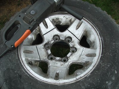

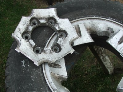

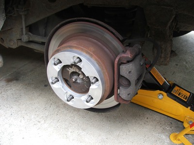

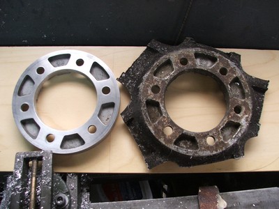

   if that is a auto hub or trailer hub you have used .  then if you can find
 a alloy wheel  or a steel wheel. then cut out the bit in the center of the wheel.
  it will make a good hub boss.
  you might need a grinder to finish it off .
  all the holes will match up. and you can still see the bearing nut.
  dont forget your brake switch.
  and try it at 20foot just to get going.

I like the bed frame angle also it's very hard steel and a little hard to cut Lots of carbon in there . Very well done I have to say the spade lugs are not a good idea .They will be gone in a very short time in the weather and the head moving in the wind .What you can do with them is solder the lug to the spade remove the crimp insulator and solder there as well and then apply polyurethane caulk to insulate . Your presentation model should work on those hand gestures if she want to get professional work (she's a cute y )

Really good work!! If that was your first welding project, you certainly
did a lot better than I did on my first project.
I really like the presentation model!!! What a cutey!!

My cadillac DMM is only one in a collection of DMM's. The other ones all have dead batteries. One of them is probably worth almost $10.00 ;)

The blades are the Chinese ebay blades. (6.8ft)
Not sure yet how they perform.
I will post results as soon as I have some.

I'm not exactly sure yet what you mean with 'bent over the flats of the bolts' or 'drilling a wire through the flats', but I will find out and implement it.
At the moment, the turbine is only ready for a test stand, not a tower yet. I was planning on adding more security, but had not figured out how to do it yet. I will seriously consider your suggestion. Thanks.
Zenpi314

I would like to personally thank you for all the helpful information you have given to this board and to me in particular. Very much appreciated.
The tower is going to be very low. Somewhere between 20-25 ft. It will just be peeking over the roof of my house.
As for a clear fall area, that will be very tough. But it is going to be my house that will take the fall, not someone elses property.
I'm planning on locking the bolts better but have not made a decision yet on how.
I am extremely worried about a blade failure. That is probably the only way I can endanger other people and their property. I guess that I should make sure that I have full control over the rotation speed as you mentioned. It is made to furl, but that needs to be tested (in a realworld situation I'm afraid). I will also include a switch to short the alternator, but I have not tested yet if that will actually stop the prop in high wind.
I'm just starting the process of getting it ready for the tower, and I will not let it fly unsupervised for some time to come.

I wrote this reply and tried to post it, but got a message that I exceeded my allowed post. The reply was lost. So here is take 2.
I think I will try to find a car wheel to attach the prop. Thanks for the advice.

I like the idea of welding, but would also like to keep the option of dismantling it. Could I still undo it after welding? I guess all it needs is a little tack weld.
Everything is stainless steel, except for the bolds holding the prop wedges together. I still need to find replacements for those.

hi zenpi.  looking at your file pics i see what looks like blue discs.
 are thay metal for the china blades?
 i got a few pics for you to look at. im not saying this is what you need do.
 but its just putting a few ideas in photo form.
  as i said if you can get a wheel rim to fit your four studs.
   then maybe you can make a hub boss to hold the blades.
  as you have three blades then look for a wheel with a Evan no of spokes .
  the pics i have posted the wheel has five spokes. no good for a prop.
  but its just a general idea to get you looking at what you can do with a car wheel rim.
    im sure you understand what i mean
   with the carved prop you dont have this problem.
  so tell me what you think about the pics.
  as you can see i was making sum wheel spacers .
  but its much the same thing.
   only you want to leave three bits for you blades.
« Last Edit: May 23, 2008, 05:19:09 PM by blueyonder »

The blue disc are for the chinese blades. They fit nicely, but the center hole is too small and I don't know if I can drill the hub pattern through them. Pretty thick.
I do need to check it out a little more thoroughly, and maybe a local shop can do the drilling.
Thanks for the pictures. I'll be checking out a junkyard.

This is one of the best designs I have seen I'm thinking of duplicating this.
what size are the pipes it looks like 2" pipe and a 1" for the tail?
Also did you cut a hole for the wires to go down the pipe.
